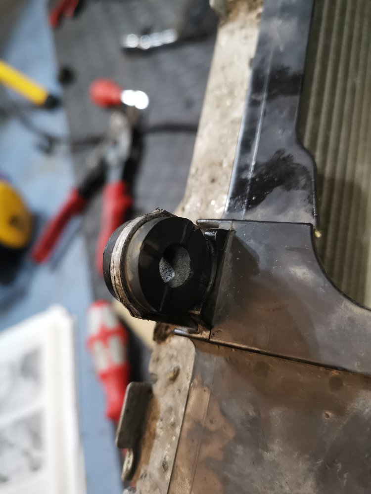

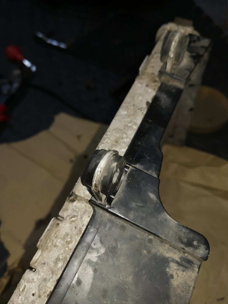

Hi all,
I'm replacing the radiator on the vfr after springing a leak. I need to remove the old gromits to use on the new radiator, and to remove the plastic part underneath them.
Anyone got any bright ideas on how to compress them back through the hole? I did try a hose clip but it keep popping off
View attachment 439405 View attachment 439406
Exactly thatWe've replaced a few VFR radiators now, did it fail at one of the hose joints?.
They seem to collect water around the coolant pipe and rot from the outside in..
