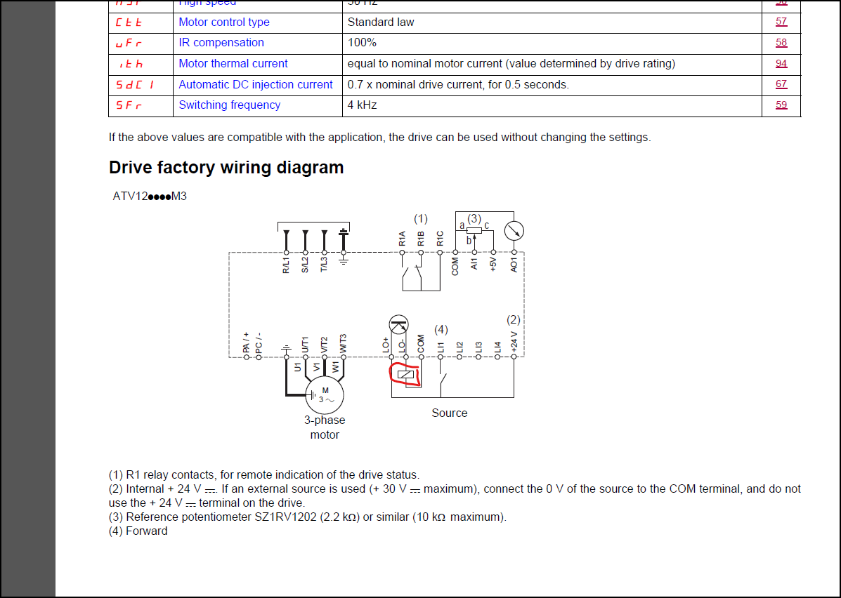

Can anyone tell me what this symbol means on VFD control wiring.
It's a Schneider ATV12 and the user manual is here: https://download.schneider-electric...ile_Name=ATV12_user_manual_EN_BBV28581_05.pdf
This diagram is on page 32
