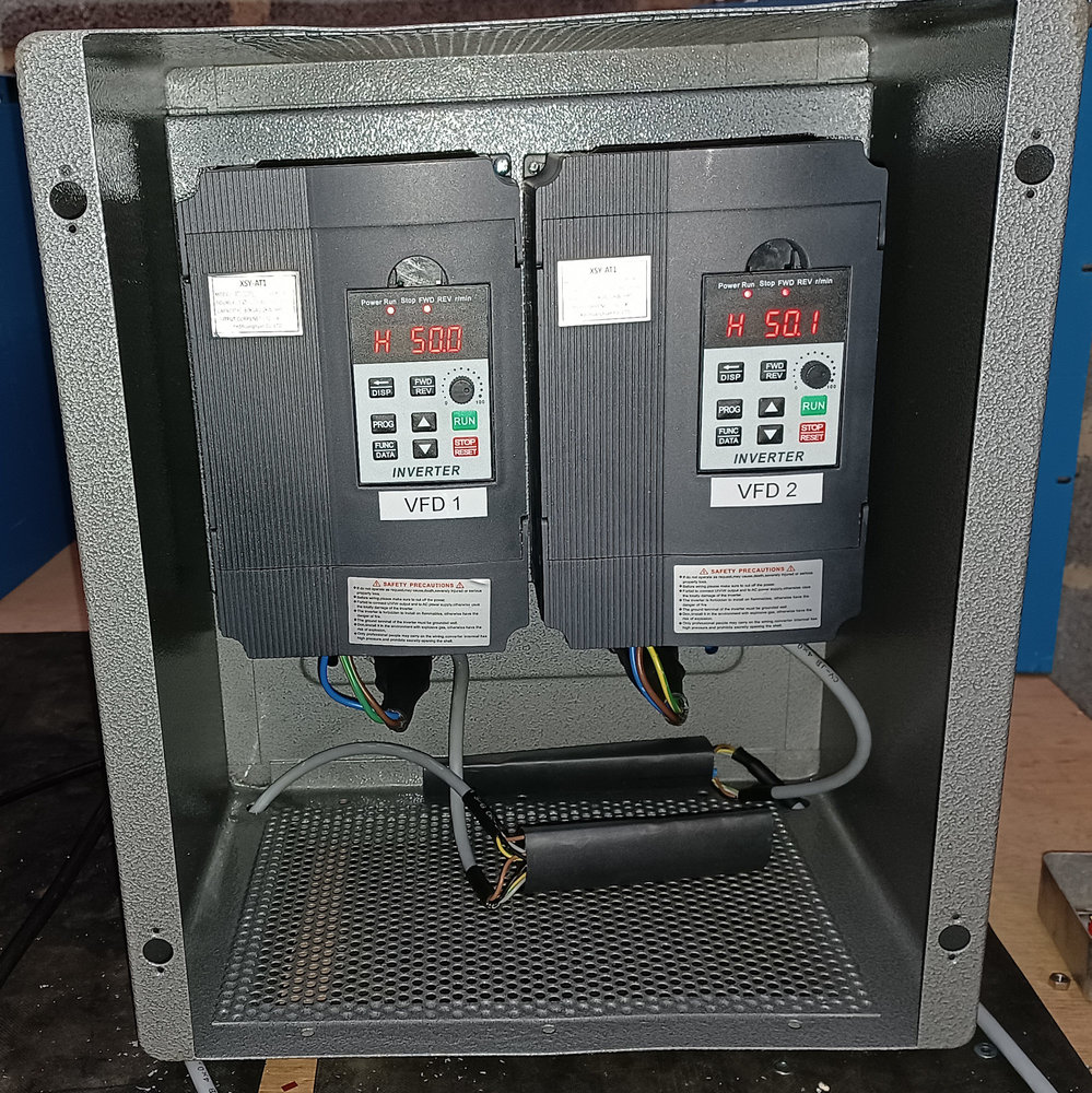

Just a note to type B RCB.
B is also sensitive on DC current which is often generated by SMPS.
If type A kicks out, type B will also do so.
Danfoss drives 28series got the filter as an option. Afaik it can be cut out by removing a screw.
Regulations says that unfiltered devices are only allowed in industrial environments. Forbidden in commercial because it maybe generated high EMI noise which can harm other devices.
if its sat on anything insulated it will run ok sit it on anything metalic thats earthed and it will trip and if your in circuit between earth and case and you will fry
