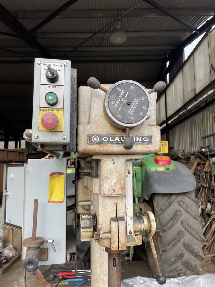

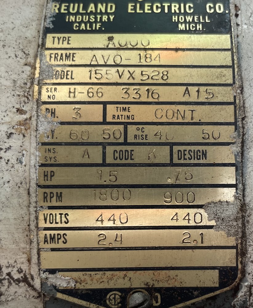

It’s a Dahlander pole-switching motor (2nd in a week on here!):
Dahlander pole changing motor - Wikipedia
en.wikipedia.org

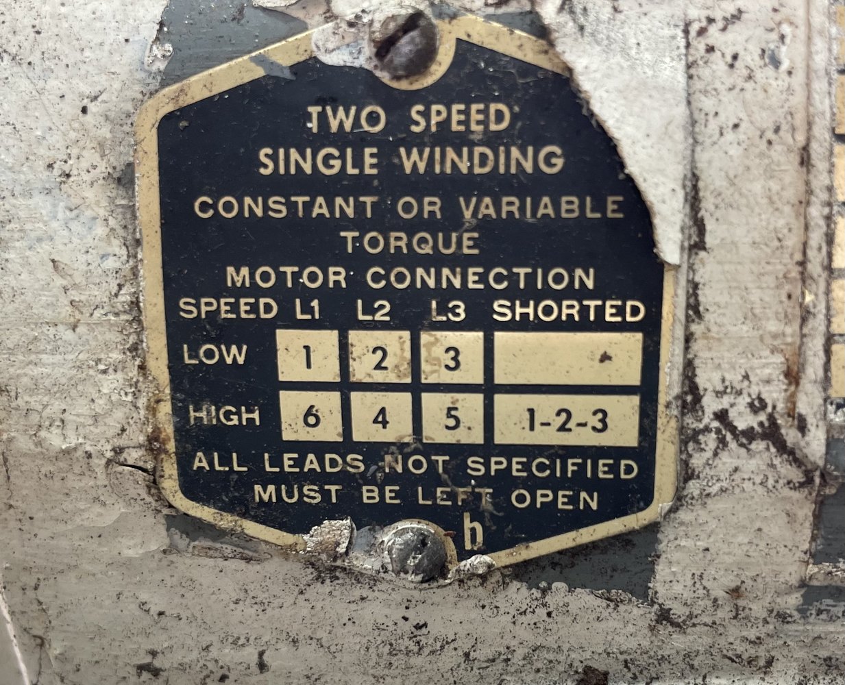

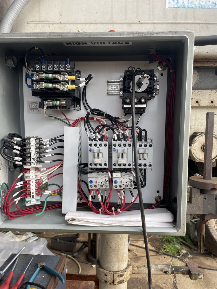

It will need a 400/415V out inverter, which will want to be directly connected to the motor, so you can‘t really use the original pole switching gear. But you don’t need to, because the inverter will give you variable speed anyway.
Speeds quoted are related to a 60Hz supply, so wire motor to VFD as per the high speed specs in your last photo. Configure your VFD frequency limits (see manual) for 60 and 30Hz, so to change speeds you simply rotate the knob on the front all the way left, or right, without having to look at the display. You could even have a remote pot in the original speed switch location.
Original start/stop buttons can be wired into the VFD control inputs.
