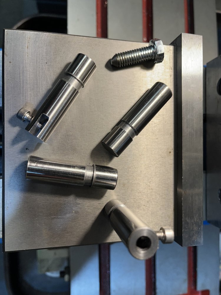

Sorry I should have added " at a sensible price" bit of extra metal, similar labour time. But 9 times more expensive.I am guessing my No3 is a generic larger one than the 1, tooling insert aperture on mine is smidge over 1/2" and all the bolts on it are 5/16 UNC.
I've ordered some 1/2" silver steel round bar to make some tooling / punches, and 5/16 retainer bolts. Saying in case there is a bit of a mix of imperial and metric? on the No 1

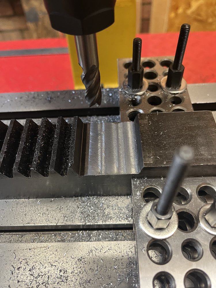

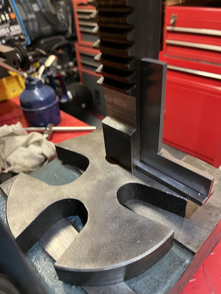

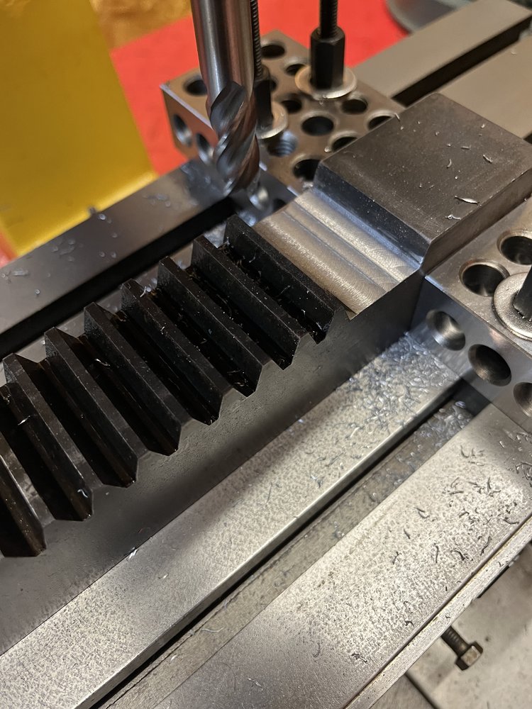

Good one cheersdefinitely looking at that rack mod to do, I don't have that shim plate in mine at the head so might take a look at that although its not that wobbly as a press tool.
