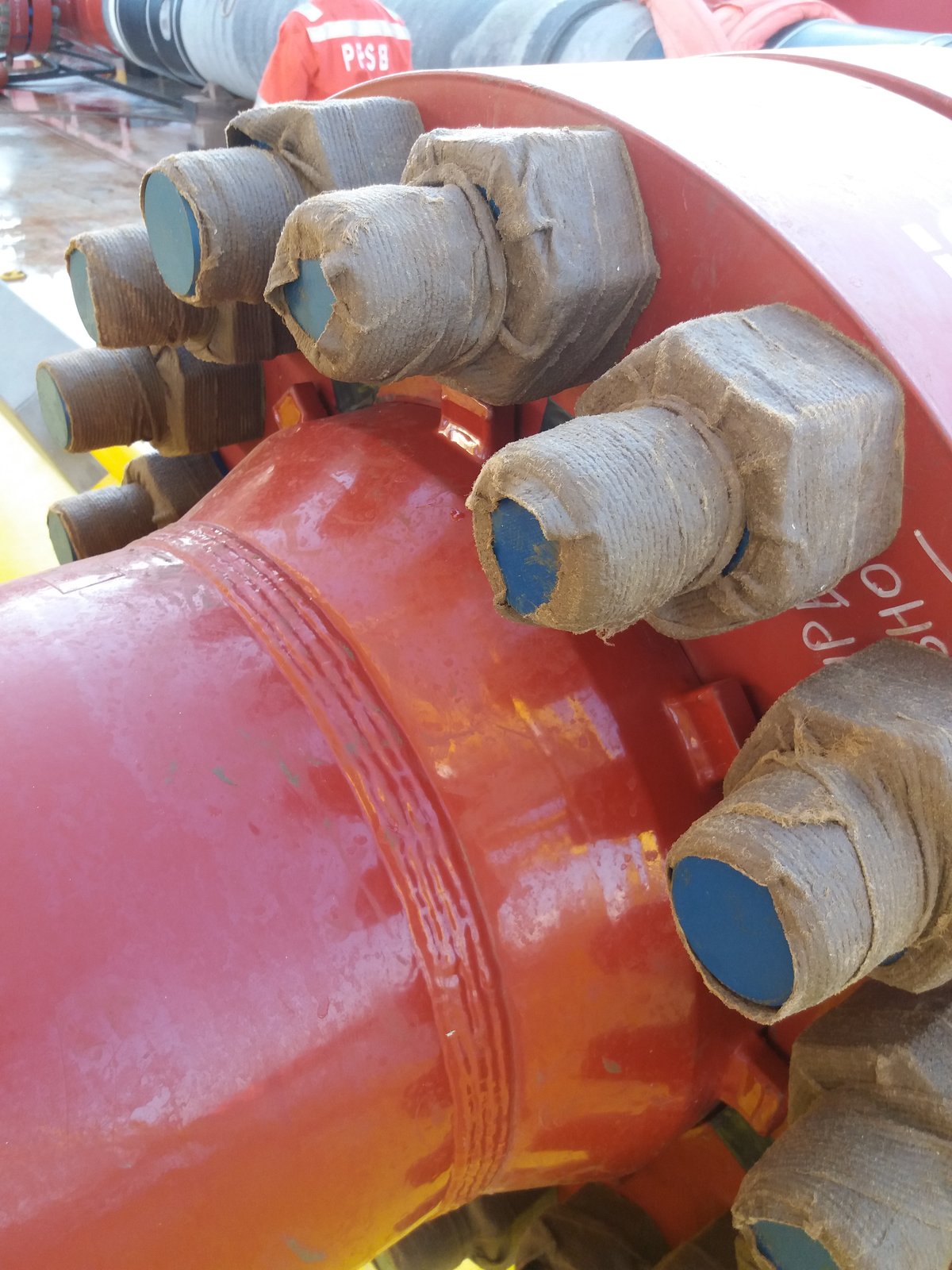

That’s a cracking multi run there Bonser.Lots of good advice on here, i don't like weaving. No weaves on here. Just 7018 Low hydrogen in a heated quiver even though were in Dubai and saudi, at 40 degrees temp the humidity does the damage. This was done by a Miller gold star 602 machine. Keep practicing play with those amps up and down and you will get to what suits you and your machine. That second pass is getting there.View attachment 124873
