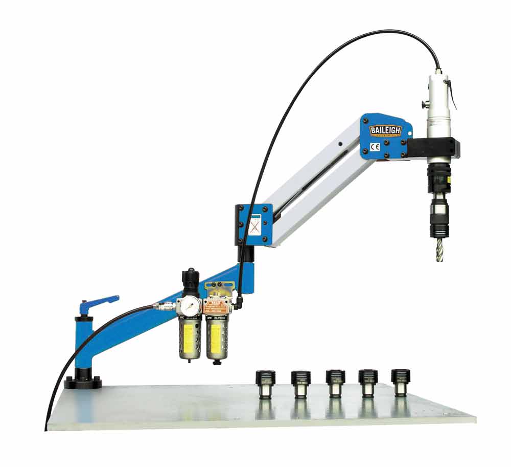

I have used one at a previous employers . It was made by s & l maskin with 3 arms carrying different sized tapping heads. One about 3 to 6 mm the next 6 to 12ish and the largest about 12 to 20mm. Each arm had two parallel linked sections one going up and one down like this https://www.picclickimg.com/00/s/MT...ing-machine-pnuematic-articulated-arm-_57.jpg . If making one keep everything as rigid as possible as the arms tend to bend when tapping due to torque and your threads may end up out of square.
