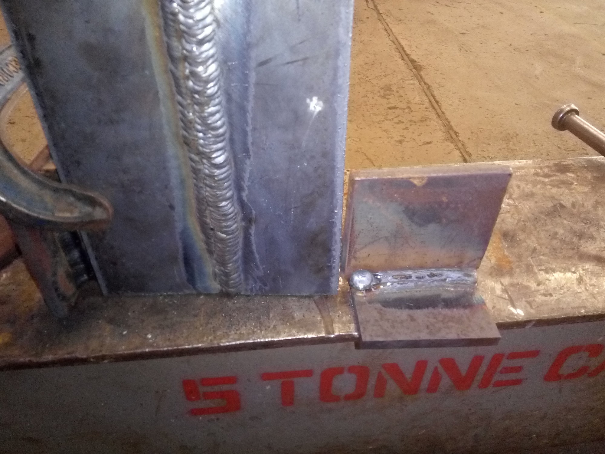

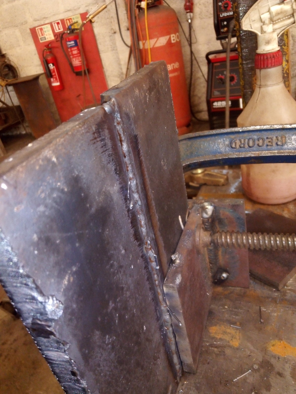

Hey all ran out of work today so thought I practice some skills I don't use one week to the next mig welded short circuit open root 3mm open gas cut bevels 19 volts unsure of amps didn't look to be honest
I think it's okish I am very rusty with position on mig
1st root
2nd back of root

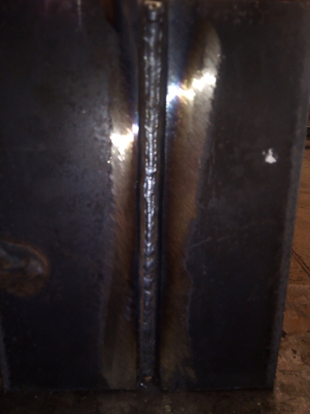

3rd hot pass/ fill pass

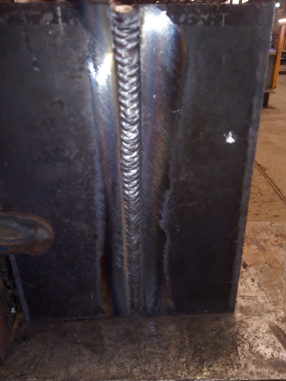

4th caps
Oh 1.2 mm wire Lincoln supra wire
