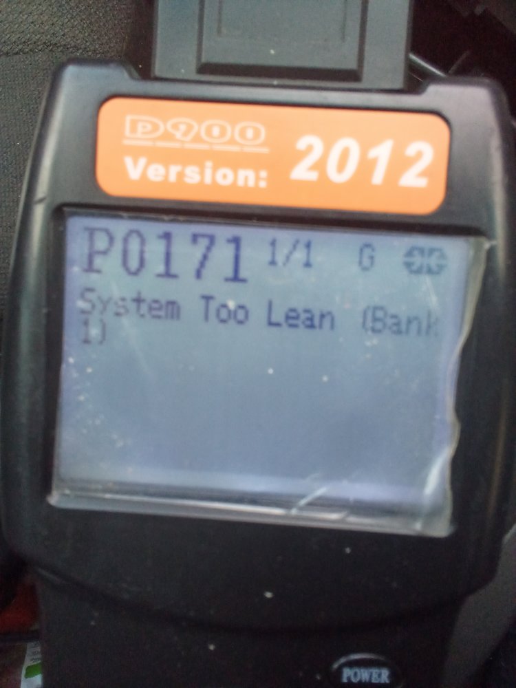

Hi, the wife has a , 58 plate ,Zafira 1.6 . It had a misfire/ hesitation at around, 1800 -2300 rpm . Only fault code stored was for P0171, system too lean , bank 1.
Talked to an ex Vauxhall mechanic. He said coil pack would be issue, as it was a known problem.
Changed the pack. An after market on , from motor factors. Car ran great for a week , now it is back to exactly the same fault.
Are the coil packs that bad and what causes them to fail?
Also if it was misfiring, , would it not put up a code for running rich?
The EGR valve. On the end of the cylinder head has been previously blanked off.
