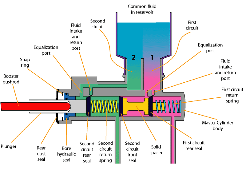

The actual design of master cylinder seals is so fluid does not return into the piston assembly and ABS also. so forcing it back against the cup lips of the seals will not do them any favours at all.Plus iff you open the bleed nipples you can almost push the caliper pistons back with your thumbs which is easier than using G clamps ect....Ive done it this way for over 30 years but i also know guys who dont with almost no ill effects but i just dont like to tempt fate and keep mechanical risks to a minimum.
