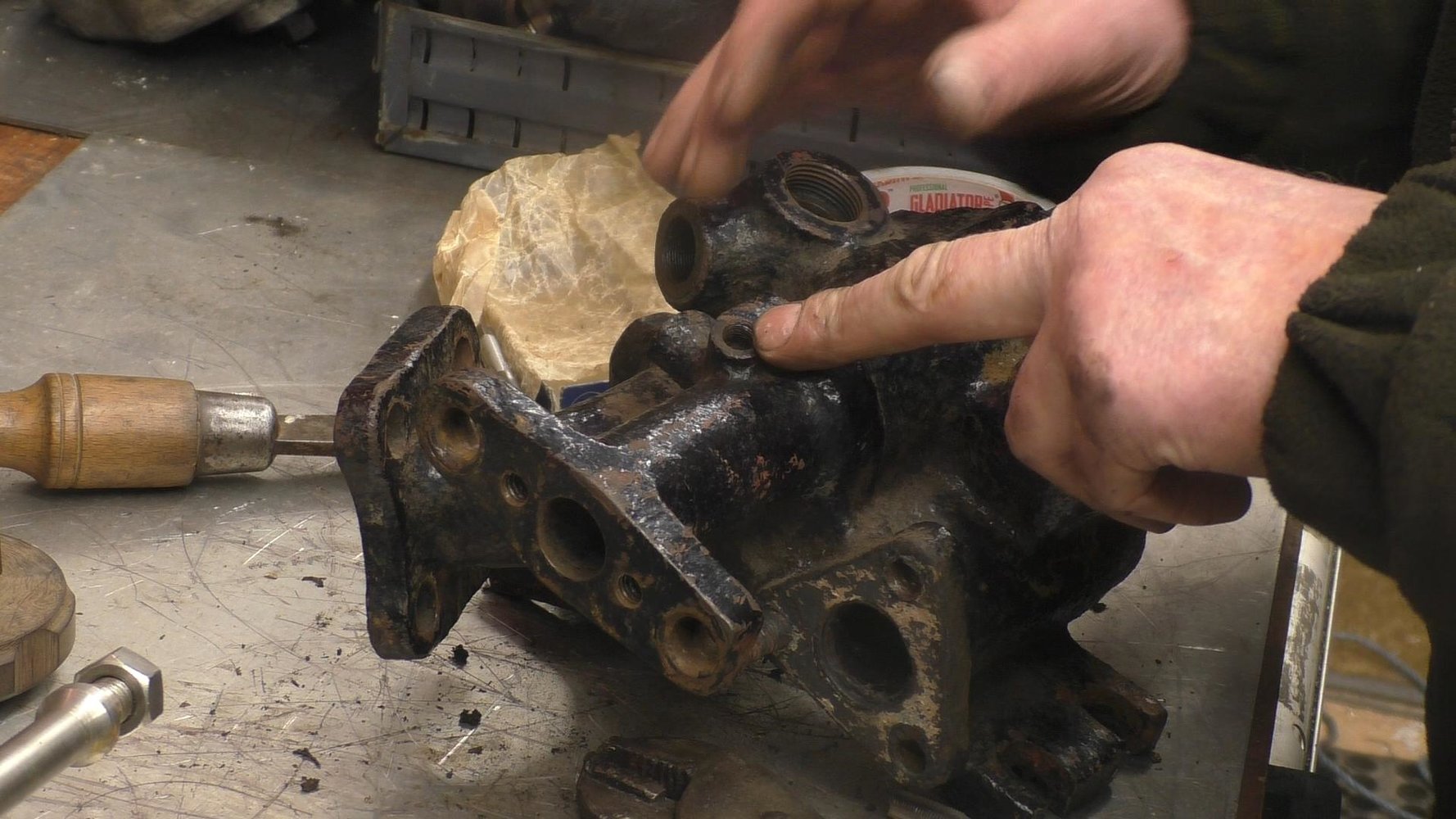

I need this steel casting cleaned.
Would vapour blasting do the job.
It has threads and valve seats that i don't want to damage .
The last 9one i had sand blasted was a real mess
yes the casting in the pictureBlasting is the right process to use, it's a case of using the correct media.
Plastic beads or husks would be idea for that
Edit: Are you on about the casting or your hands![]()
