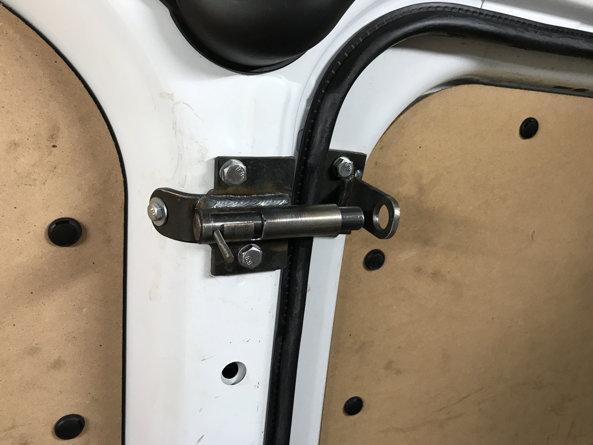

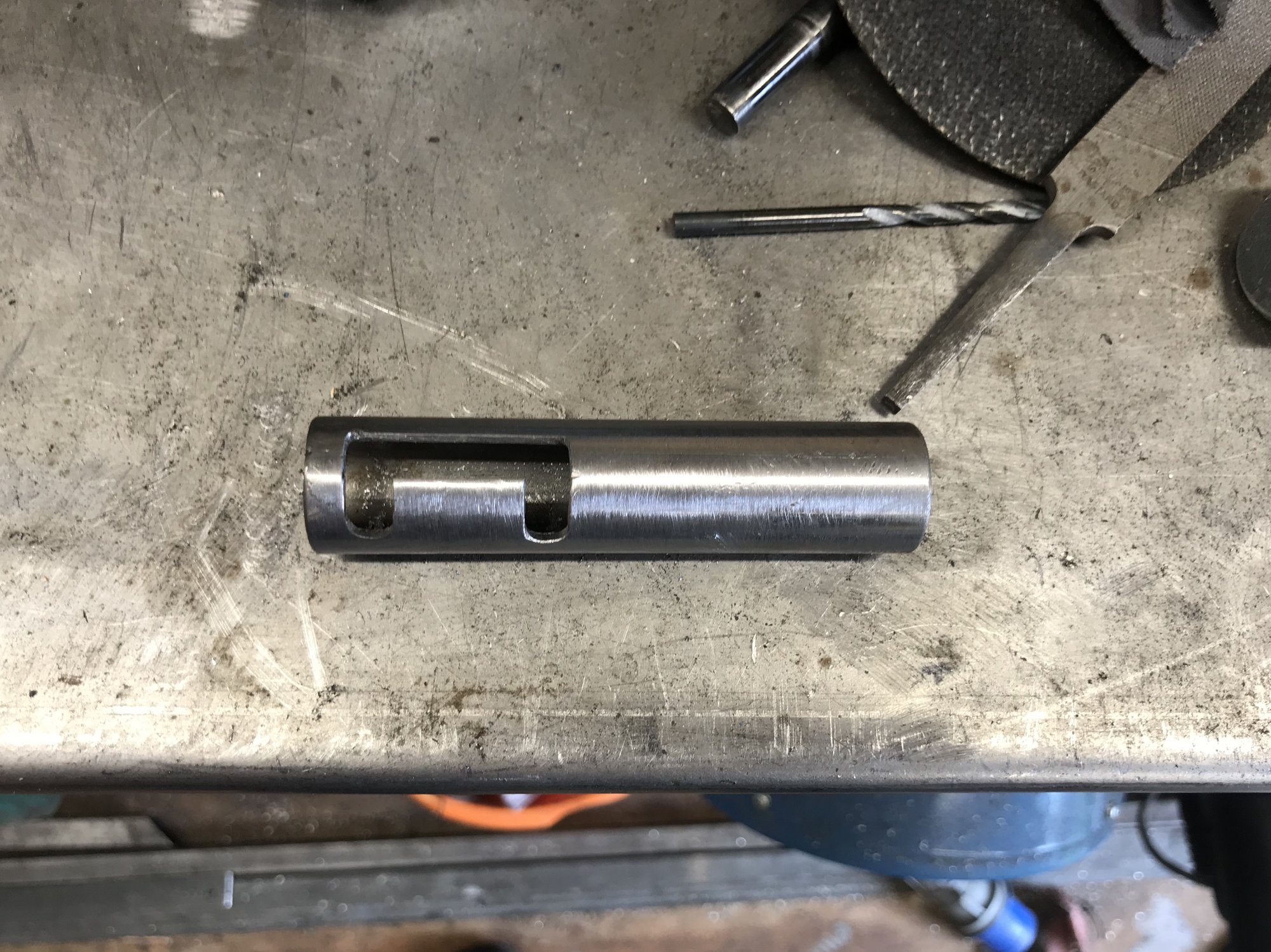

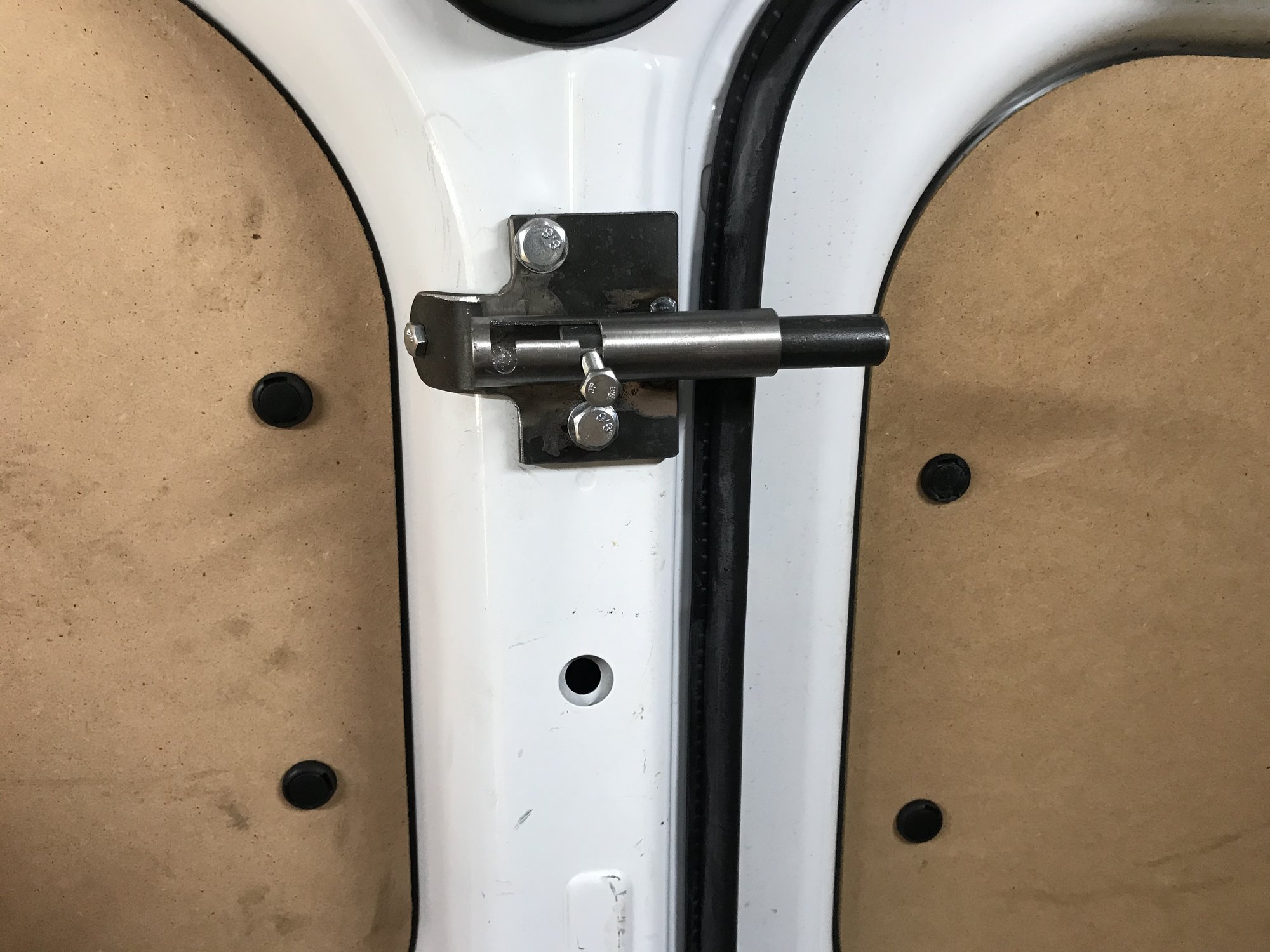

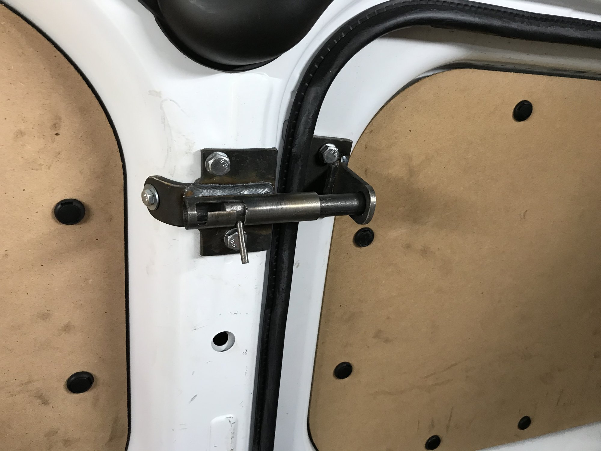

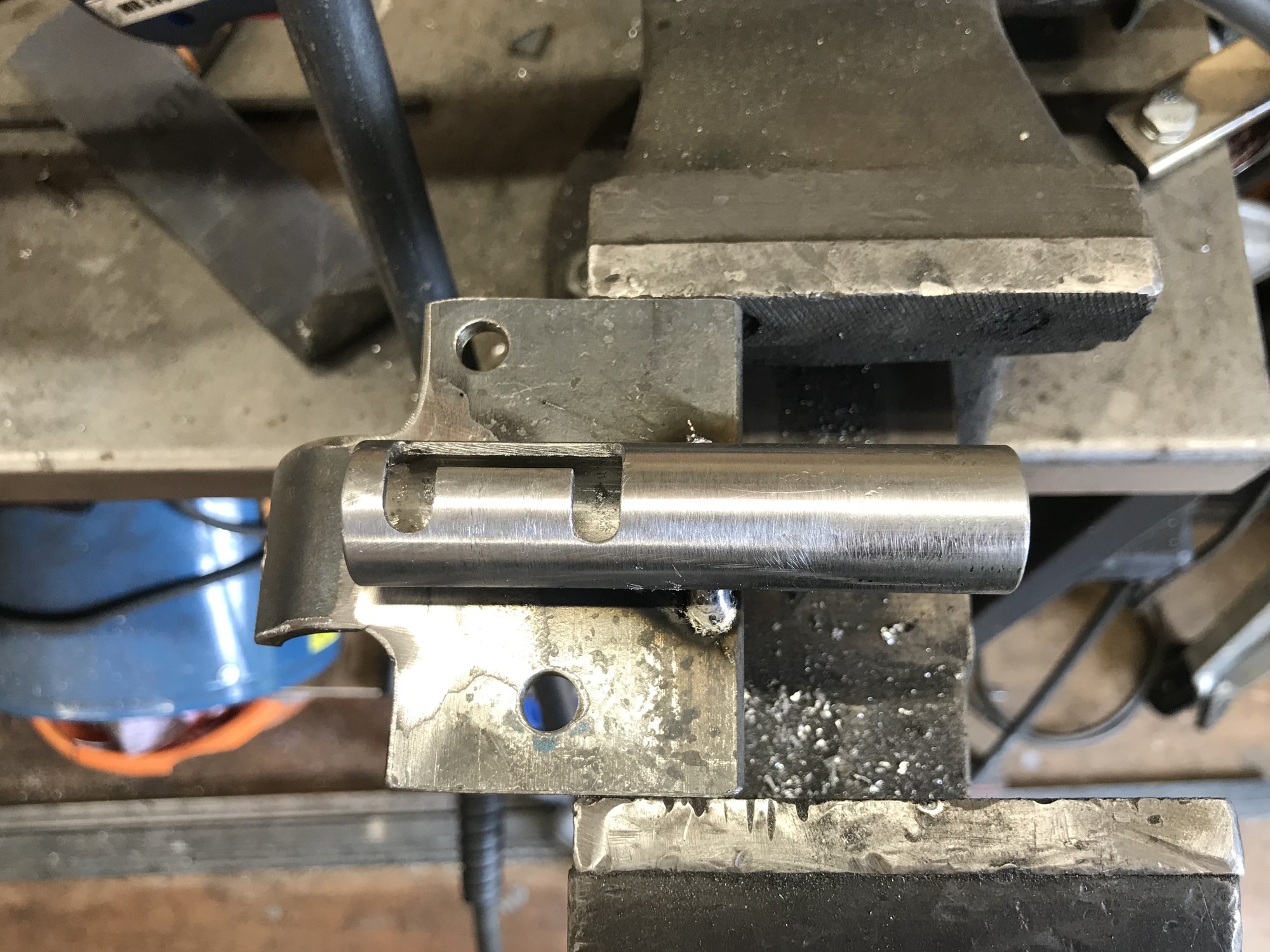

I can’t take credit for this but I saw something similar so decided to make my own rather than purchase it.
I have a transit custom and the doors are made out of cheese. They regularly get folded back (like most vans to be fair). This should combat it from both ends. I don’t actually keep anything in my van, it’s just a commuter more than anything but the last thing I want is to come back to the door folded badly for no gain. I have some pictures of what I did on the other side. I’ll dig through and post them bellow. Not pretty but does the job
