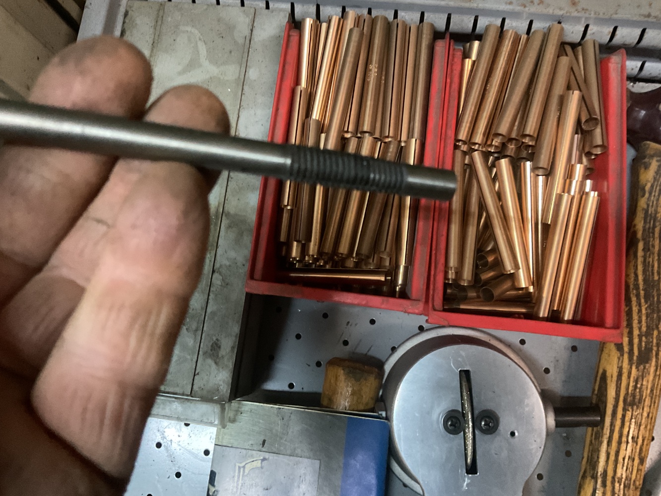

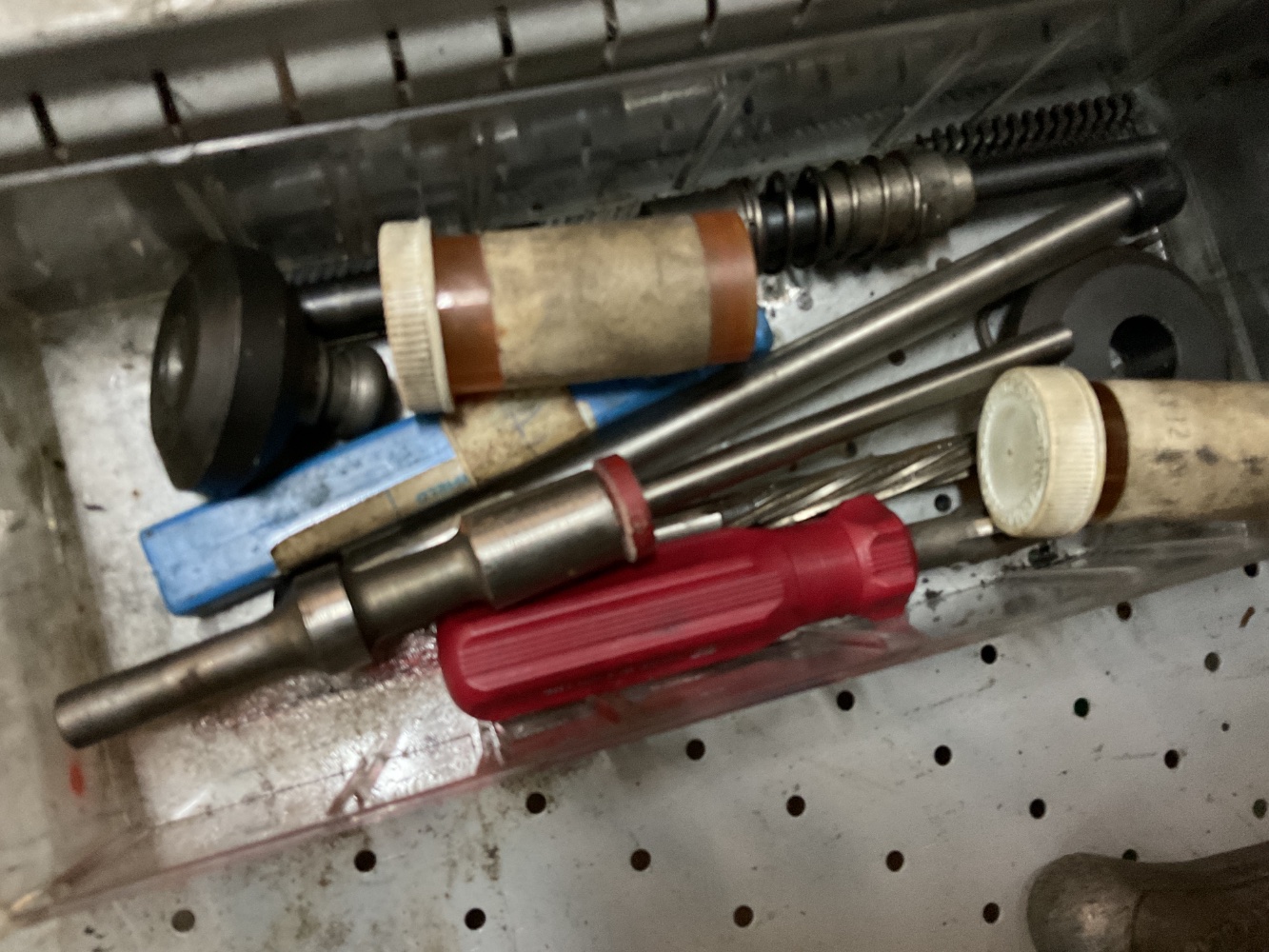

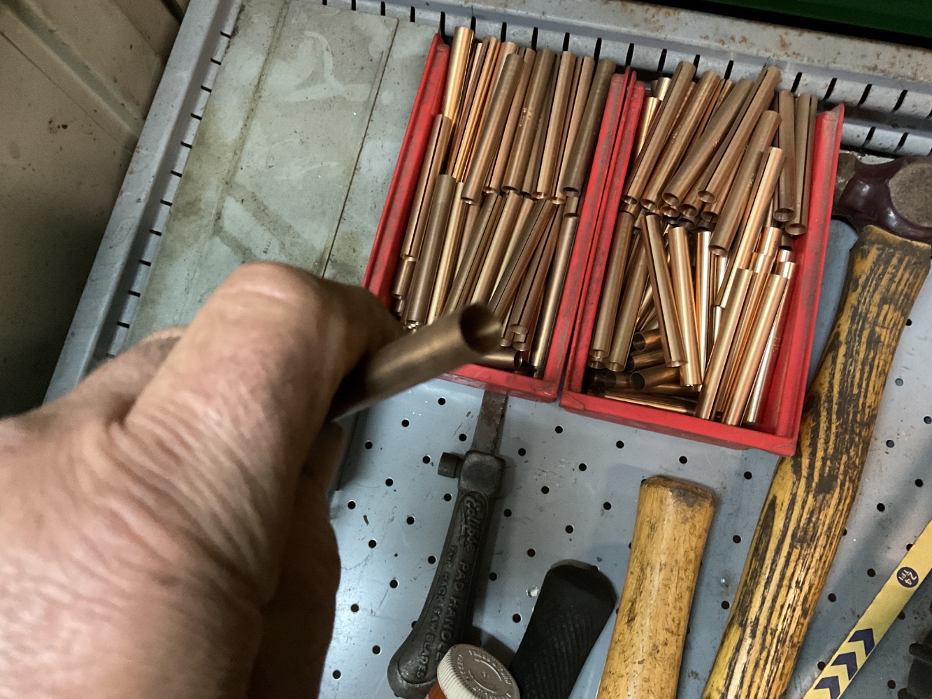

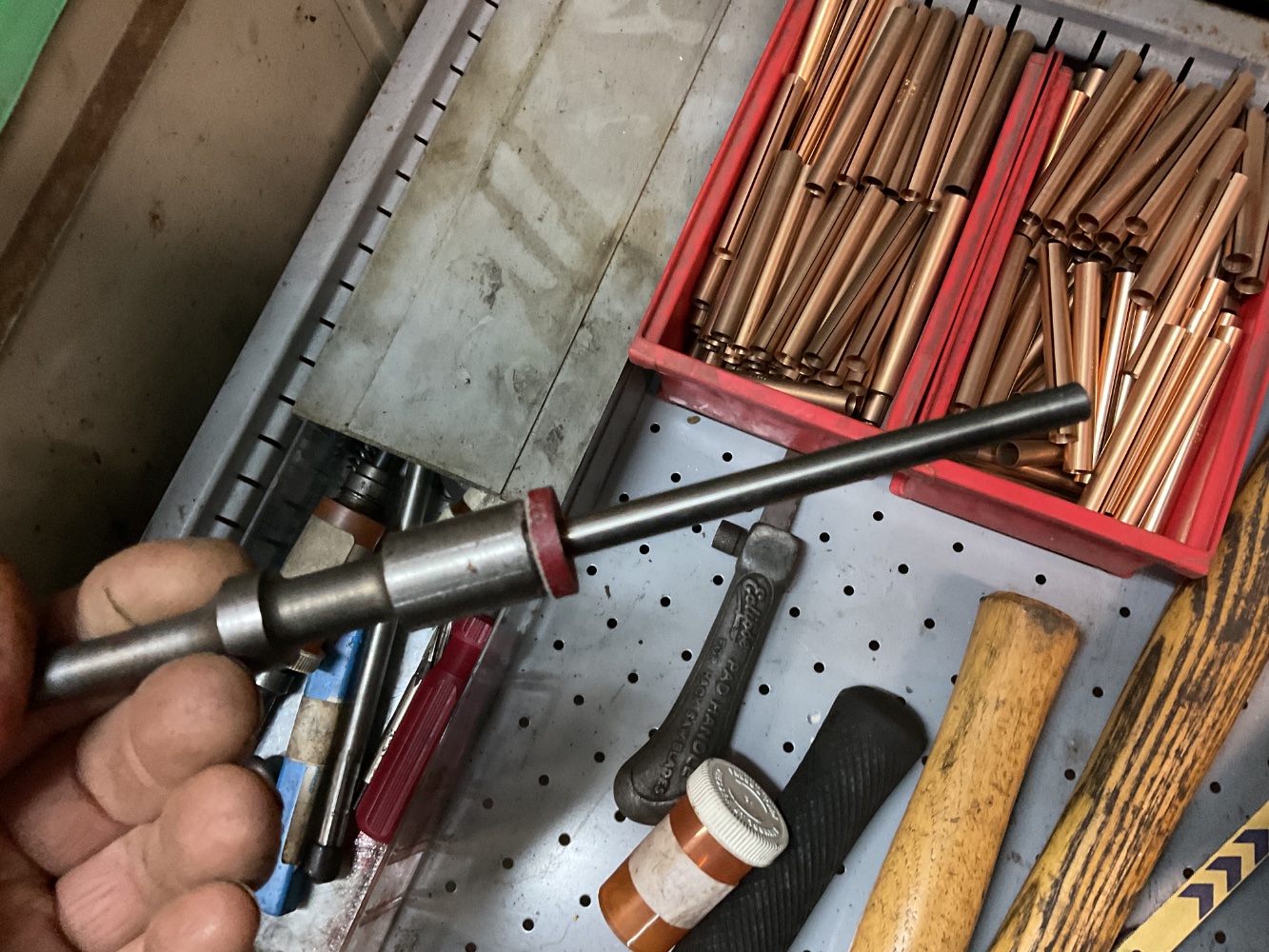

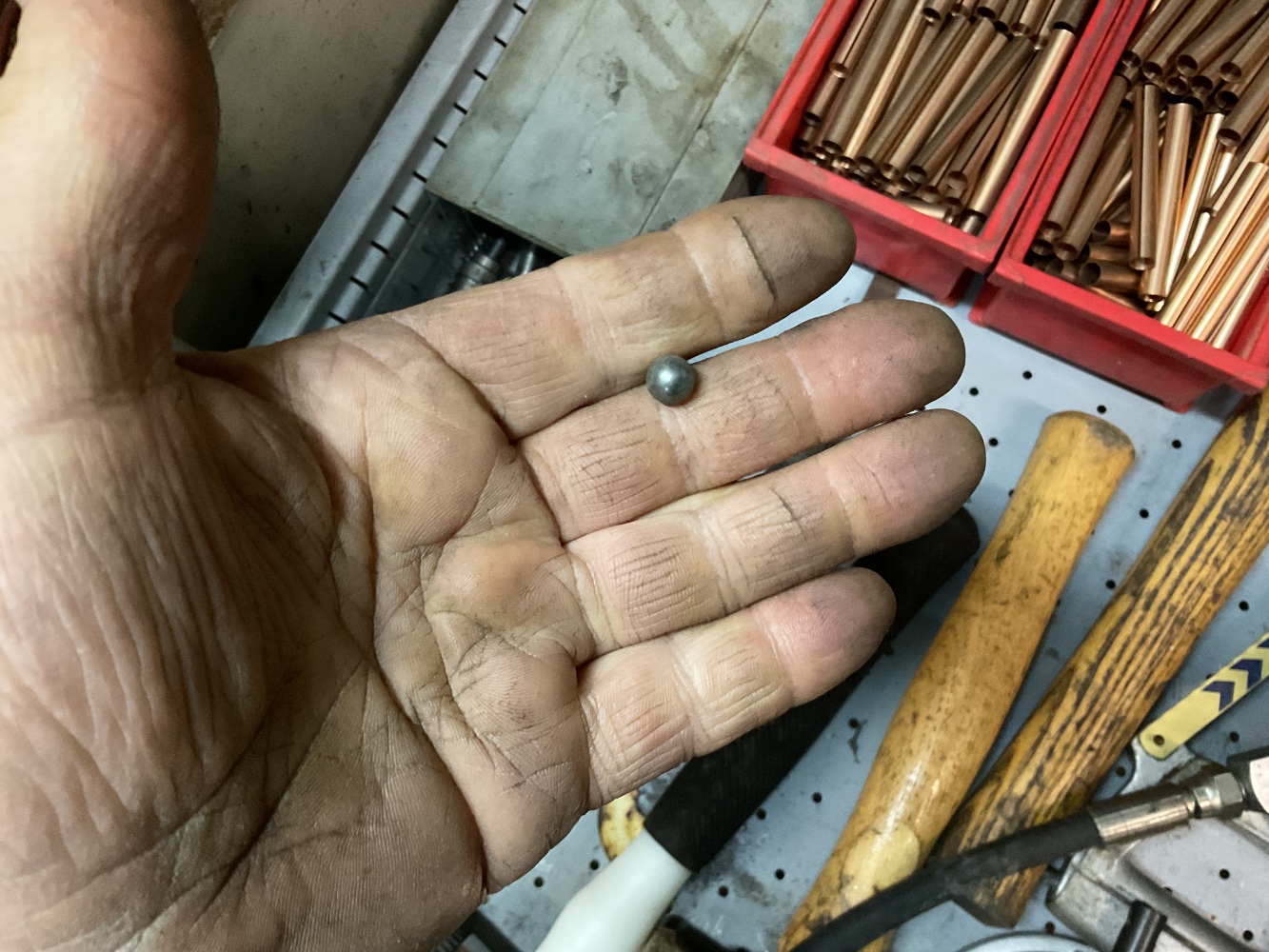

Cheers Bob that's great, seems the best option at the moment. Had no idea about dressing the liner with a ball bearing.Thinwall sleeves are a quick,cheap and easy way to reclaim a guide, comes as a kit. Ream out existing guide, drive in new sleeve, stuff a bearing down through the new sleeve which dresses the new sleeve hard into the old guide and ream to size.
Bob
View attachment 526445View attachment 526449View attachment 526448
Or if it’s not to worn you can knurl a guide which brings it back to size, some believe this is better than a new guide because it retains the oil.
