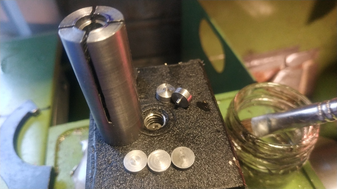

Adjusting valve clearances by tipping the valve has been around for many years as engine manufacturers recommended methods Correctly done on a valve facing machine is as 8ob says is quicker, easier and more accurate way than skimming shims.
I think originals or silversteel/en19 hardened and tempered on the soft side will be safest.
