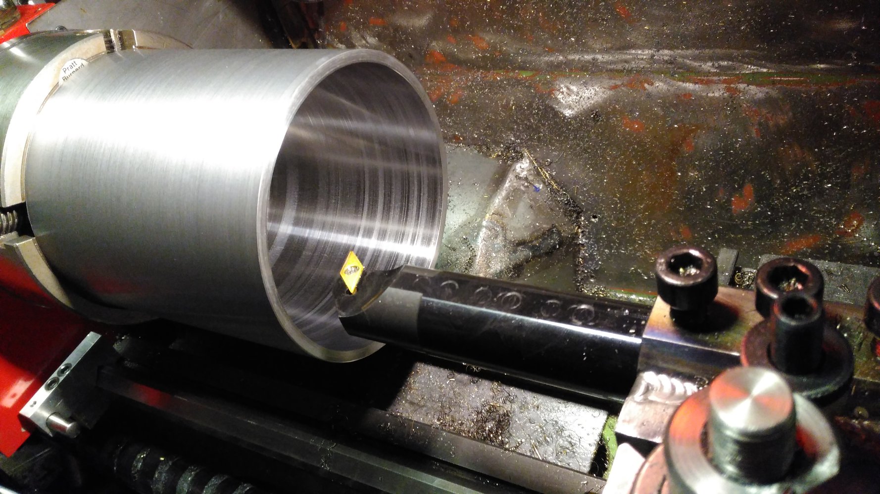

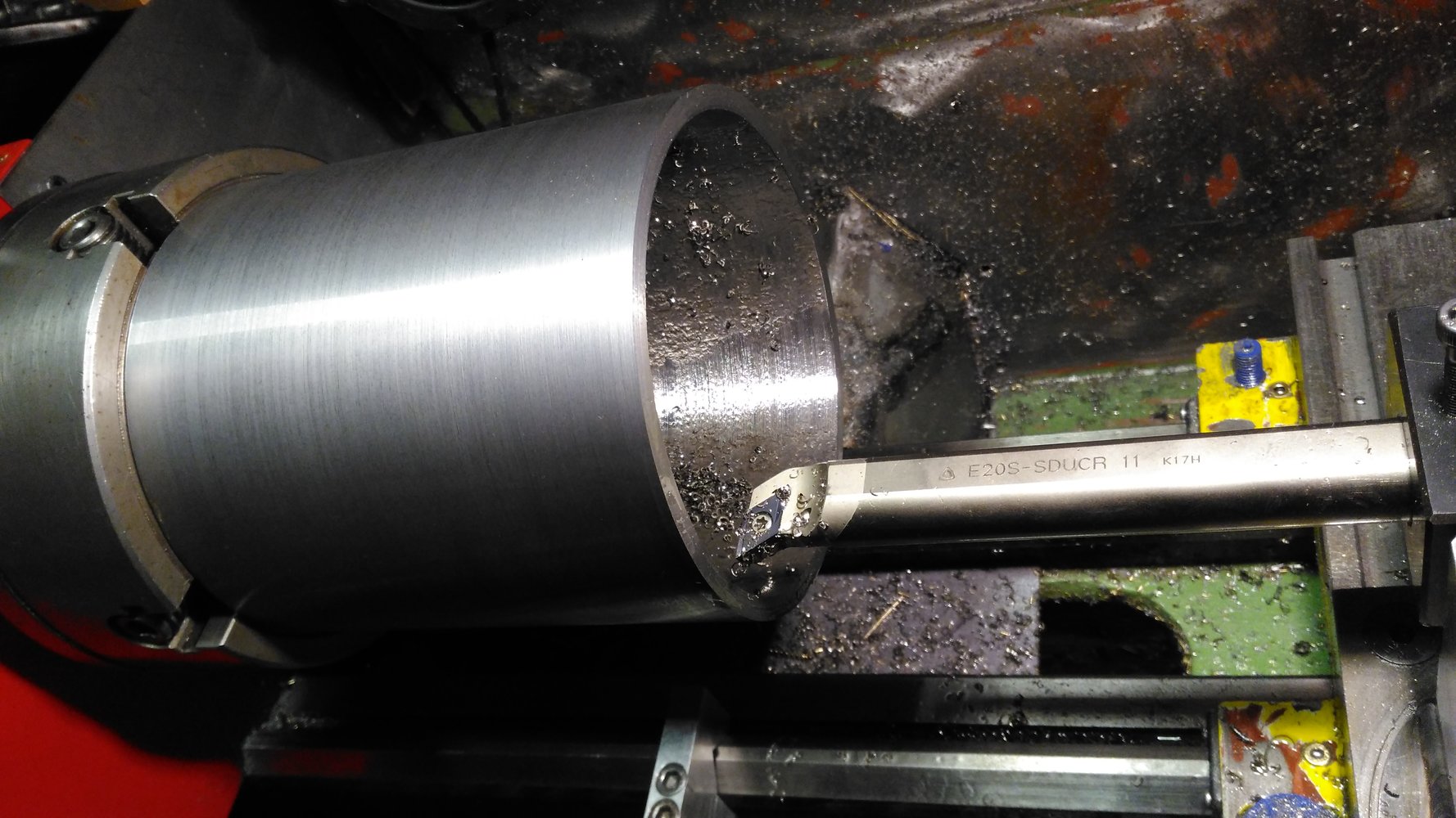

If Im turning both parts I may aswell do it as a shrink fit. Even a sliding fit should hold vacuum with a smear of oil around it.@Kram was talking to me about maybe putting a shoulder on the bottom "plate" so no welding required, just a seal. Would it need epoxy or some other sealant?
I need to tidy shed again lots of stuff infront of lathe.
I was going to do the ends but, as it was extremely rough theres no harm in doing the full bore. Turned nice once I was through the intermittent cut, good excuse to use the big bars.
