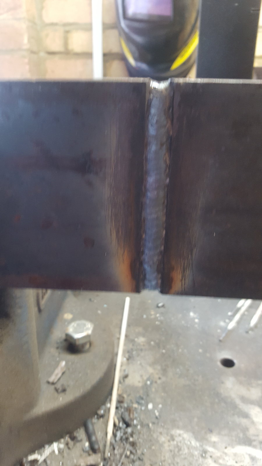

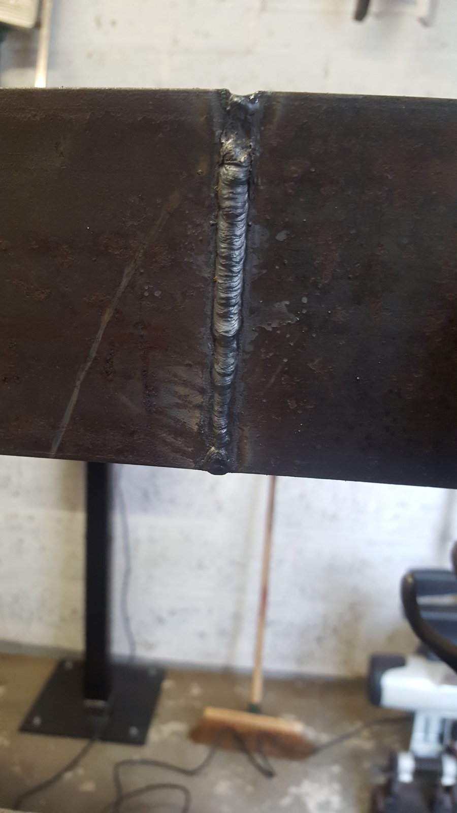

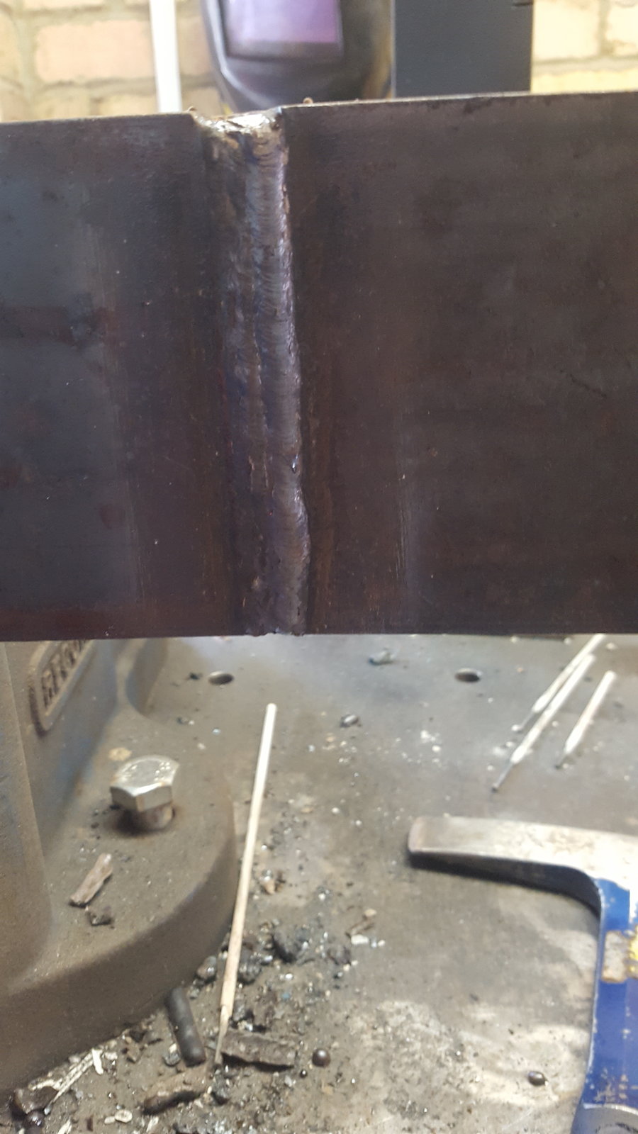

Well finally got round to running a couple of open root v up. Root with filarc 56s 2.5, fill and cap Conarc 49c.
You don’t want any arc force with them mate. Use more amps.Looks tight @Arclikeharrypotter I've been playing with those filarc 56 7016s there a ok rod I've not played much with them I find if I don't use arc force and more amps the weld becomes less fluid easier to control I have been meaning to do some practice runs just been to busy
Yes David low hy, 7018. Very nice indeed.
I need to get some 55.00 over to you. Don’t rate the conarcs tbh.
Bohler OHV 50 is a beautiful rod.
