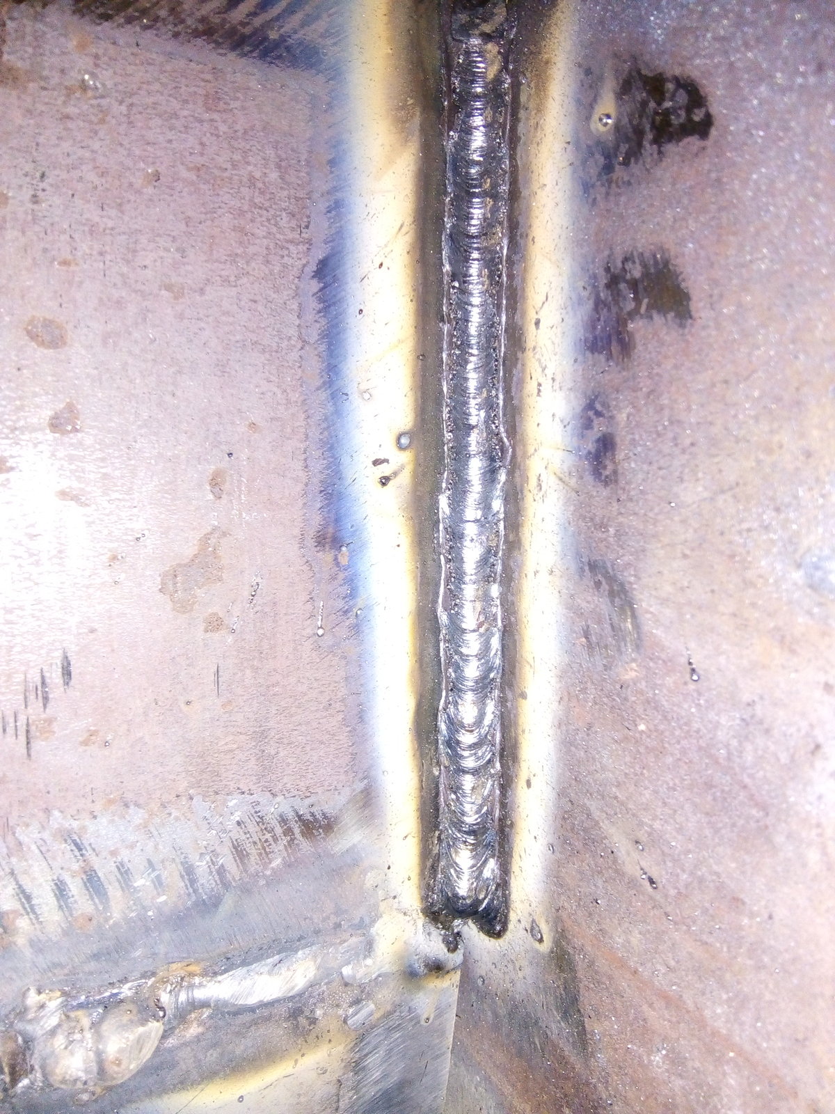

Hope you get better soon mate...
Harsh, I didn't think the welds looked bad!![]()

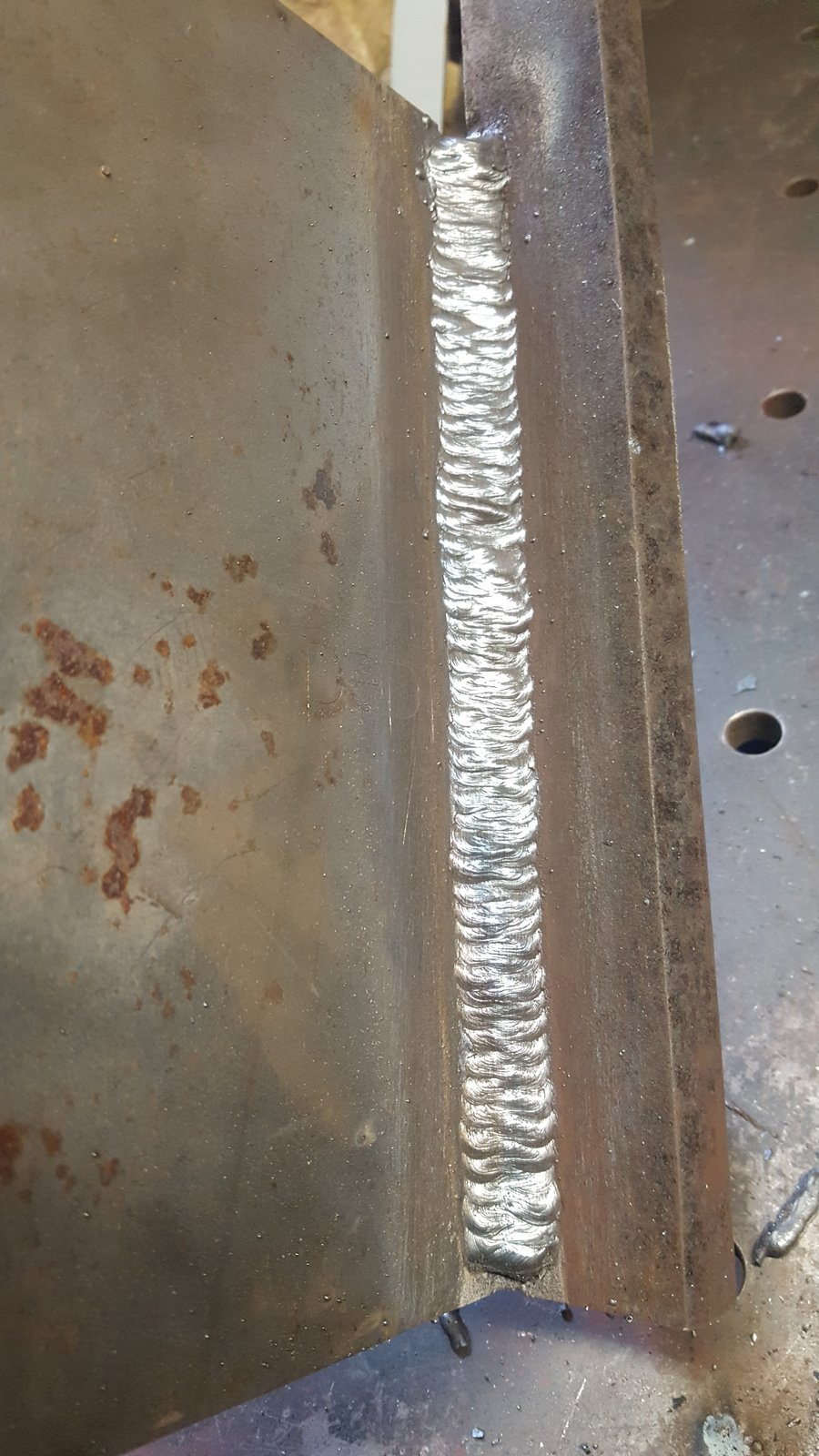

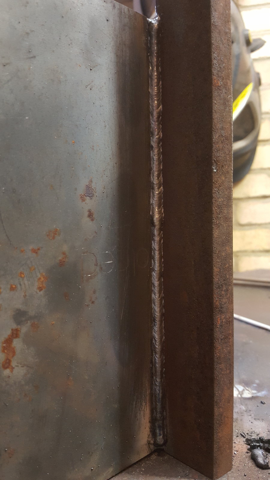

Are you running the Filarcs on DCEN?Cheers @Brad93 . 6013 isnt something use often but have a few boxes kicking about. Mostly use them for open root, or spezial. Still can't seem to get the hang of running filarc 56s on open root.
Dcep about 85 A. No control of arc force on this machine. About 2.5 mm landing and root gap. Getting a nice reinforcement and then boom way to much, turn it down a few amp and I'm barely punching through.
I'll have to bevel another piece of plate and go dcen. Those setting work well when running overhead open root but v up I'm struggling.

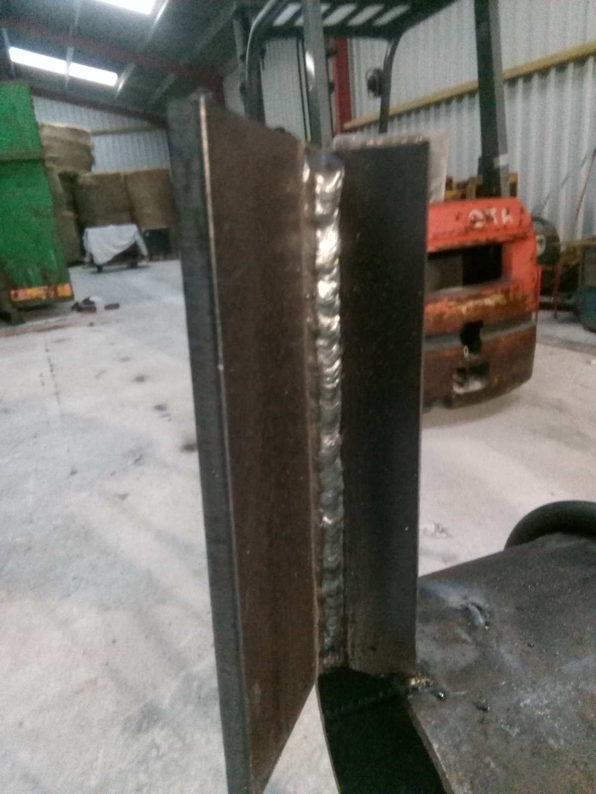

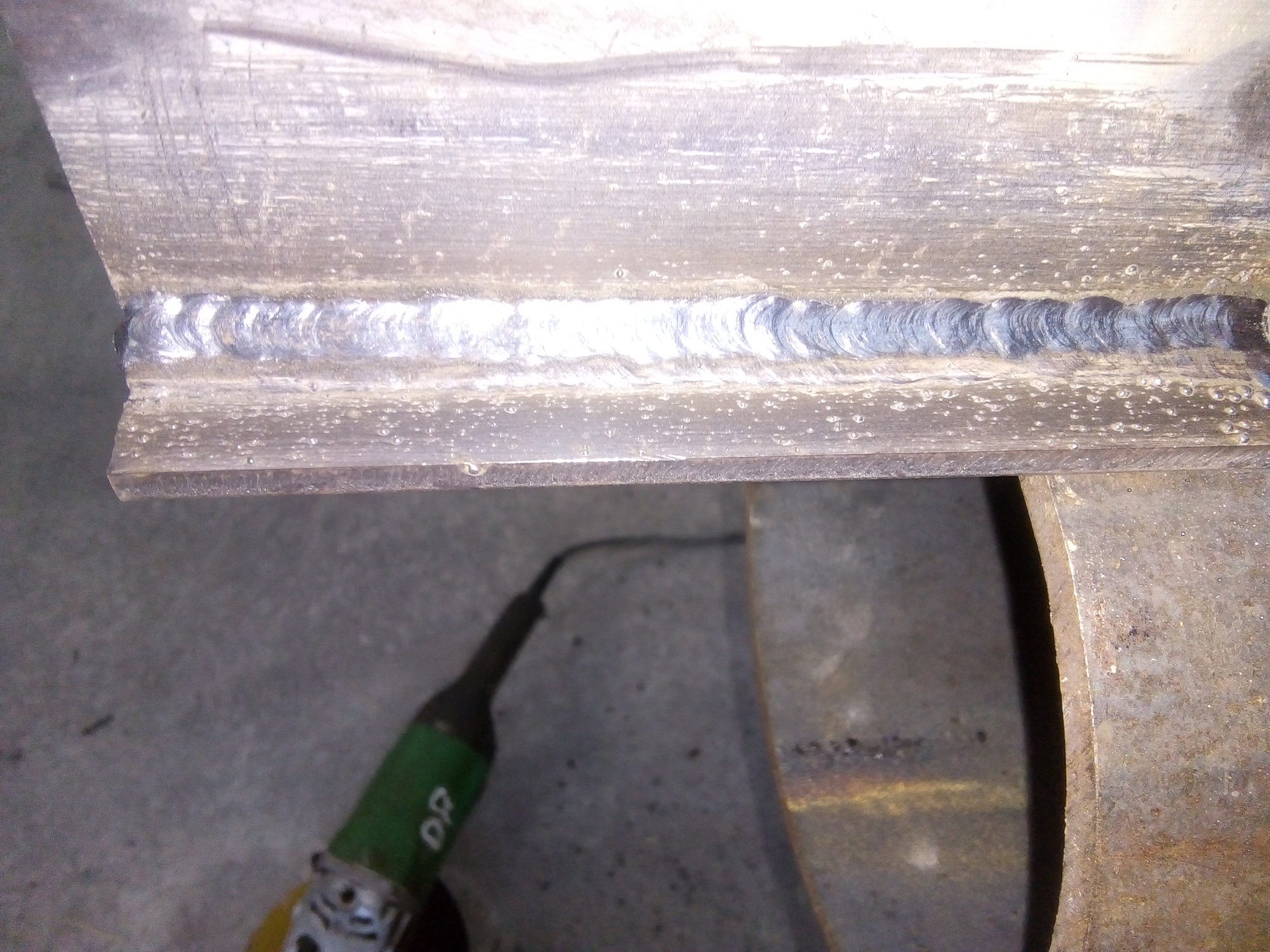

Heres one i prepared earlier 25 mm vertical multirun fillet 4mm and 3.2 mm filarc 88s 150c induction heatedThought I'd join you David with bit of v up practice. 3.2 6013 electrode. View attachment 135300 View attachment 135301
