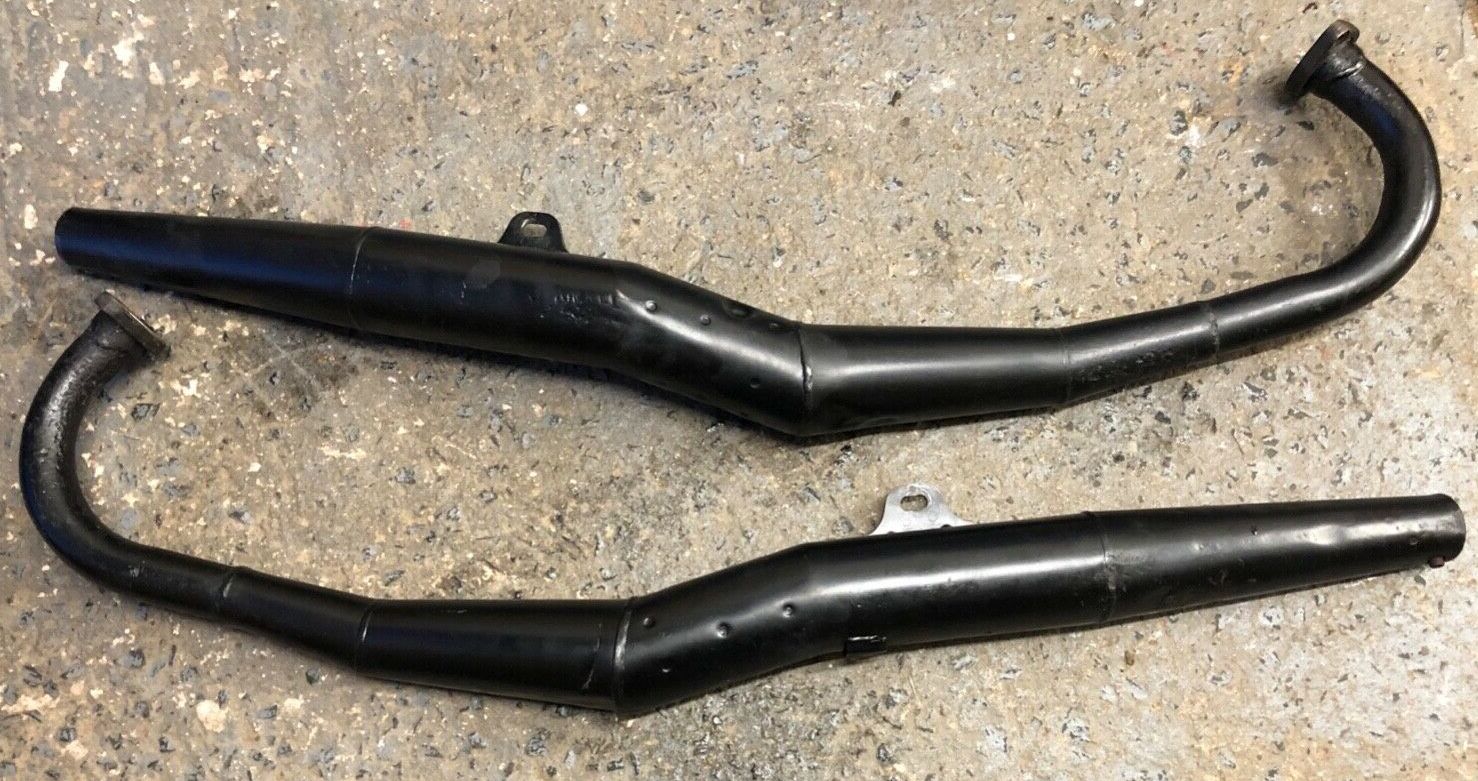

Have a look for some rubber bungs to fit tight into the headers and seal them.. Put some plastic bags around the header pipes and tie wrap them to the pipes as insurance. Pour a caustic solution (I'd use 1/2 kg per 4 litres water- preferably hot into them and leave for a day, lift the foul water drain cover and tip down, flush the bog. Flush the pipes with cold water and see what they are like inside. Repeat as necessary.

Have you seen the pics above? It's not just the silencer, it's the whole one piece exhaust. There's very little that won't get coverage if it's suspended horizontally. Plus it makes it much easier to manage. And with it getting heat input from below with the plumber's torch, the solution will be active and moving around in the exhaust.Only a rubber bung in the header and put the pipe vertical. Even better make a plate to seal the header flange and bolt it up.
I would not expect full coverage with the pipe "horizontal" and it's easier to control if only one opening.
On four-strokes, yes. I don't believe that LC exhausts have any such hole. If it does, a blob of weld will sort that out temporarily.Many exhausts have a tiny hole at the lowest point to drain off condensated water that collects in the pipe. If yours does and you hold them horizontal they'll drain out.
My only concern (similar to that with torching the pipes to burn off the oily residue) is the smoke it produces in a residential neighbourhood. Did it produce a lot of oily smoke?I used to clean out the TZ350 & IT175 pipes removing the silencer, by pouring a bit of petrol into the expansion and lighting it.
Once it burnt out, bung up the cylinder end, stand them up right (tied to the garden fence) pour in the caustic soda supersaturated mix I made in a bucket.
Leave overnight to soak, then pour the stuff down the drains and stick the garden hose to flush through.
Tip out and then get the pipe back on the bike, start and get it good and hot.
The detachable silencers I used to just chuck any wadding left and roast the perforated tube in the coal fire/or blowlamp and repack with fresh wadding.
My mate Paul's LC, I took the baffles out, roasted them with the blowlamp, treated the rest as per above.
