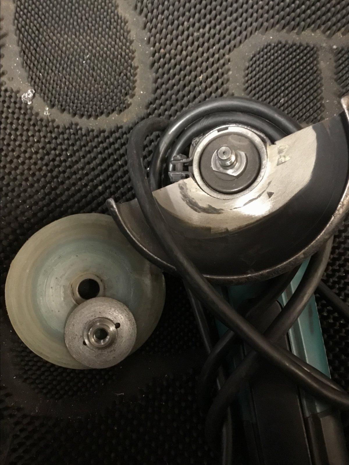

my local aldi has 125mm flap disks on sale at £0.99 for 4. If I make a new guard for a 115mm grinder, Im thinking that they should be fine on the smaller grinder, as the maximum speed of the discs is lower than the maximum speed of the grinder.
my thoughts are that I should be ok doing this, what do you guys think?

the max speed of the discs is higher than the max speed of the grinder
