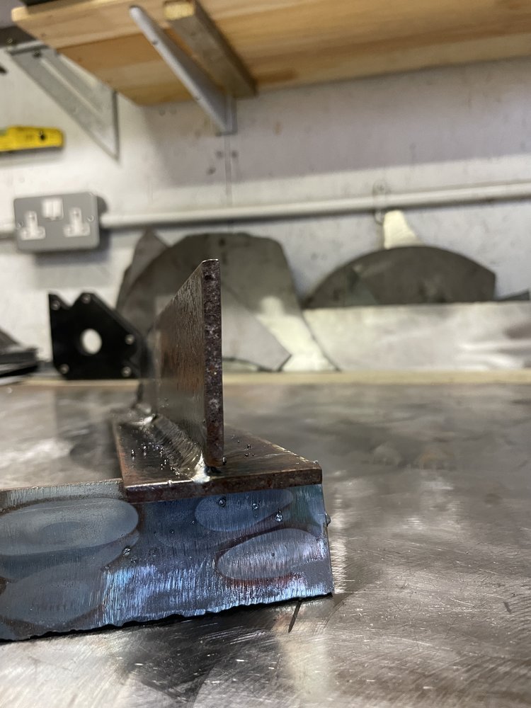

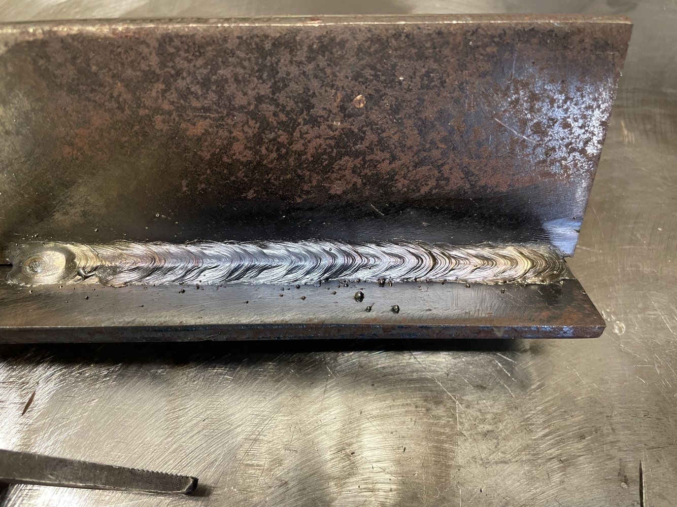

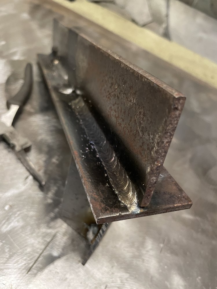

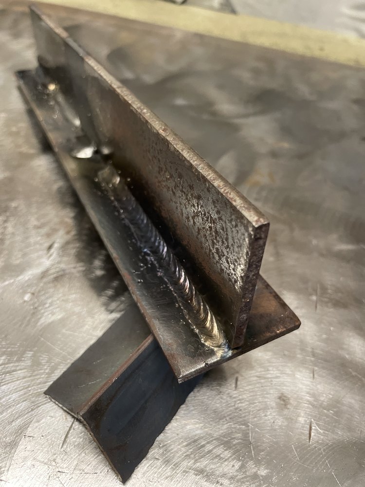

Thanks again. My voltage steps are 1 - 12 and wfs from 1 - 10. I’ll have a play later today or tomorrow on some scrap of various thicknesses and see how it goes.I don't no your machine budy but as a starting point there is a magic number with volts and wire speed and I'm pretty sure off the top of my head it's 12. So if your on say 24volts your wire speed would be on 12 and tweak from there and say 18volts and wire feed 6. On 24v your most definitely in spray. Hope this helps you
