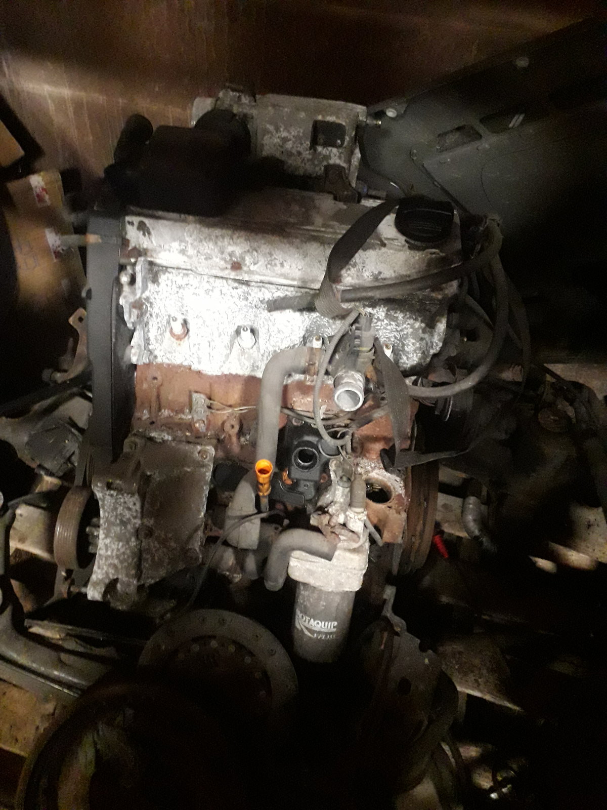

Yes please ruffian definitely a drink in it for you if it is.Think there is a complete abf engine under the rack at work from a rotten mk3 golf gti that got broken.

I did try them but they said they didn’t have one@james butler if all else fails try Volksmagic in Oldbury http://www.volksmagic.com/
You can tell the correct one as it has a dizzy cap with ht at 90 degrees coming out and the cap is held on with 2 8mm bolts
The dizzy is held on with 2 10mm bolts
