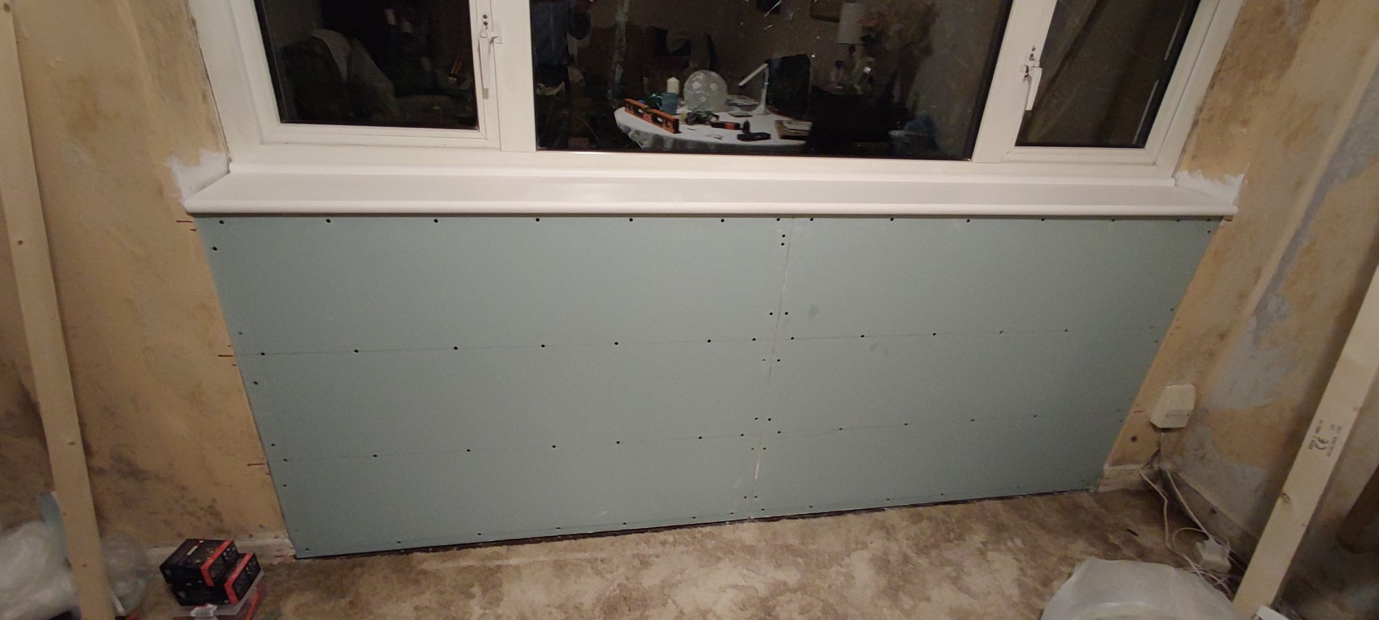

not the skim .you must mean keep the plasterboard 20mm up from the floor thats behind the skirting board3mil at the top, 20 at the bottom!
its too stop you picking up crap off the floor with your float when your floating the wallsOk I havent done plasterboard or stuff by windows where all this needs to be considered!
So I leave a 20mm gap under the plasterboard, which is not skimmed and is hidden by the new skirting?
Im not sure if they intended that but there is a crumbly gap at the bottom of walls hidden by the old skirtings!
Id remove the skirting at the sides and the telecoms box and skim the whole wall, yes right up to the shelfIs SBR no good then?
The plaster says to use Thistle Bond it primer on moisture resistant.
I have joint tape.
Also should I skim right upto the shelf?

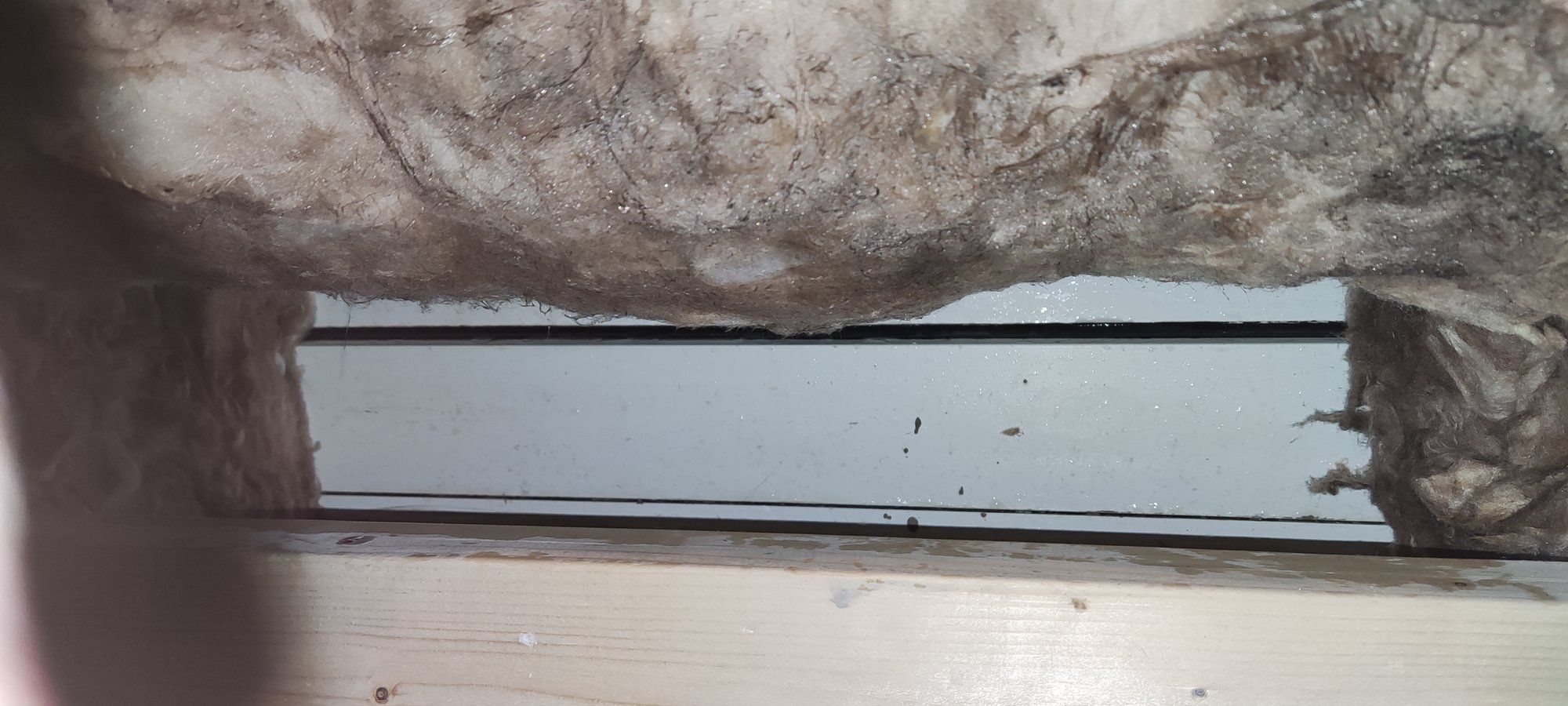

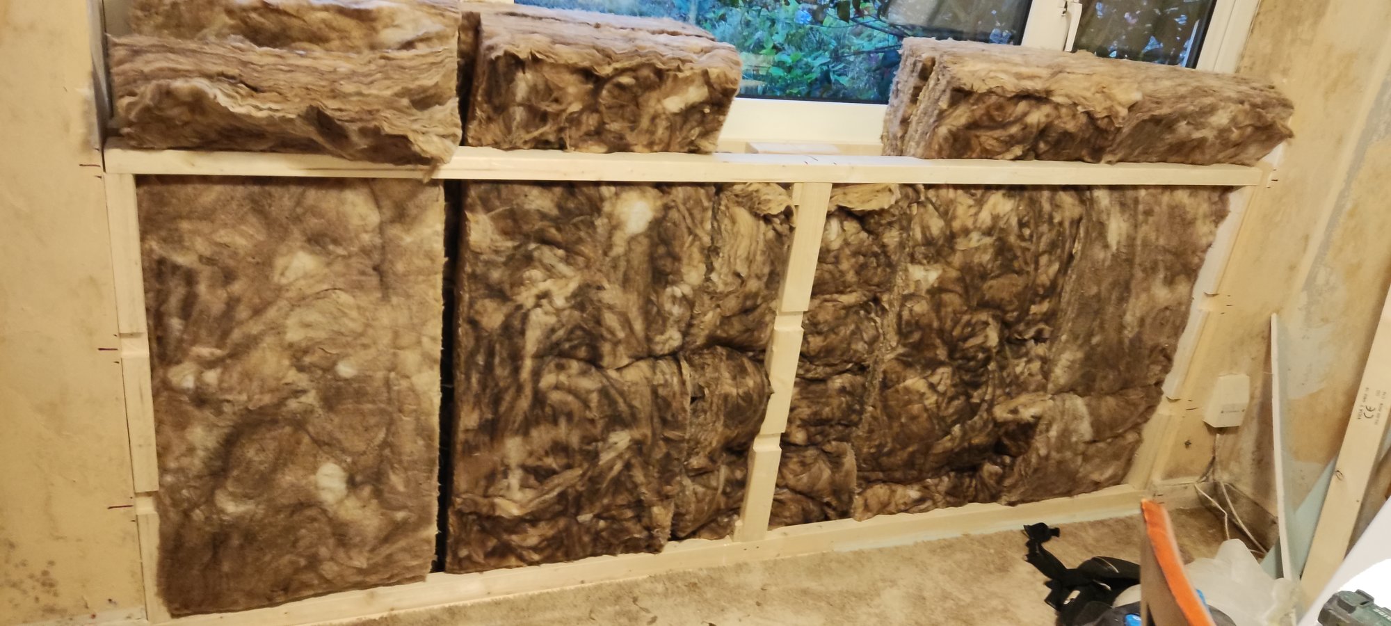

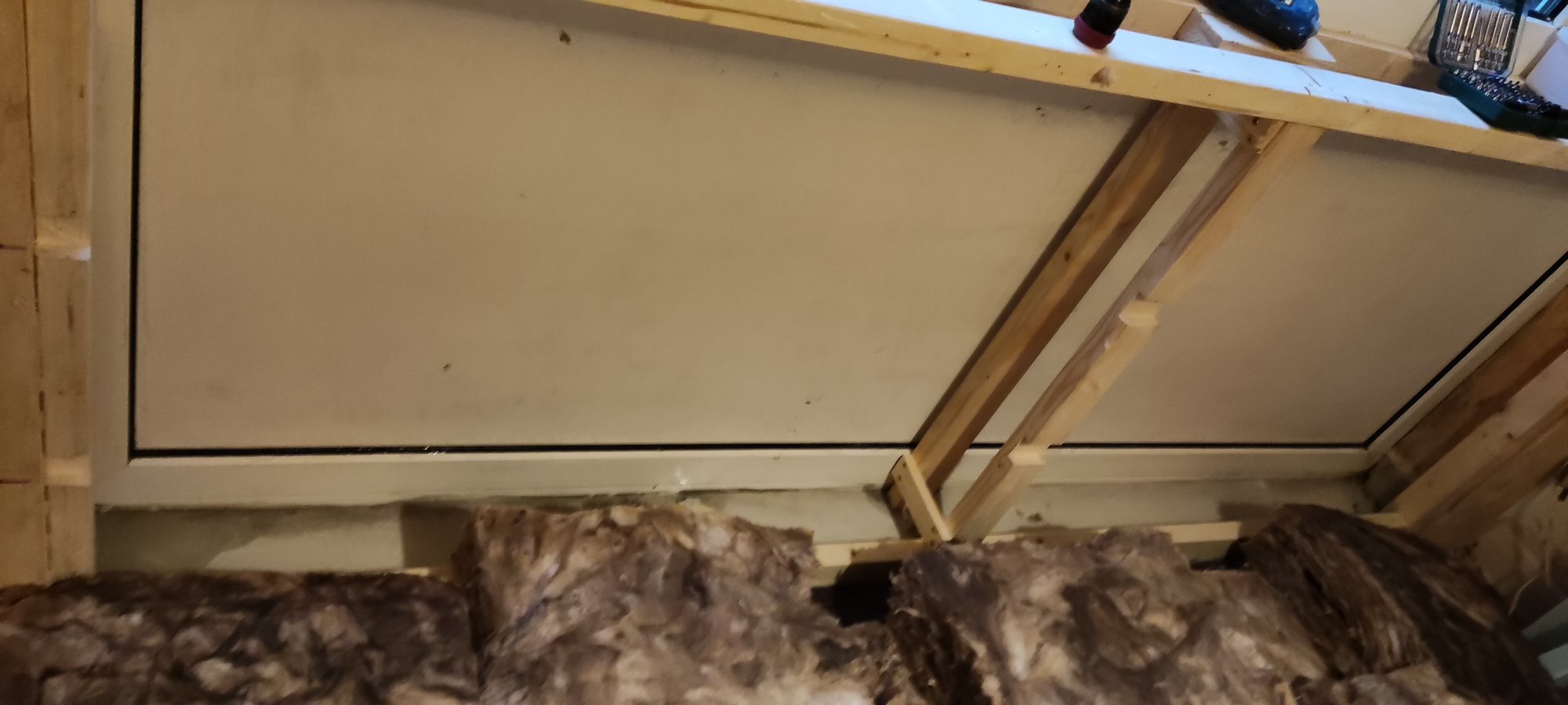

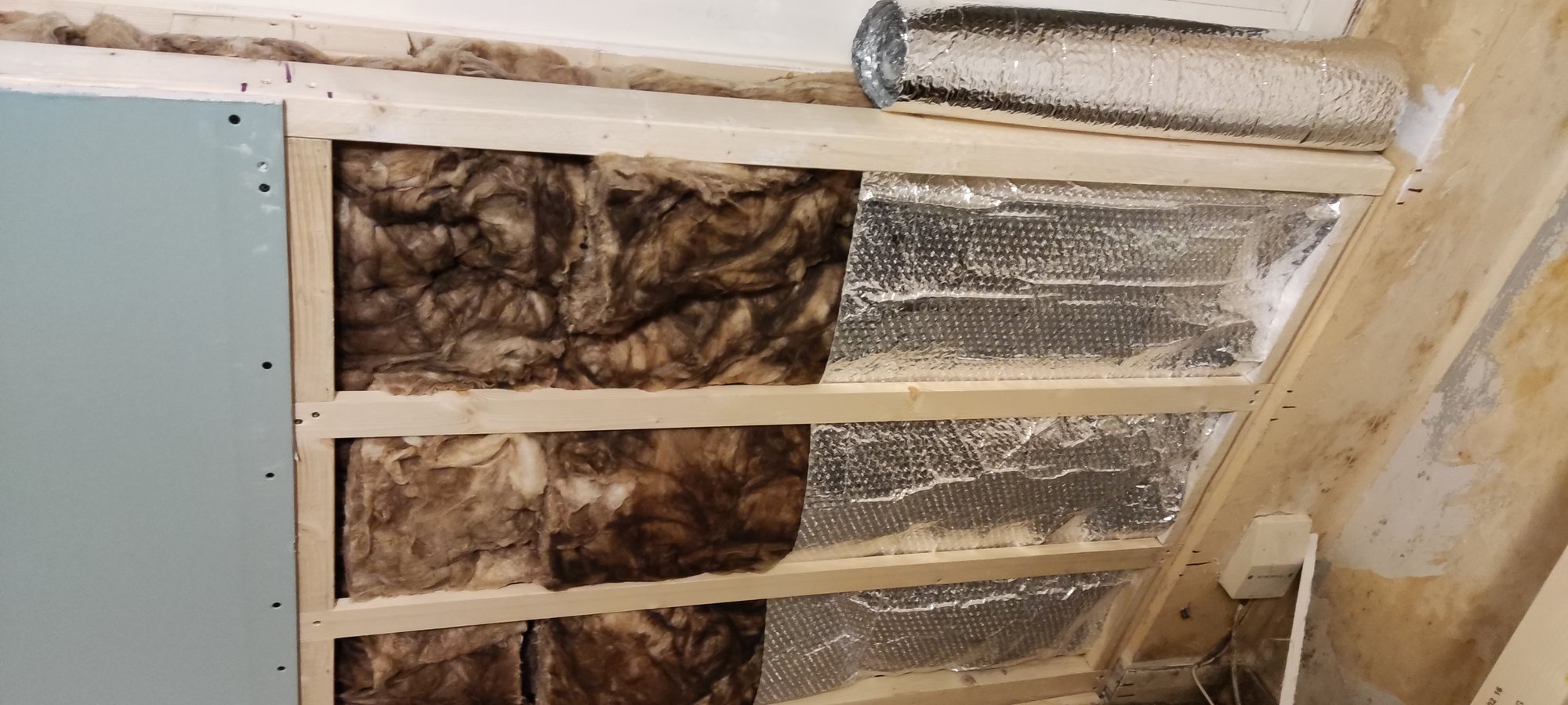

The topboard was screwed down but has a timy gap either side and back, planned to seal the gaps and paint it later on.can you tell me what you have done to insulate what you used and its thickness and seal that area up
sealing the top board to the sides is what i mean if you havent you will still have a through flow of air
ignoring the bottom gap as that would only let cold air in
