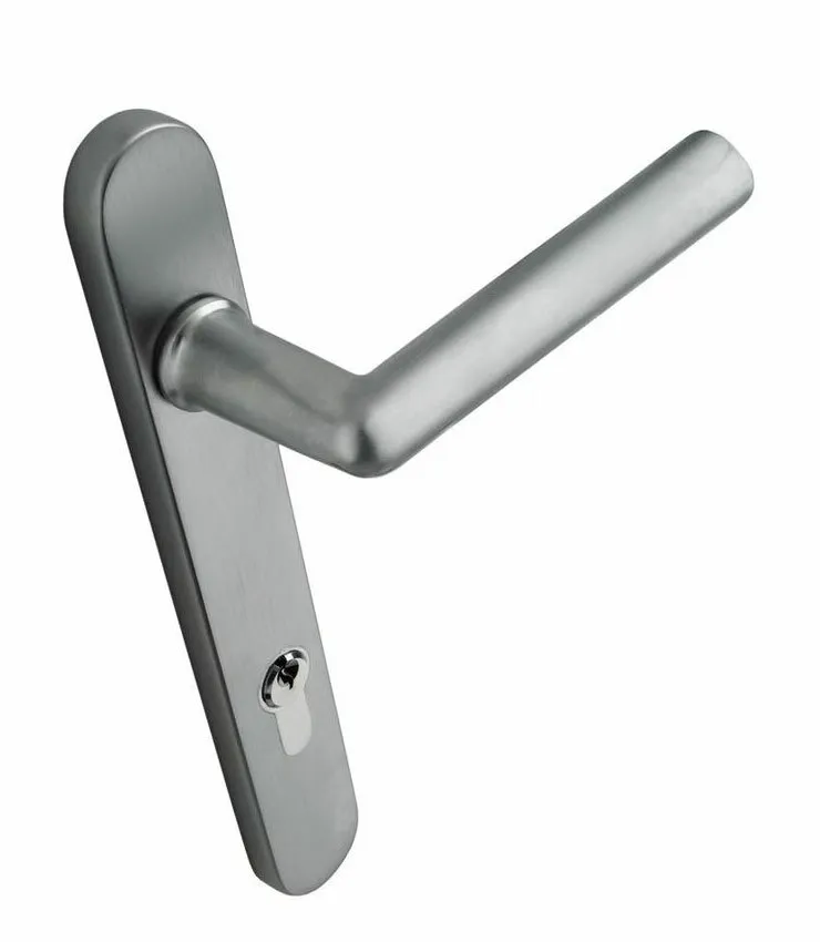

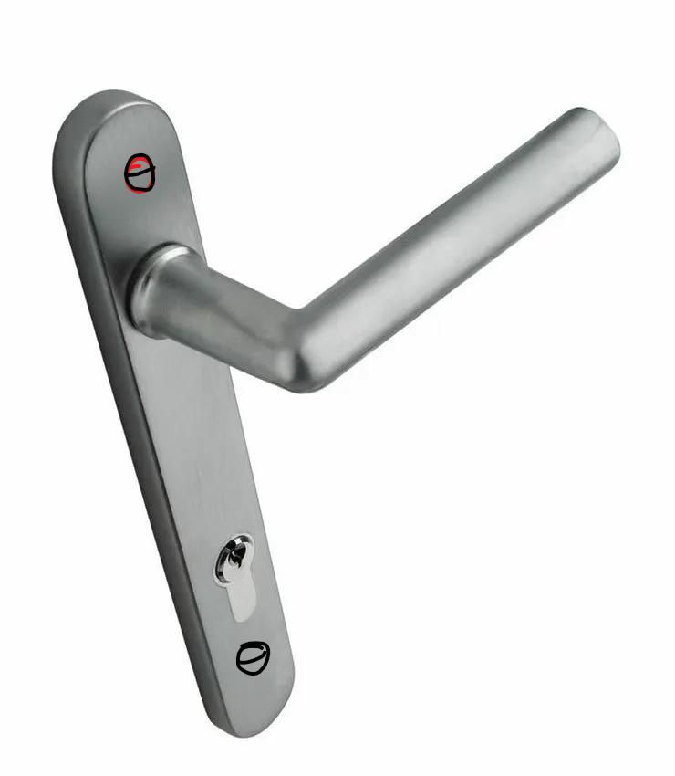

got a standard council spec upvc front door , handle is a bit wobbly but theres no screws visible inside or out , anyone got a pic or describe how you nip them up?
its more the body wobbling than the actual handle ...if i could get it apart i would see about getting a new oneyou will need a new handle set
it normally has a washer and a circlip to hold the handle straight but they wear badly so when failed like yours its only worth getting a new handle
