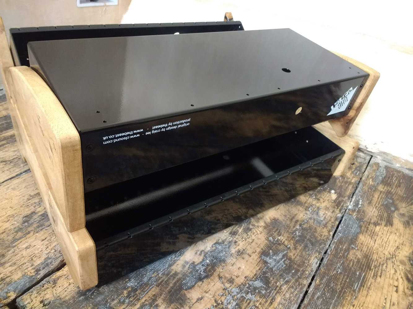

Im considering using raptor for some of my little metal box things.
Typically, i use a gravity spot repair gun, and, say, 350ml will do two coats on, maybe, ten boxes (i should pay more attention really, but close to that)
Ive never used raptor, and would want the stippled effect (ie schutz gun)
1 ltr is more than id need in one go, i reckon. I mean i guess it goes on way thicker - ive just looked up and 1ltr is supposed to do 3sq mtrs. I cant actually work out what a litre of 2k is supposed to do, but im guessing multiples of that?
...so maybe 1ltr would give me the same as 350ml of normal 2k?
If not, what's the best way of dealing with this? Can you buy clean empty schutz gun bottles? Google returns this thread, which implies not!
So, maybe, first time, tip half the product into something else, and then mix up? Im thinking any less than half a ltr, and ill get so much wastage in a suction gun that it wouldn't really be worth it anyway?
What do you think?
Id be going over alloy, so it would be epoxy primered if that makes any difference to anything?
Thank you.
