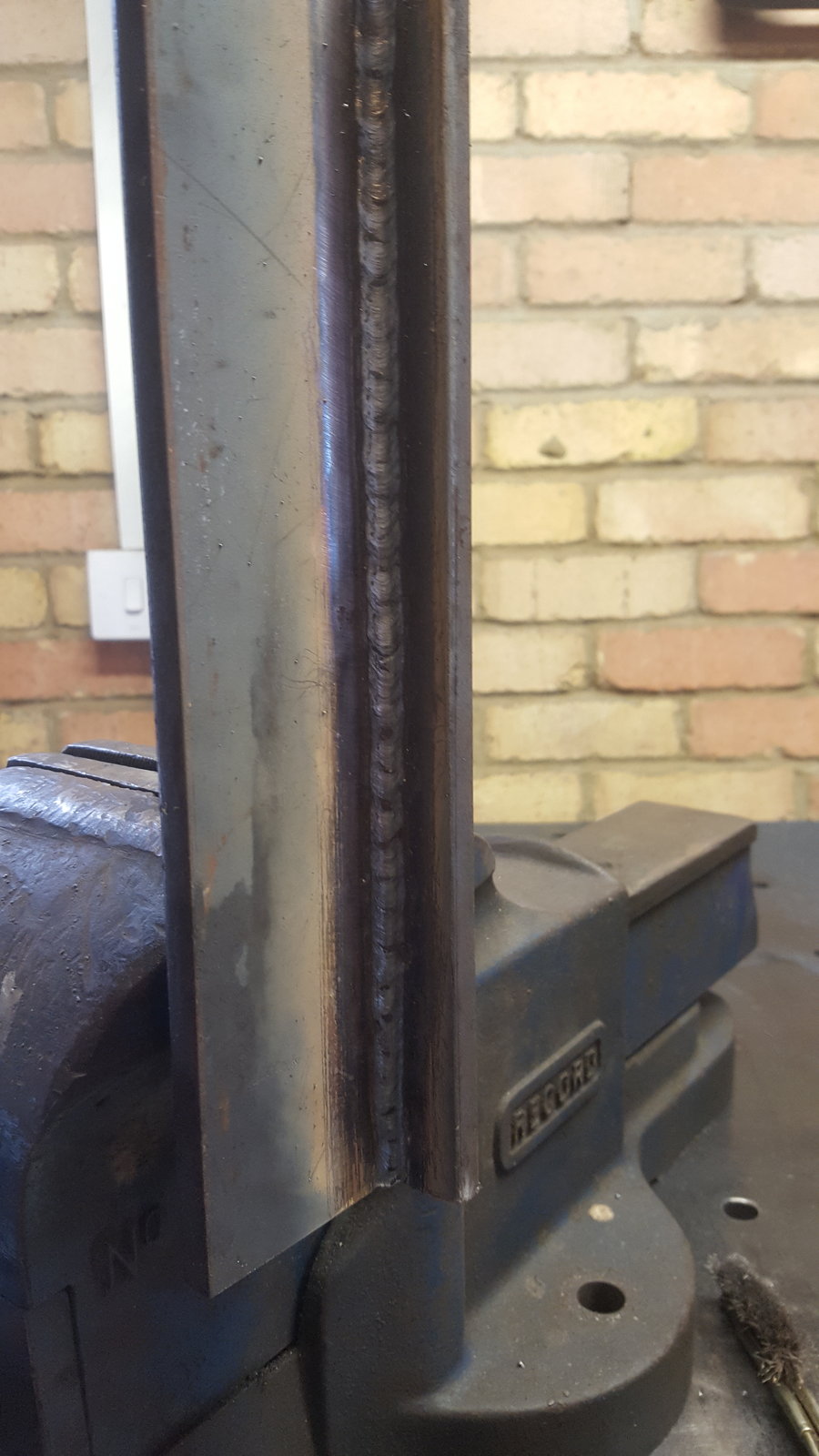

Some progress today...when I compare to last week it's really coming on but still looks like there's a fair way to go. On the flat it's all hunky dory... the troublesome stuff is uphill fillets...
Well I've worked through a box of esab 450mm 7018s and now have a box of bohler 7018s on the way. these new ones are shorter so should be easier to handle.
Adri
@Arclikeharrypotter
Your root pass in the photo. Is that with a 3.2 or 2.5 mm electrode?
