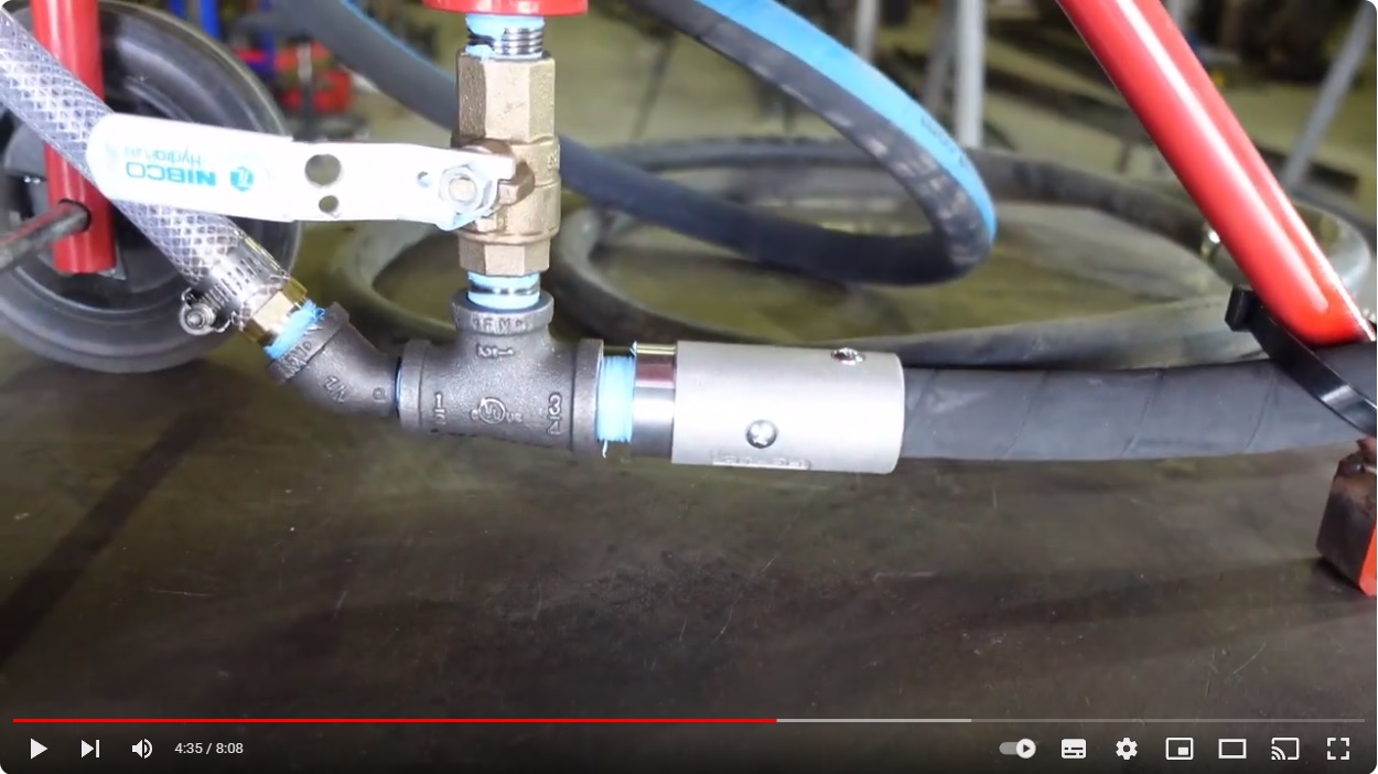

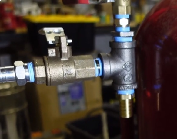

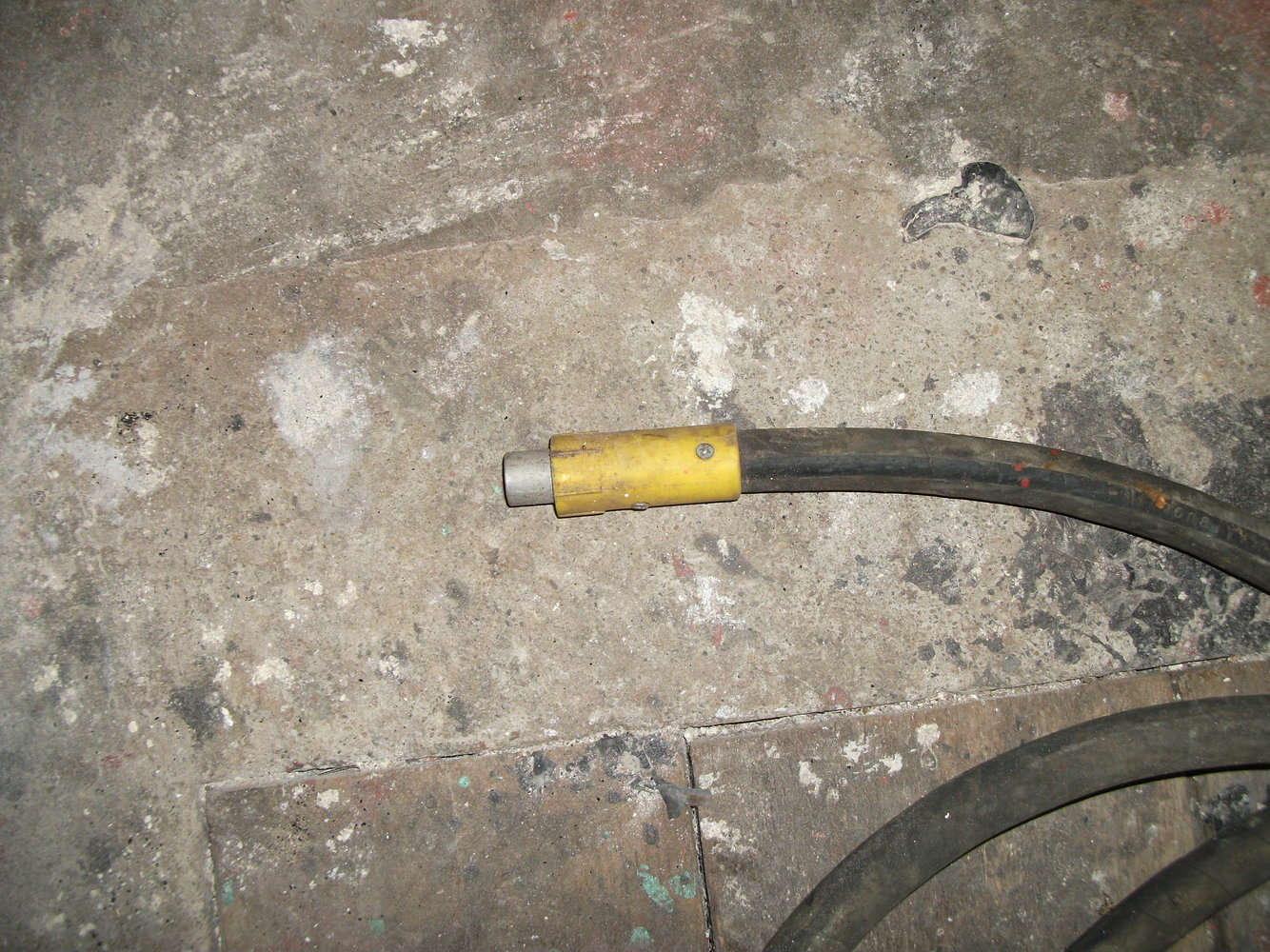

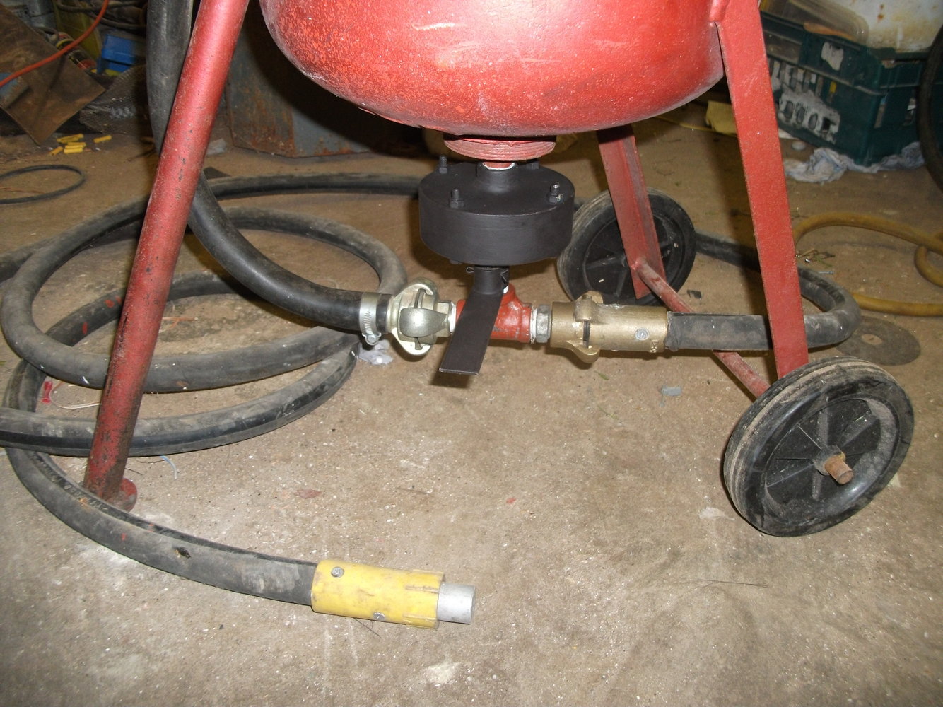

Hello,
Now that I have received my substantial (enough for me) screw compressor I am getting ready to upgrade my pressure blasting pot, and wouldn't mind some input from the pro's on here, if you don't mind
I think these upgrades should get me going as I don't have the budget to upgrade to a proper professional pot just yet. I know these upgrades especially the airflow etc will significantly reduce the blasting time I have.. but I'm just going to have to go with it for now.
Main reasons to upgrade are:
* Prevent clogging of media (New compressor has a proper drier too, which should help)
* Enable use of industry standard tips (50mm thread)
* Better air flow in general.
Questions are:
* It's currently 3/8" fittings all around.
* Considering the blast hose will be 3/4" ID do you think I need to go to 3/4" for the air supply and mixed media pipes - or would 1/2" suffice? I feel like 1/2 should be sufficient for the 75 CFM mark I will running at with { #4, 1/4", 6.5mm } tip.
* For the mixed media coming from the media outlet at bottom - will the 3/8" be a bottle neck, I wonder should I drill and tap to 1/2"
These upgrades are very popular for this pot, and I have found a good video outlining such on YouTube, here if you are curious (screen grabs below).
The guy in the video has a { #3, 3/16", 4.8mm } tip, so he won't need as much air flow - I just can't figure out if I need to breach 1/2" plumbing is needed. I am aware that I need to address the plumbing between pot and tank also, and that quick fit fittings are a no-no for airflow.
Interested in peoples thoughts on this one..
Many thanks in advance.
P.S. One other mod I was thinking about was attaching some kind of pushrod to the metering valve and run it up the side of the tank .. so that I can adjust the media mixture without having to bend down, which get's old quick...
