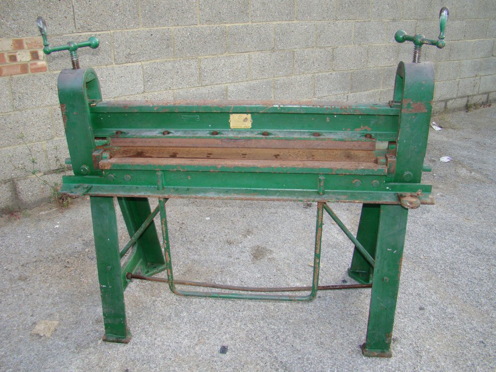

Thought a few of you might be interested in this. 1930's FJ Edwards, but i've not seen anything quite like it.

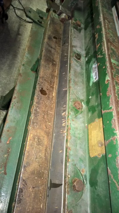

The upper clamp is like a piece of railway girder that has a former bolted to it. The former has a square side and a profile side and can be bolted either way round to give 90 or ~135 bends.

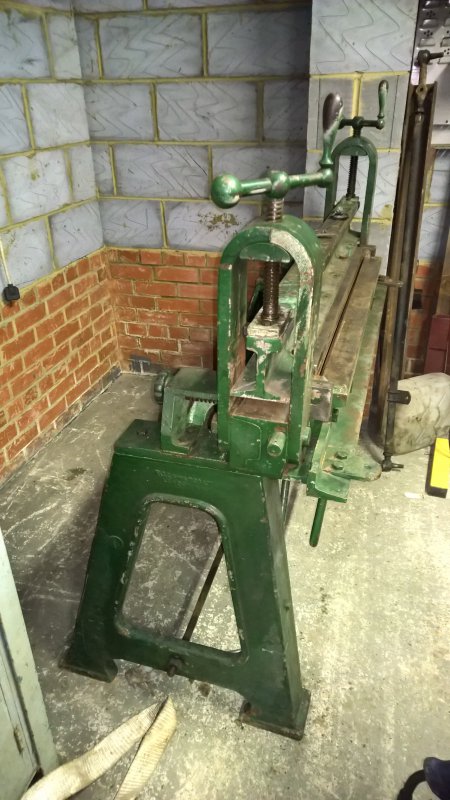

A couple of odd things are the height the former can be raised to - nearly 6" - makes me wonder if it had fingers originally as an option to allow it to work as a box pan folder.
Also the turrets on the side that the height adjuster sits in also flip to one side so you can remove the former/girder easily.

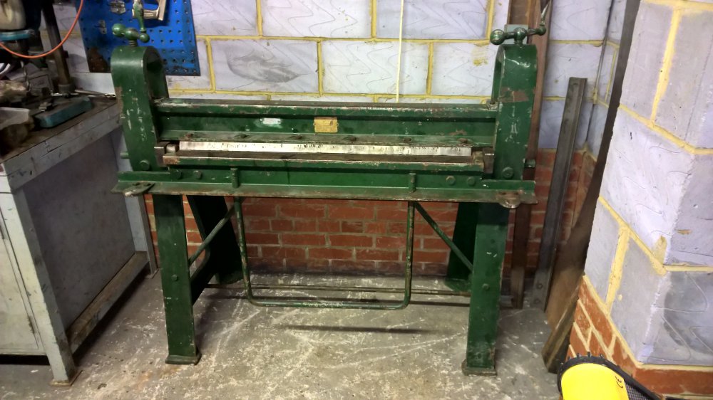

And finally in its new home.

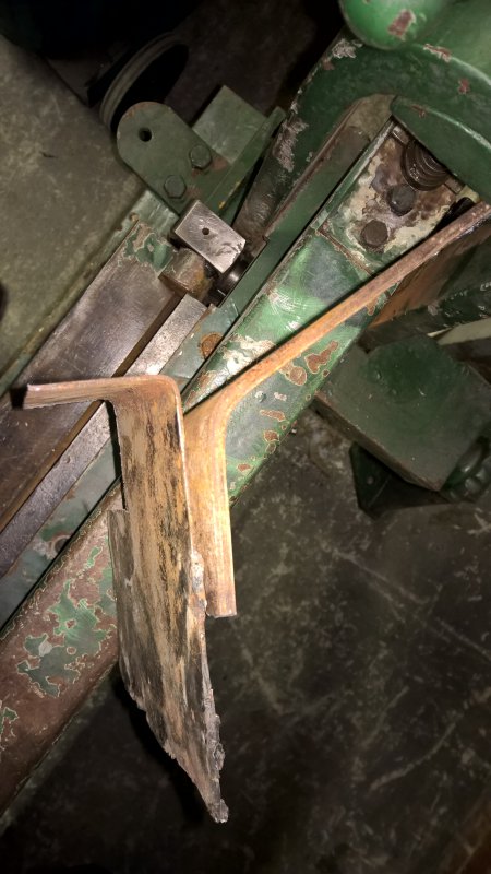

To give some idea of its bending capacity a couple of examples, some 1.5mm and some 7mm!!! The 7mm only is bent that far cause I didn't have the strength to lift the handles higher - not cause the bender wouldn't take it
