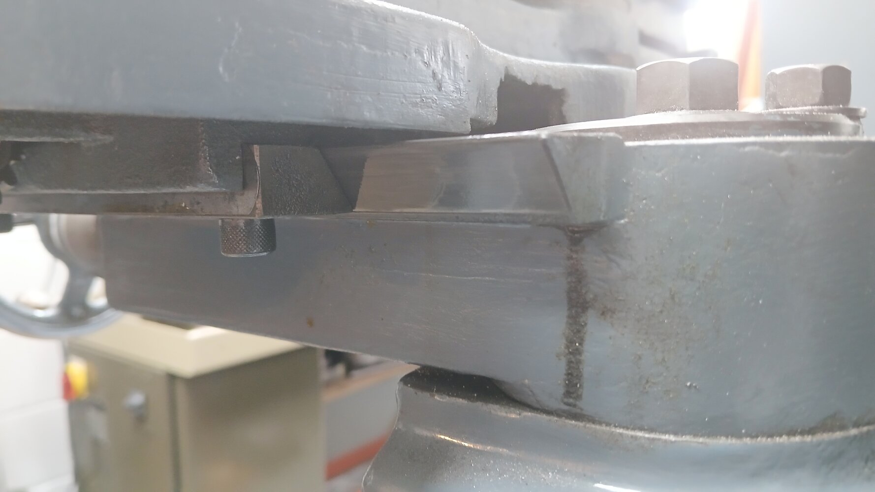

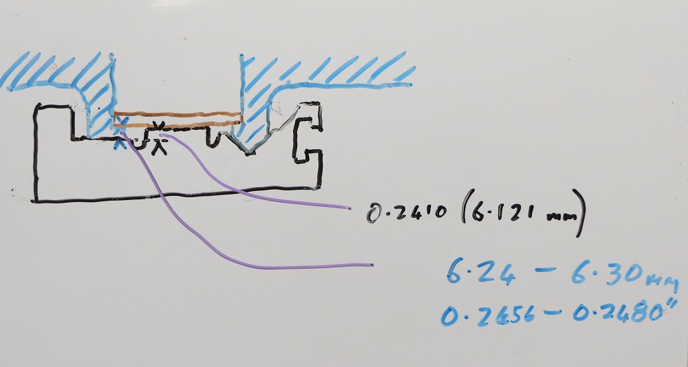

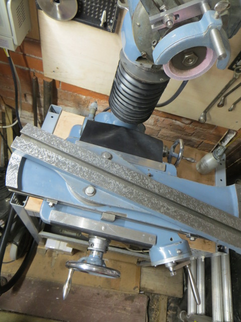

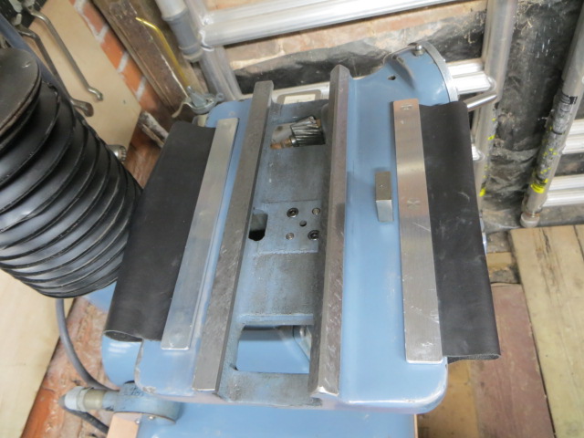

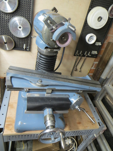

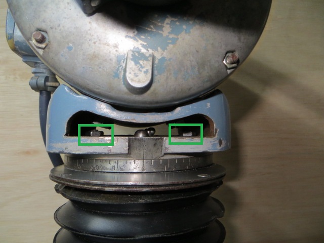

I had a look at my Union today as I gave it a workout grinding a grooving tool for the shaper. There's a shim on the side of the gib on mine, but the bolts are barely nipped up:I'm pleased I got the whole assembly to mate well with minimal play, but I can't help feeling I've gone about it all the wrong way. It was so labour intensive - there must be a better method. I suspect shimming was anticipated when these were designed.

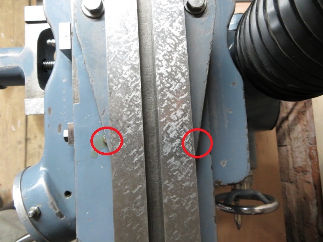

Some enterprising soul has cross drilled the front gib securing screw and fitted a rod through it so it can be used as a lock:
I would say what a great idea, but I'd forgotten it was there and haven't had a need for it in the 8? years I've had the machine!
