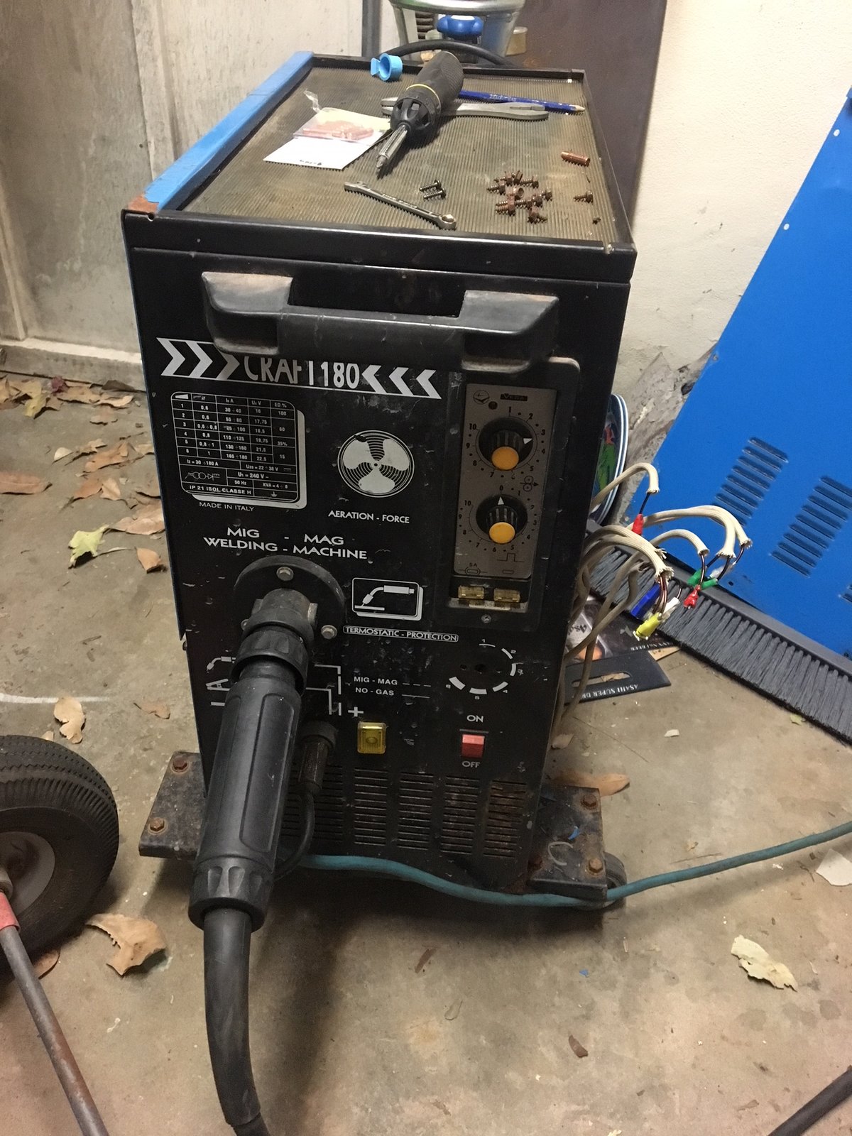

My Unimig has a 6 position rotary switch to select the power output (Sprecher Schuh LE2-16). It is a basic transformer machine, no inverter.

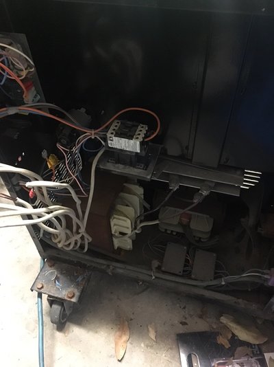

The switch was not functioning properly (difficult to operate with some hard spots, power on lowest two settings only) and I decided to take it apart to remediate (i know...).
I must have put the internal selector cam back the wrong way: wiring is correct but the switch heated up and fried.
Now looking for a workaround, or at least a wiring diagram. Does anyone have anything to share? I couldn’t get technical info on the web, and a replacement switch is quite onerous.
Thanks for your input
