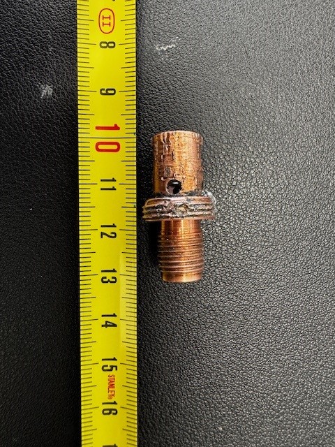

Secondly, I work for a gas company and we have a retail store selling welding machines, gases and supplies. I have enough knowledge on consumables to get by, however i have been thrown a curveball that i CANNOT find.
I have a new customer who has a currently unidentified robotic MIG torch running off a Megmeet Artsen PM400 machine. He is asking for consumables for it, most of which are fairly common Binzel consumables, except for one. The contact tip holder.
I have attached a picture of it, it is very similar to the contact tip holder for Bizel 401/501D but it is a little shorter at 18mm measured at the same points to the 401/501, but the screw mount to the torch is a male thread, looks to be M10. The tips are regular M8 Binzel. Picture attached of the part.
Anyone identify this to help point me in the right direction?
