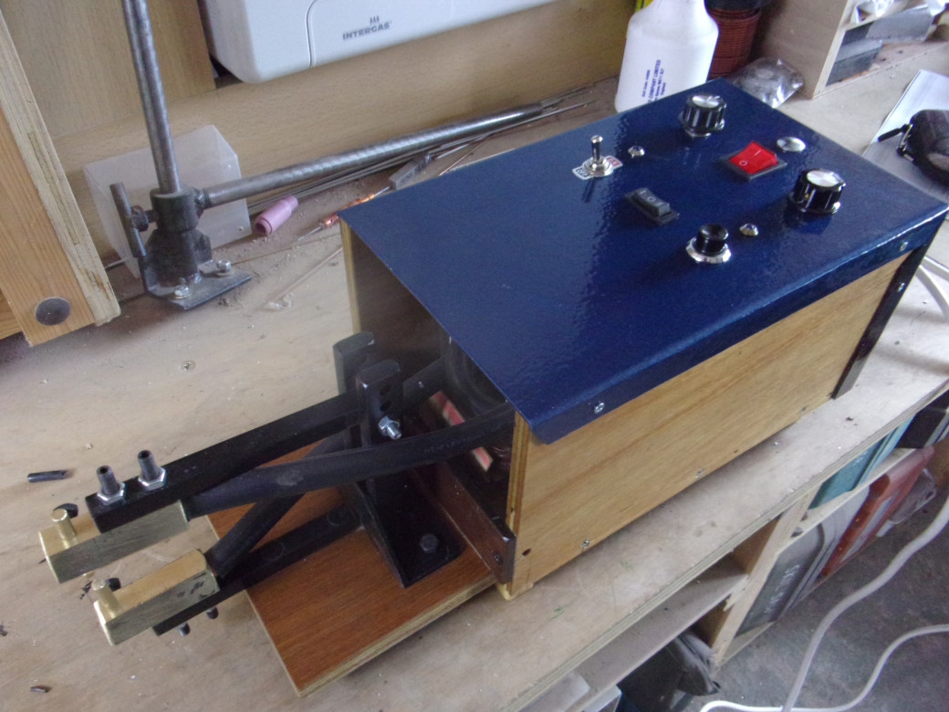

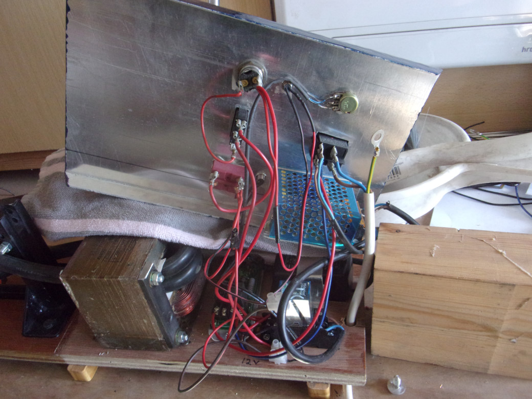

The brazing machine under construction.
Brazing machine completed with both manual and timer control.

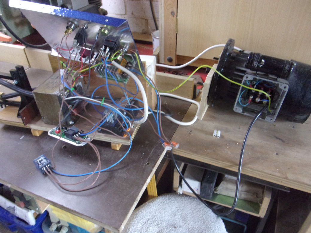

Using a motor as a test load.
It works but more experimenting needed it's melting the brass electrodes but I've ordered spot welding electrodes.

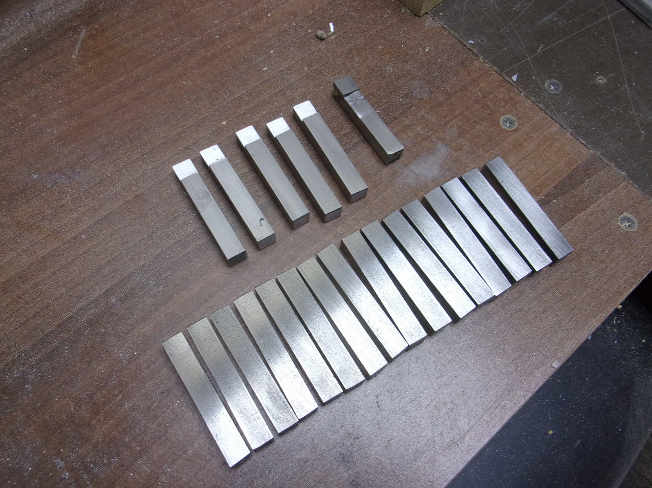

Blanks being prepared for receiving the TC tips; one completed.

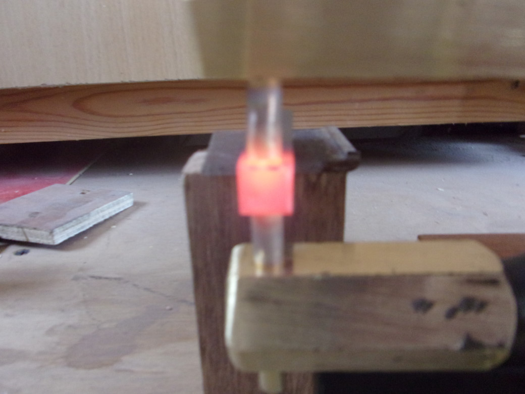

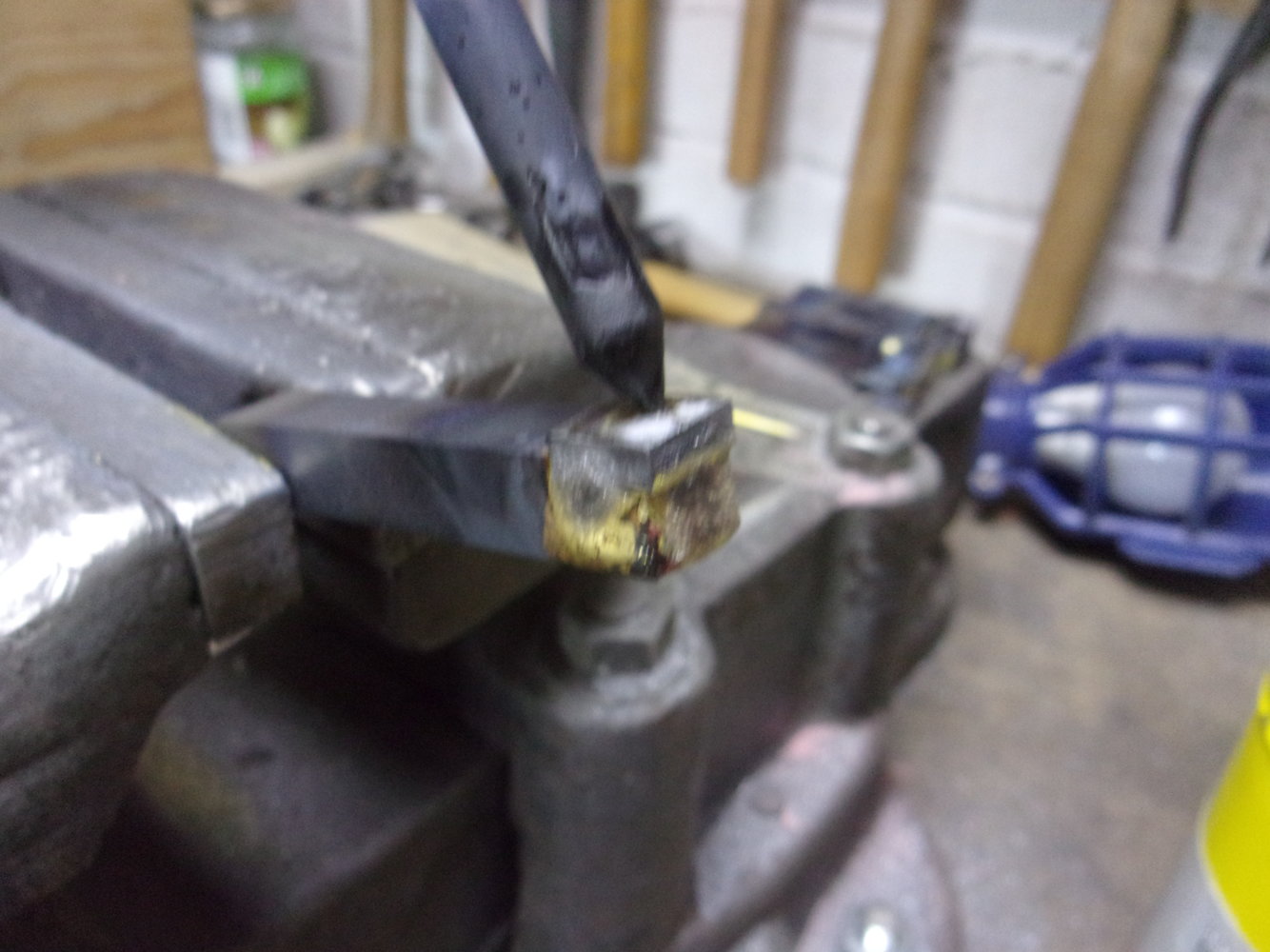

Here's a tip just brazed and the reason for my concern having been staring at the cherry red hot metal; a third hand is used to hold the tip in position. I've used blowlamps and cartridge torches many times but thought these were safe unlike welders?
