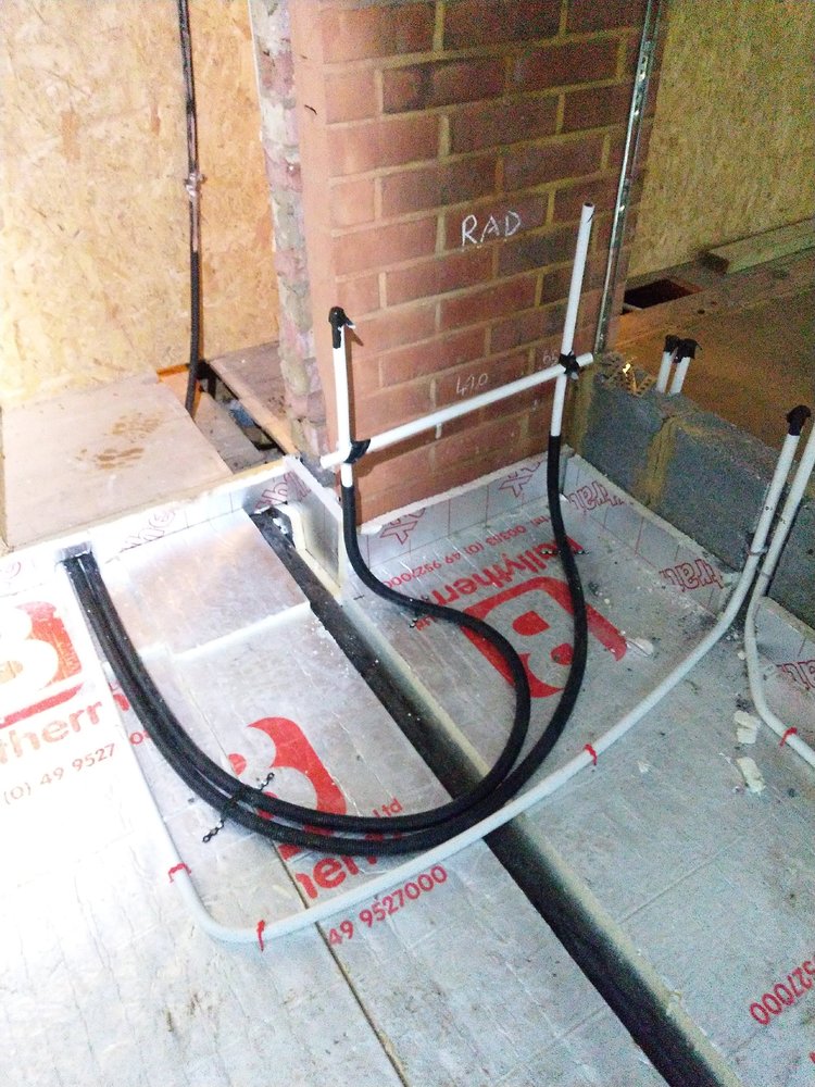

When I gutted the bathroom I put in a UFH loop on 16mm Pex-Al-Pex and a towel rad again fed by 16mm. As yet these aren't connected to anything.

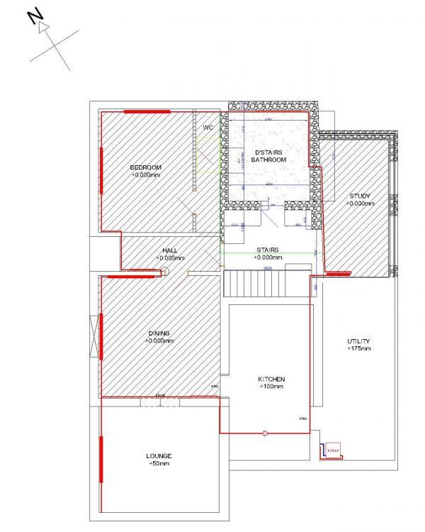

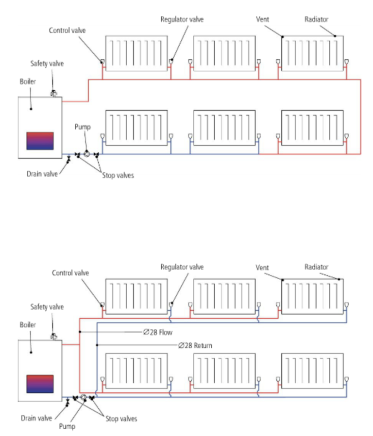

Downstairs the CH is an old single pipe system. 3/4" nominal bore copper like the first diagram. Upstairs are 4 rads on a flow return set up.
Each system is on its own 2 port valve with the returns commoned up. Same pump is used for both.
So roughly this:
When I gutted the bathroom I removed the perimeter, single pipe. That now crosses the stairs room roughly where the green line is, goes up the hall and reconnects to the single pipe run behind the WC.

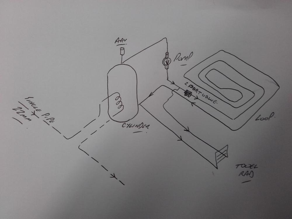

I'd like to feed my UFH loop off of the single pipe system. I can't connect it direct as the water temperature will be too hot. Best I can think of is fit a proper UFH manifold and involve a buffer tank. But how to blend? There's no separate flow & return.
Random sketch / thought for a separate buffer:
Running a new flow and return downstairs is a bit involved at the mo but might be the only way to go.
Any clever ideas?
