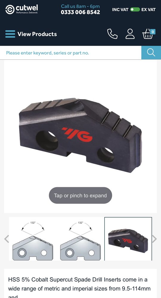

If you really want insert tooling get a spade drill but as a hobbyist do you really want to bother
