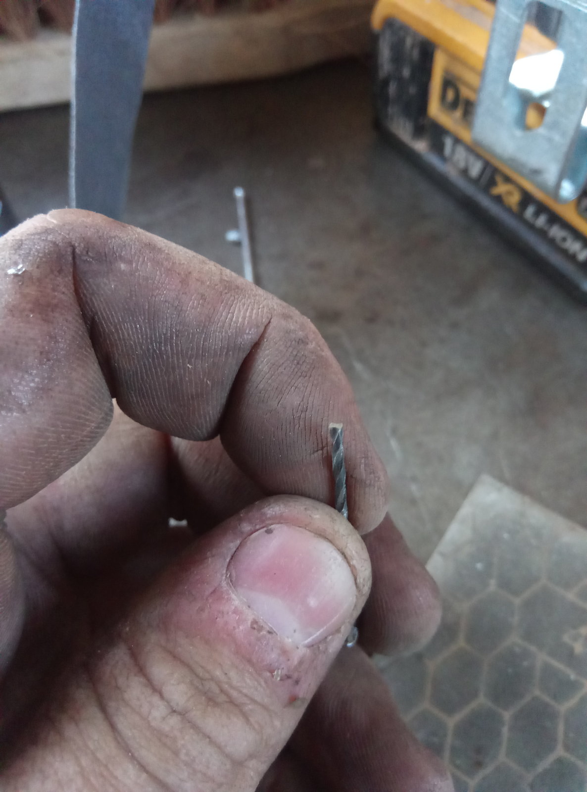

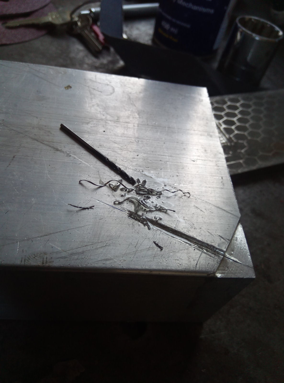

Yer,its getting that spot on that keeps reminding meA really basic and i mean basic rule to begin getting the drill to cut is the leading or cutting edge must be above the trailing edge and not visa versa...even a very rough grind or sharpen using this rule will allow the drill to cut and drill a hole.![]()
