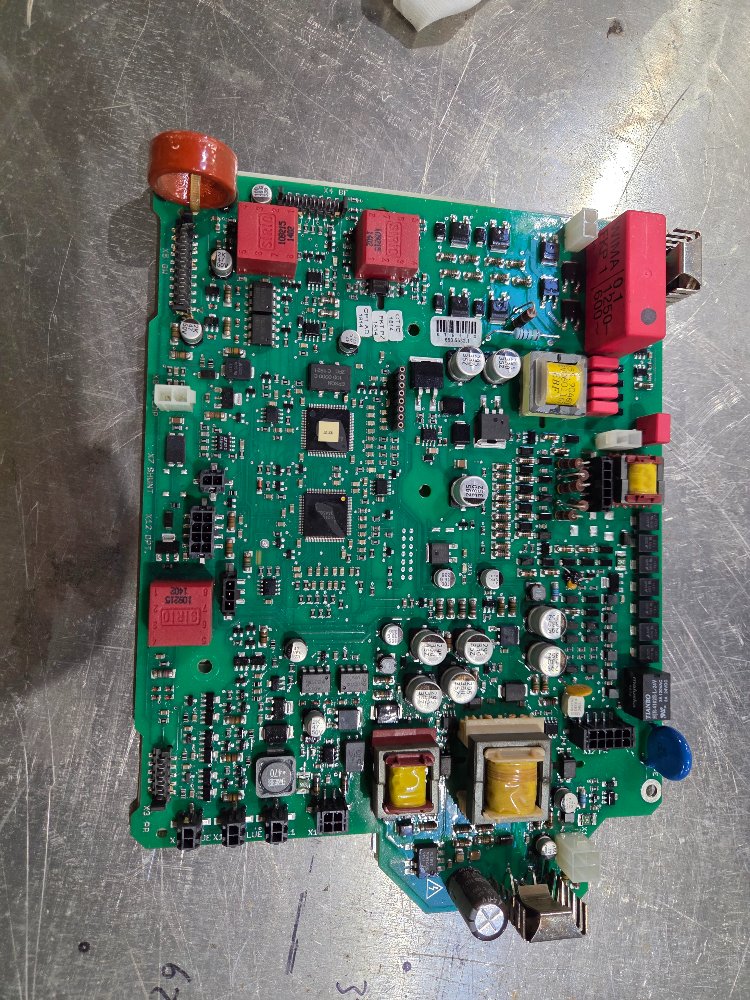

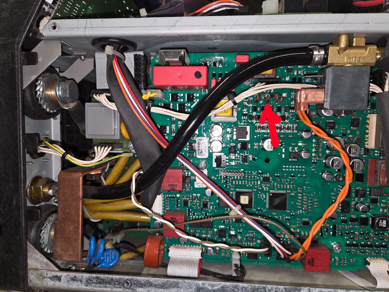

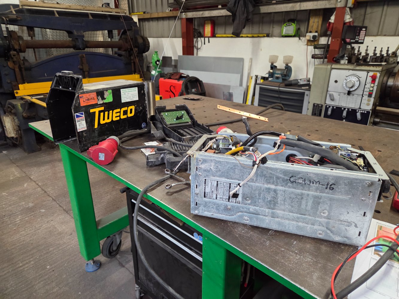

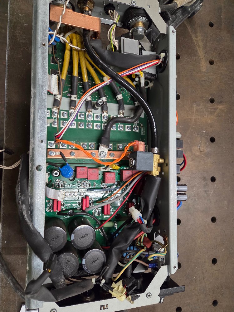

Machine bought with e25 error code with nothing plugged in.
Started stripping it down, nothing obviously wrong.
Checked T-MAPRO board for reference voltages.

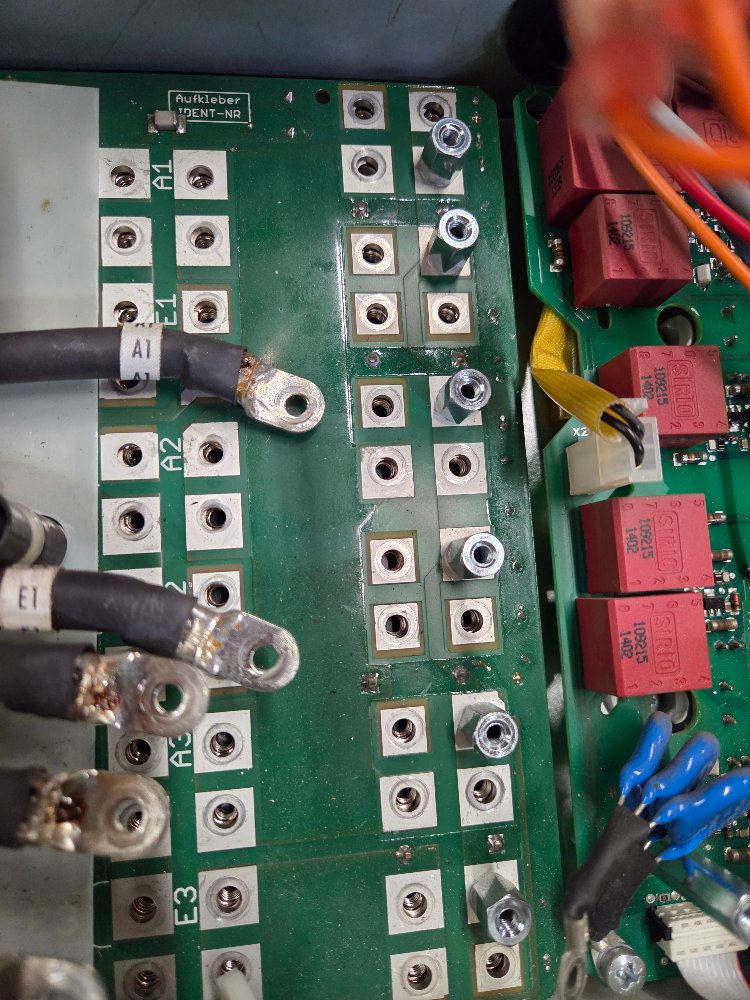

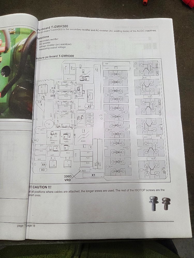

Nothing wrong, so board removed to reveal primary driver board T-PR300 and secondary rectifier board T-GWH300.

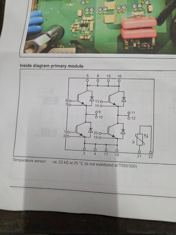

Primary IGBT modules on T-PR300 checked with multimeter according to service manual diagrams and the help of ChatGPT.
That left the mosfet, and secondary igbts and diodes on T-GWH300.
Removed cables and checked all diodes and igbts.

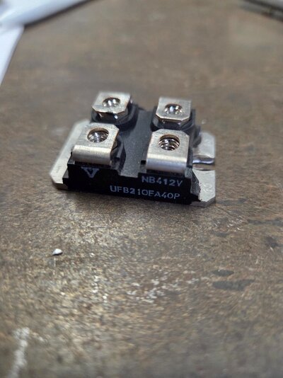

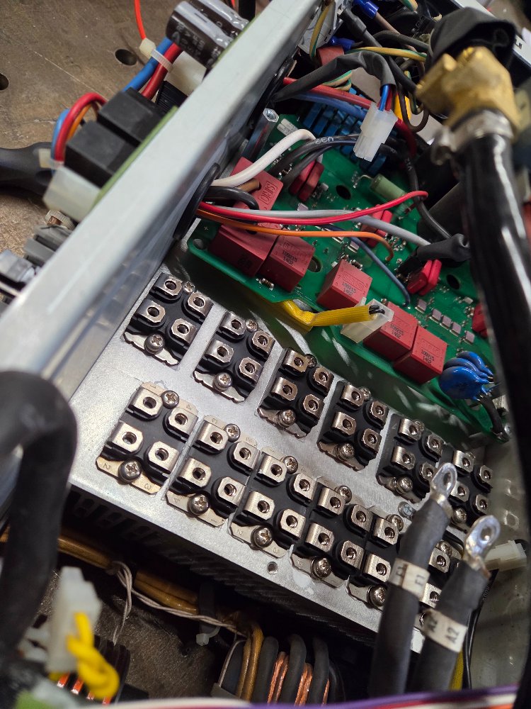

Hooray! Found an issue with one of the diode modules, so started to strip out the board.
Board removed to show the modules
Bad module
UFB210FA40P
Now, this is a discontinued product from Vishay, does anyone know where best to get one from in UK? Or the replacement part number which is UFB211FA40.
I'm not super hot with electronics, i only know enough to get by, so is there any likelihood that this part has damaged anything else? Like i said, I've checked all of the other diodes and igbts, all check ok.
Any assistance greatly appreciated
