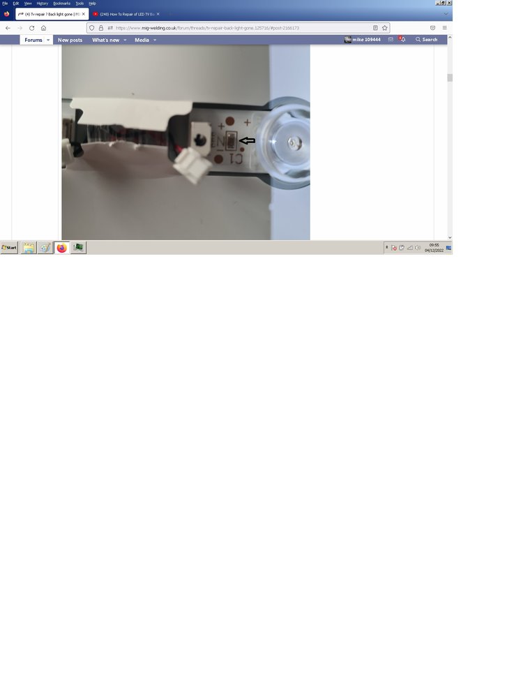

If all your led's check out ok after following the YT vid then the pcb should be suspected. Note there are outputs labeled LED+ and LED-. Even though it has 1 through to 5 it may not use all of them as the board may be used on other tv's that have more LED strips.
NOTE if you have already not worked it out that the "HOT" part of pcb means HIGH voltage !!! mains and above. So take care with bare hands near there or when placing board on anything.
