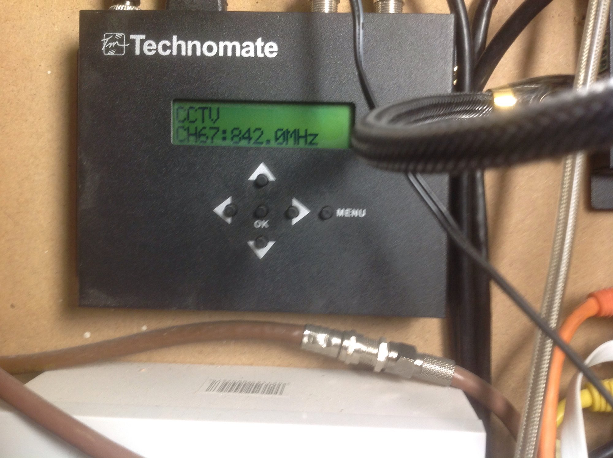

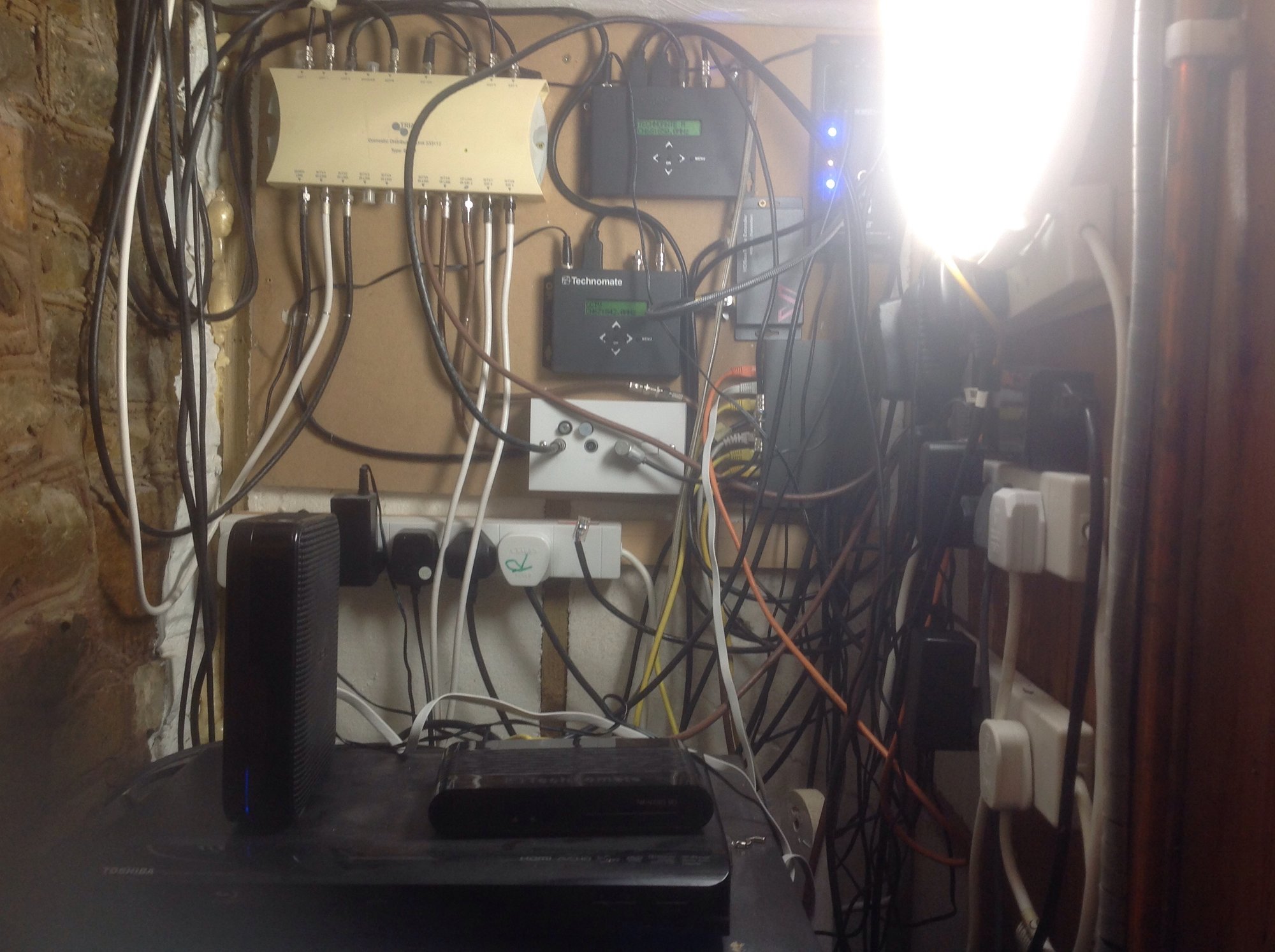

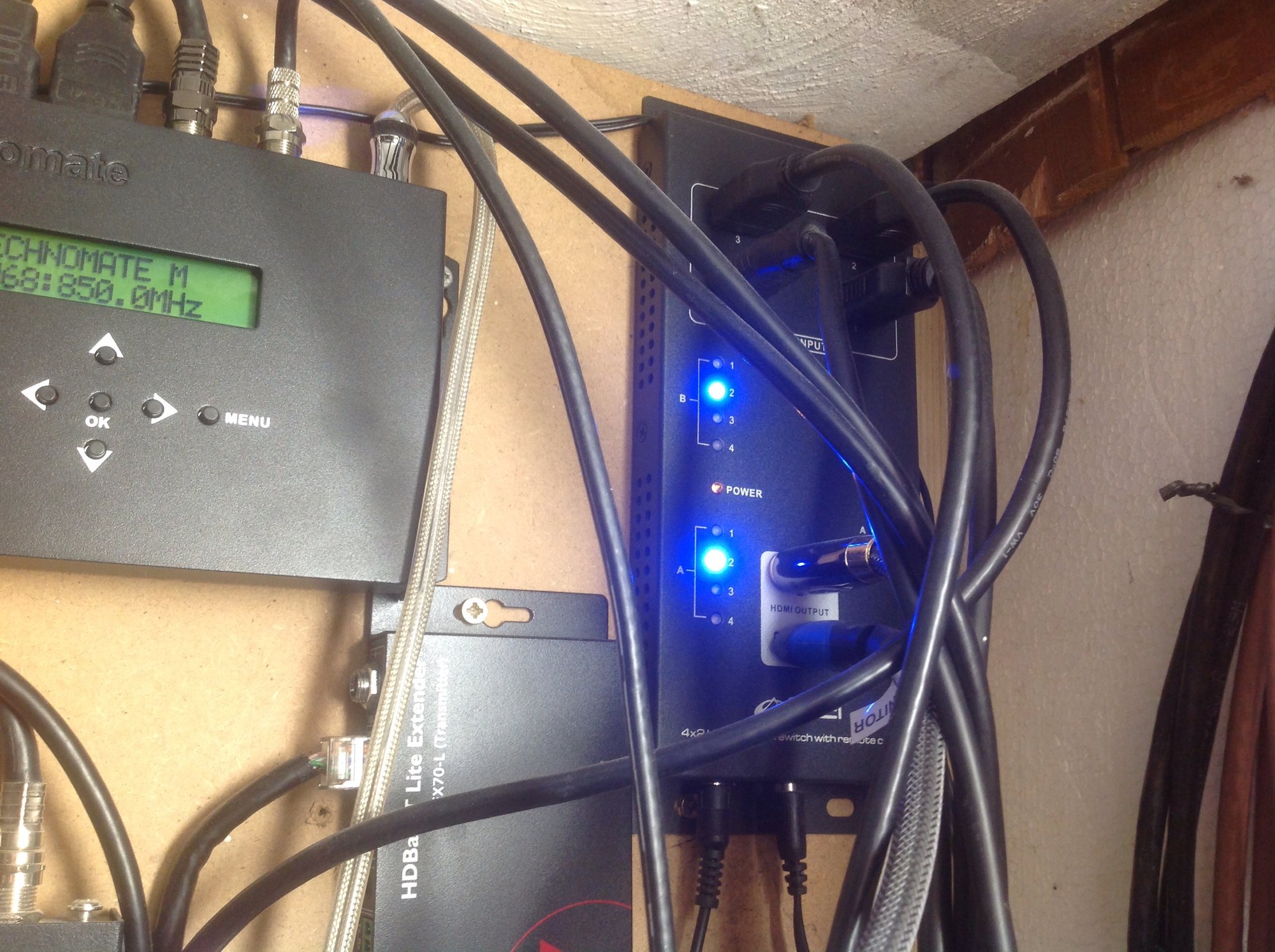

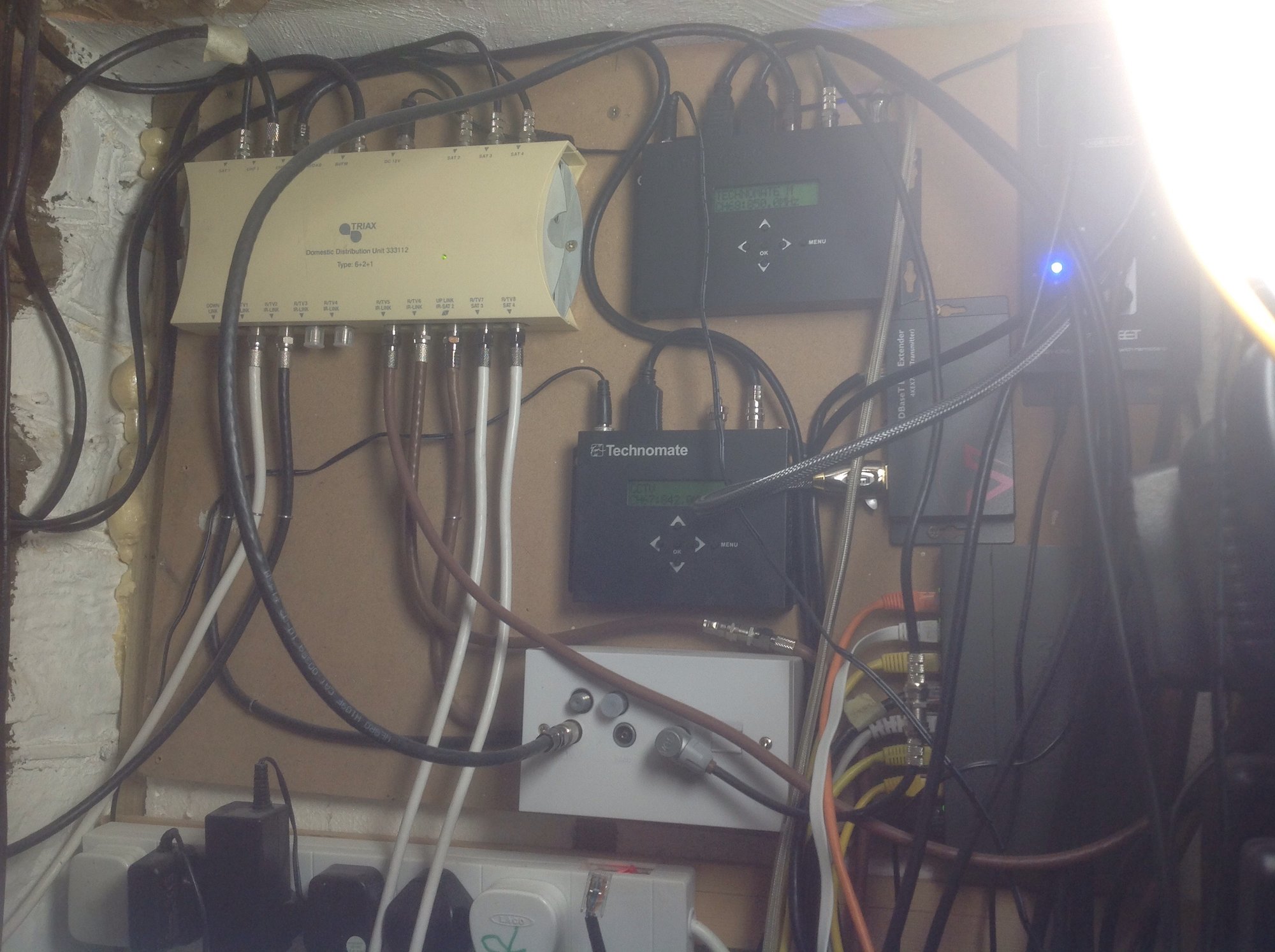

The HDMI Modulator allows you to turn an HDMI output into a Freeview HD signal that looks like any other to your TV. So if you for instance, plug a Blu-Ray play into the modulator and set a Logical Channel Number of 799 for example (needs to be a channel number not in the Freeview list), then if you scan the TV, channel 799 appears in the list and will be the Blu-Ray player.
