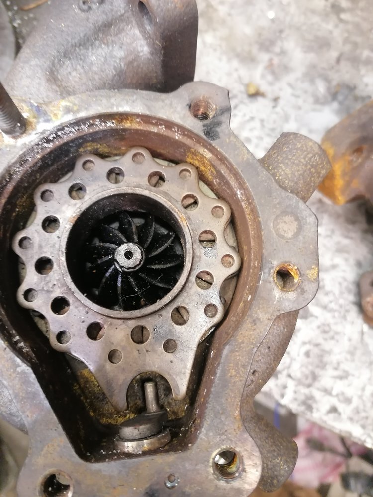

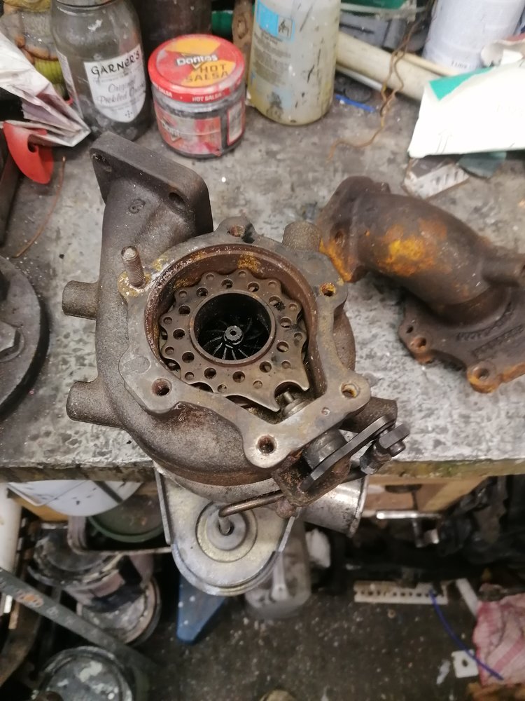

Hi people I need to refurb a Mitsi L200 turbo.
Is it a Diy job or better to send it off to a pro?
its a varible vein turbo I need to clan the vein pack too or get a new oneJust buy a new or refurbed cartridge (the main core), you could clean the housing yourself. Try find a Melett dealer and use a genuine Melett core
Terrano is a vnt one too, slightly more complex but not difficult to do, just don’t lose any bits!its a varible vein turbo I need to clan the vein pack too or get a new one
not a problem..oven cleaner and as long as they move freely and have not worn the spindles too much then good to go. Don't strip the vanes as they can be very fiddly going back if your a 1st timerits a varible vein turbo I need to clan the vein pack too or get a new one
...typical, stripped the VV and cant get it back together.thats why it was free! its back together but he lost the half moon shim that sits in the arm, of and the studs that hold the 2 halfs togehter!...typical, stripped the VV and cant get it back together.
nah ?I had a chinese turbo I sold it on they are proper pony!Plus the bush that links the two. You can get replacement nozzle rings, but looking at the price I bet for a little more you’d be able to get a whole turbo…
