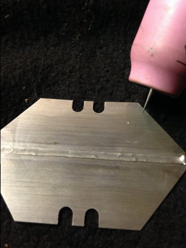

Are you using 1% or 1.5% Lanthanated? Not that I could probably tell the difference but if i'm gonna buy then may as well buy the bestI like to use 1mm lathanated on sheet metal panels but also quite often use 1.6mm if its already in the torch
