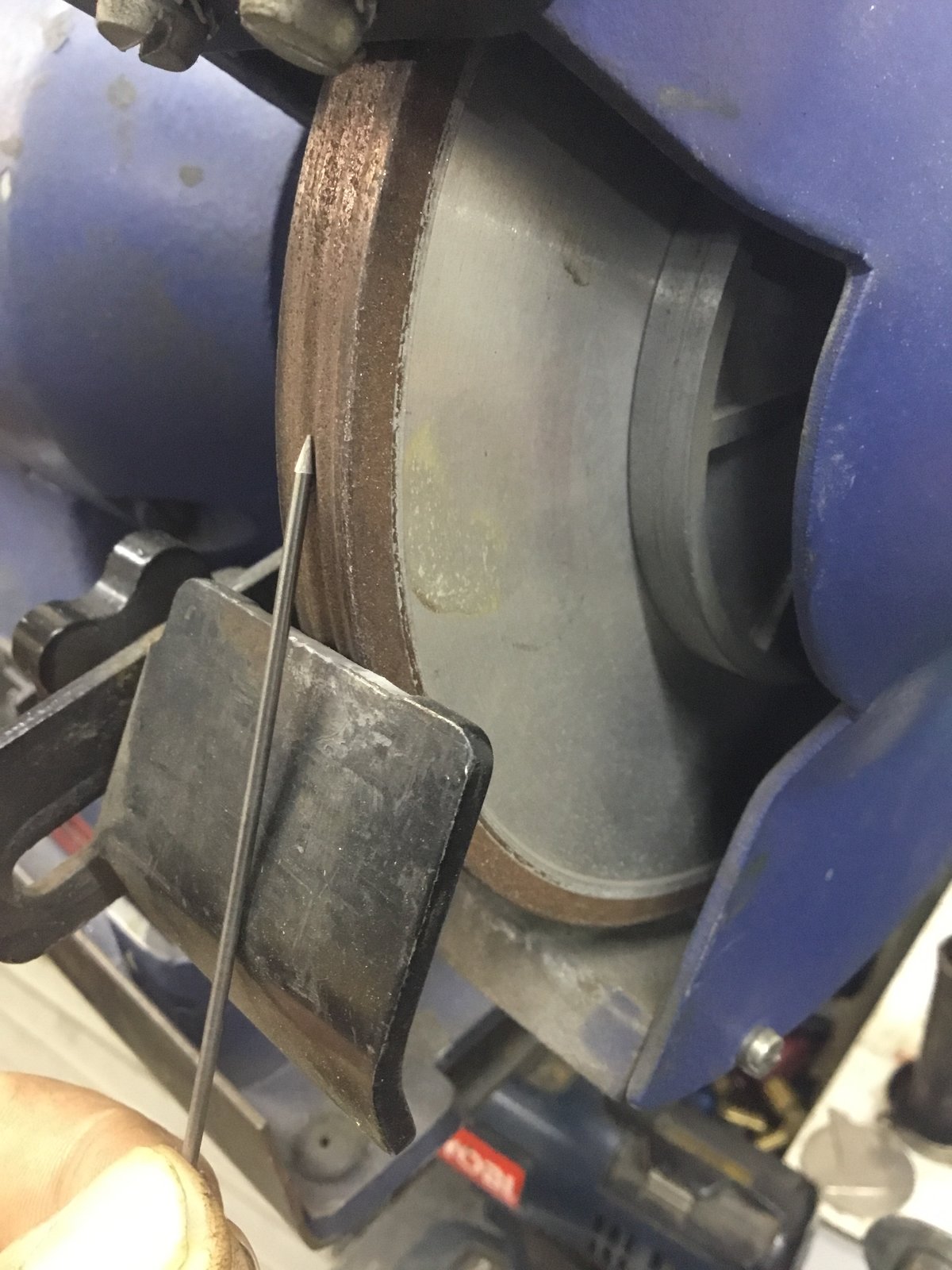

last night I took the little redundant Wolf grinder, added one cheap diamond cup wheel with a 20mm bush, and cut out the guard to suit...
Still have to extend the toolrest for tungstens on the side, but works pretty well as it is... and sure beats using the 4hp belt grinder for sharpening tungstens every time.
I might even make a fixed guide for 2.4mm tungstens at an angle.
