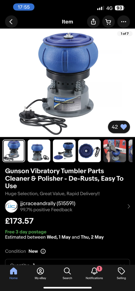

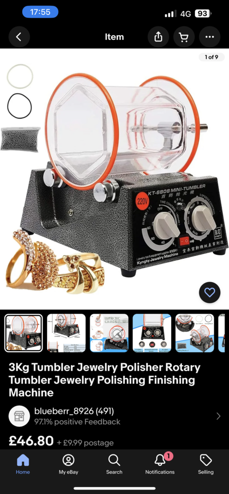

missed one at auction the other day, keep an eye out on bidspotterHey all, I’m wanting to buy a tumbler but i can only see the tiny jewellery style ones? Here’s a couple I’ve seen, the price varies massively. I did want one like the Gunson one. Any recommendations? Thanks
View attachment 447496 View attachment 447497
I missed the discount code so thanks, I ordered the gunson oneFrost sell the same size as Gunson but more money. The page is worth looking at just to see media choices:

Gunson one cheap here:
Gunson £118.36 on this listing (20% coupon code expires tomorrow):
