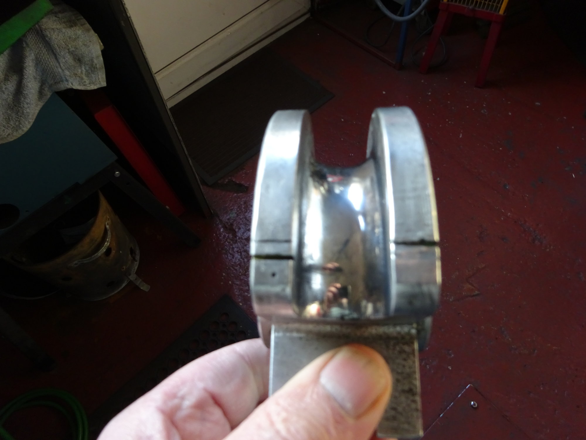

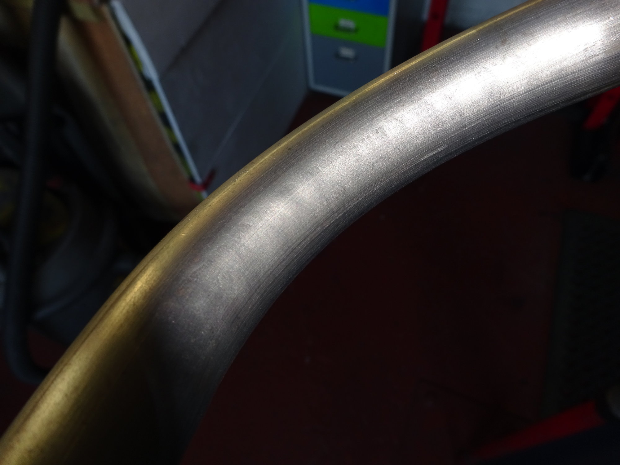

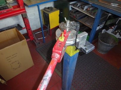

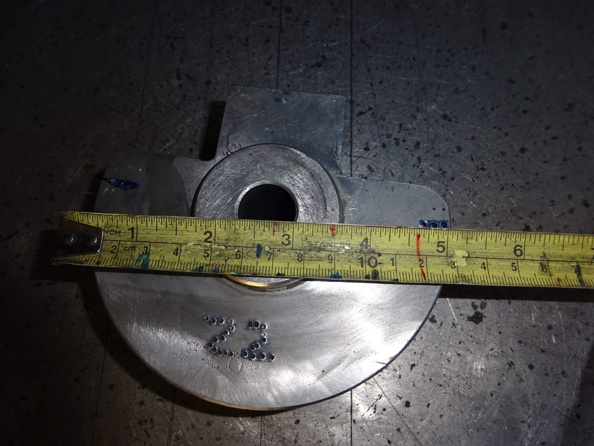

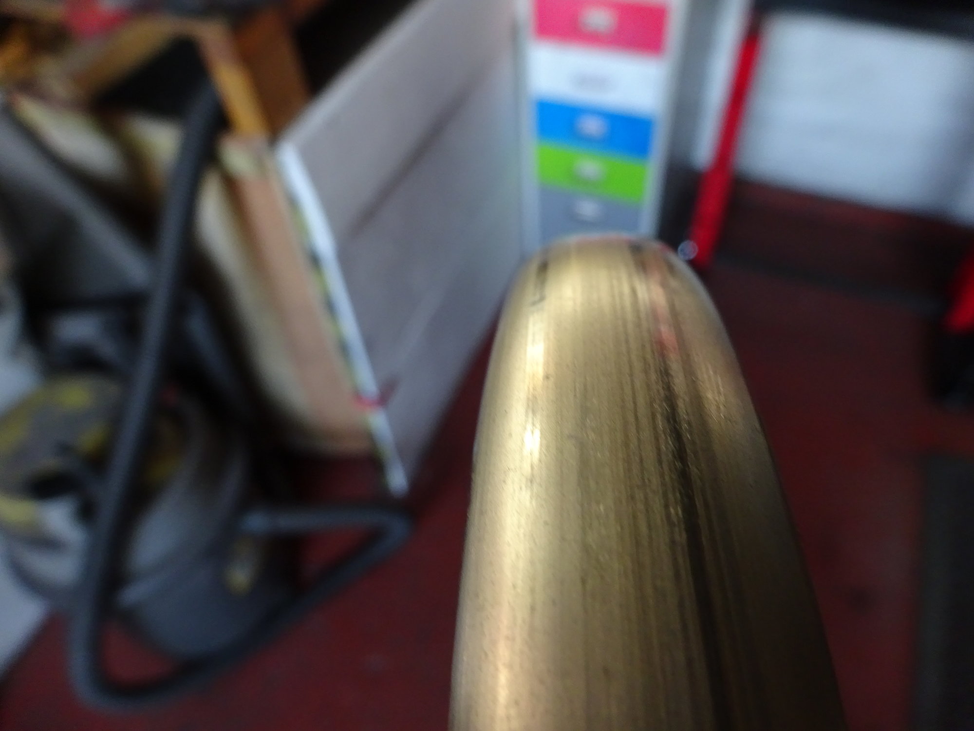

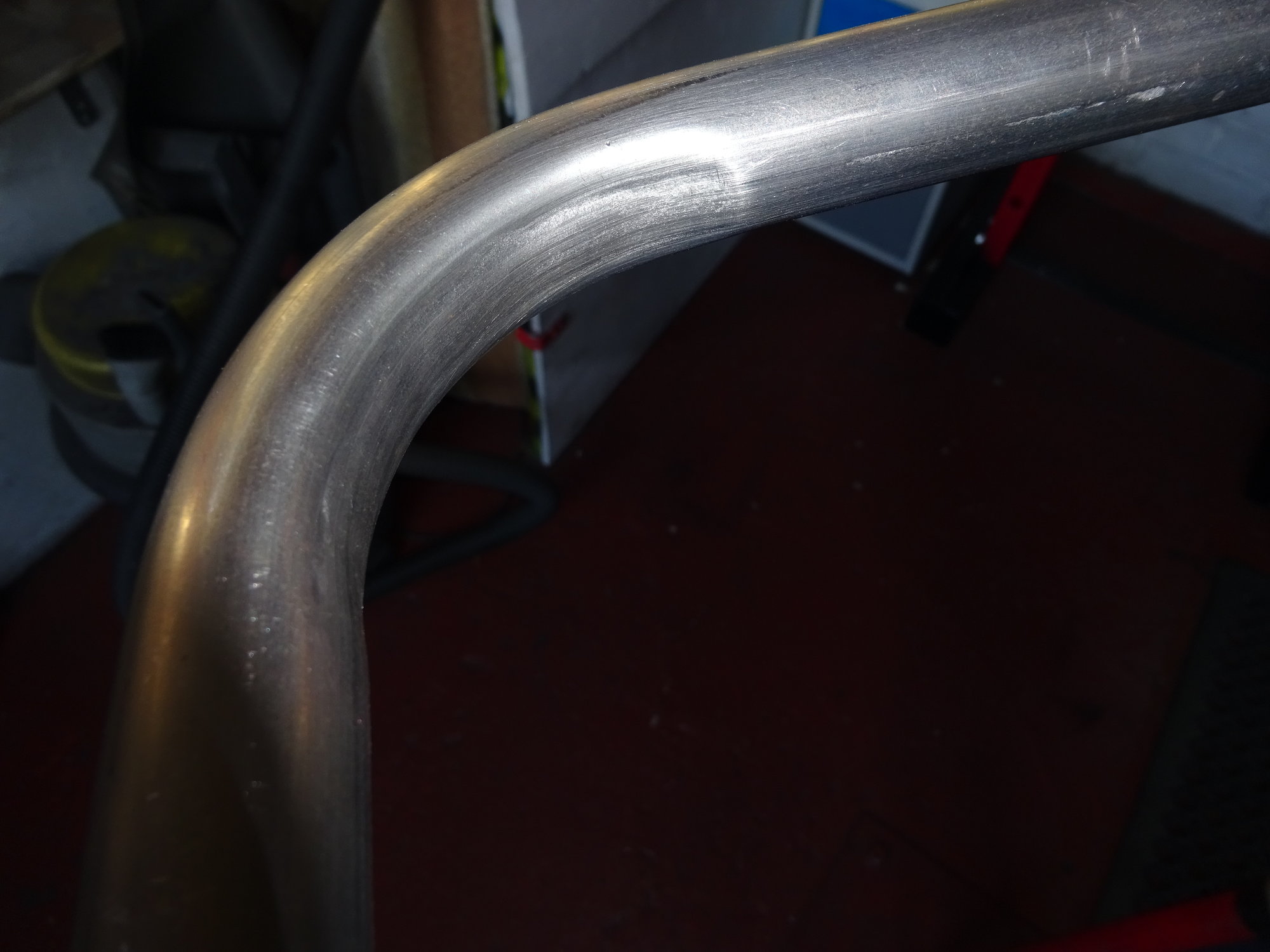

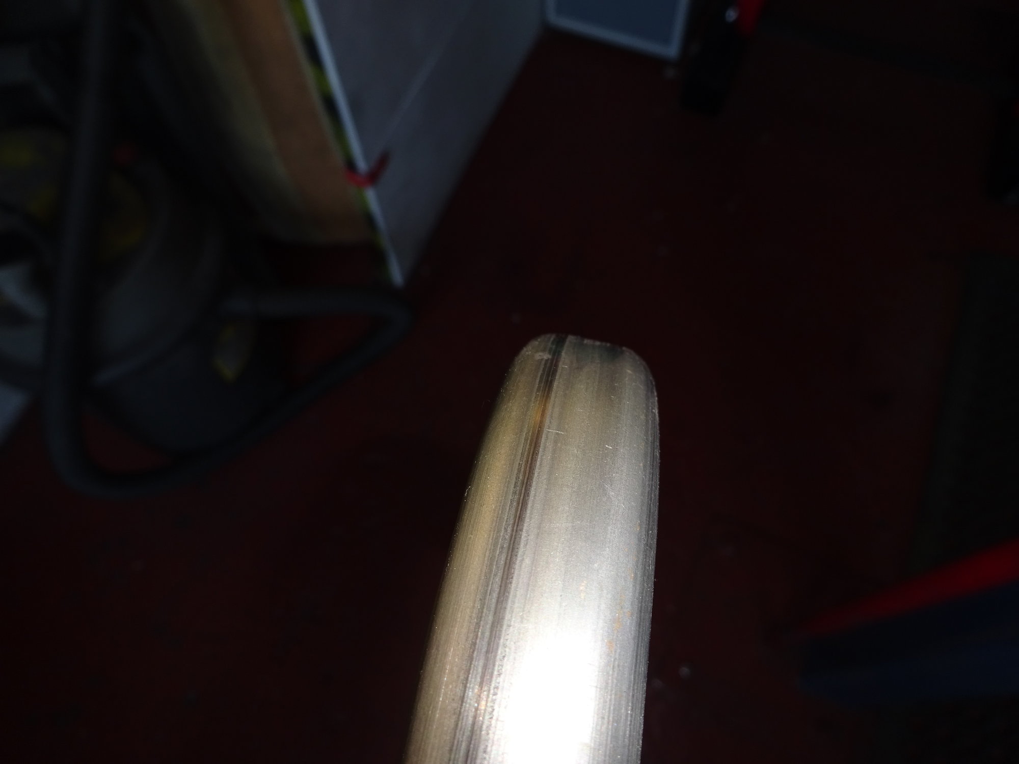

manage to make a former for bending 22mm ERW tubing.
I had a 20mm former and grinded that out etc and a linisher to get the curve.
its roughly 3".1/4 -3.5" radius on a 5" former.
it wont have it.
I think the radius is to small to get an even bend.
that's probably why Hilmor only do a 8" former or there about.
what do you experts think?
