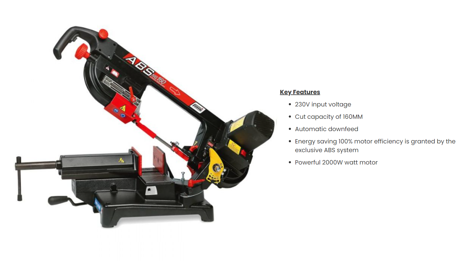

the bandsaw has a 2000 watt motor, its a noisey bast**** eh! Lord above there is some scream from the thing
When I moved in, I sparked up the grinder one night, and the next day i called to the neighbours (next bungalow along) and asked them did they hear it, they said 'no, thanks for asking'
They mentioned that a previous tennant had started a printing business in the garage, and that he used to zap their electricity, so i reckon its just a crummy line.

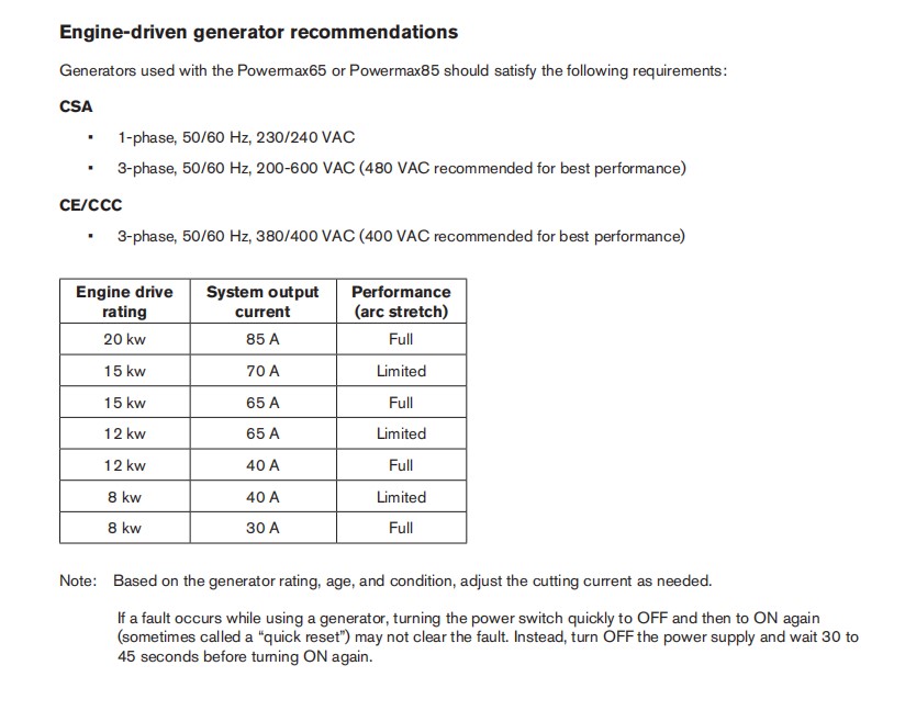

Hi Richiew, I checked just now, my kettle is 2000 / 3000 watts.
Scratching my head here.
I rand the neighbours just now, and said I've a couple more cuts to make tonight (building a table, need good cuts) and that after that I'll sort it, I'll buy a generator.
So I need a gennie capable of powering the saw, probably that will cover much other stuff.

As above, the starting current for the average mains syncronous motor is several times it's rated draw. My cut off saw draws 13 amps, but needs 45 to get going. A proper diesel genset usually has enough enertia to overcome the short heavy draw. The average petrol one, not. Keeping diesels quiet is not so easy. When off grid, we put up with the 'thud,thud' as part of the life. Our neighbours did too, as they shared it Yours might not...

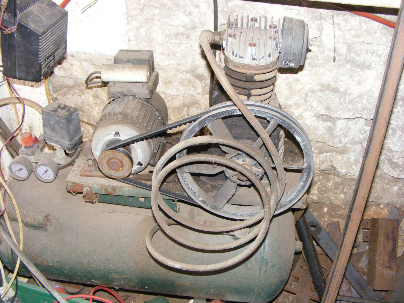

But, it does sound like your problems are not with the kit, other than a decent compressor like a belt drive twin. Mine is a bitsa like yours, but has no trouble keeping up with my 50 amp plasma. It only runs about 50% of the time. The direct drive 3000rpm are not only noisy, but less efficient in getting the air through.
I will take a pic of it. Maybe later tonight.
The two posts above came in before my slow typing got finished. The simplest short term would be a petrol compressor. Just keep it going and vent the spare air from a valve. But, likey you need your electrics sorted. Ours is pretty basic, but after switching things around, I don't have any trouble. The other half does, when loading the dryer, toaster oven and kettle on at once.... We keep torches handy in know spots that can be found by feel...
The twinpot compressor was left over from a golf course irrigation plant. Used to keep the air content up in a really big reservoir. Came with a 3PH motor, so swapped it for a Jetwash spare at around 2hp. The tank and switchgear were from a neighbour after the compressor cooked.
