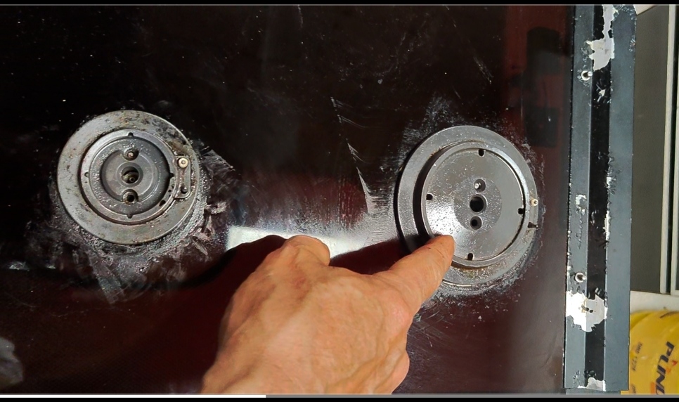

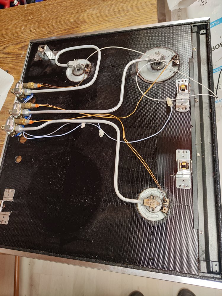

The chances of success are minimal. Due to corrosion, the sockets under the flame arrester with internal gas supply heads were jammed. They should be removed by hand, but they are not. The seals have crumbled, there are small gaps, but wedging does not produce results. I soak the parts with 40wd and DMSO - the result is zero. There is very little hope that the glass will not burst. If all 4 burners were gas, converting the stove to a stainless steel plate would make sense.
