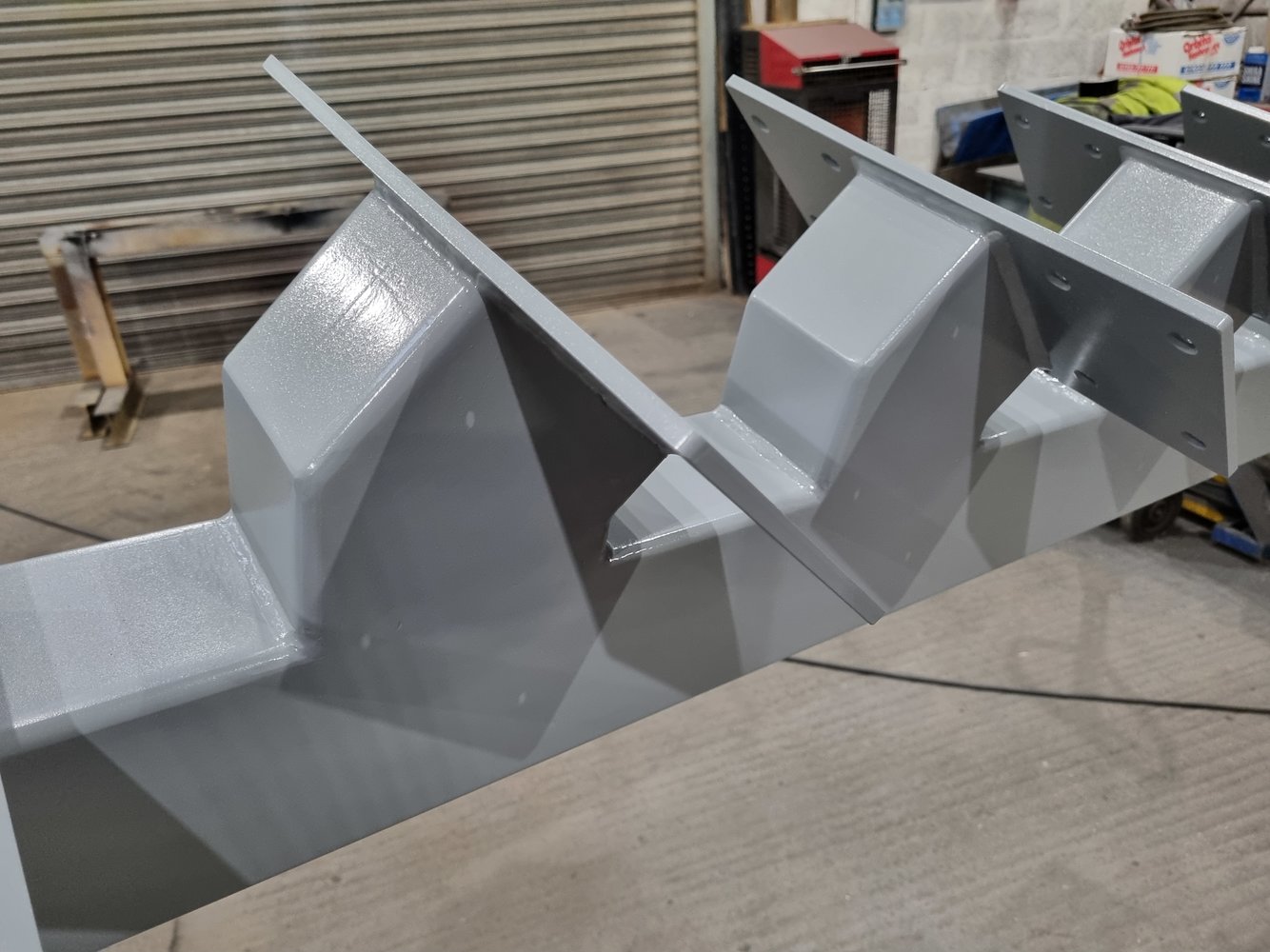

I could do with some advice...
I've sprayed a lot of different paints including 2k, but never epoxy primer. I've switched to it for faster and more reliable curing especially in the winter.
Using Hempel Hemadur 45143 as primer on metal. Through a HVLP gravity gun with a 2.0 fluid tip.
First shot - mixed up with a little thinners, maybe 2-3%. Quite stiff but didn't look overly thick. Anyway it barely sprayed at all and absolutely didn't atomize.
Remixed with another 3% thinners, it was better but still not atomizing properly. Used it anyway.
Mixed 2nd cup, this time with a good 12-15% thinners. This time it sprayed ok, but i could tell it was creating too much mist, like there was too much thinner.
Anyway, it seems that the paint is simply no good for gravity air spray. Is this true of all high build epoxy primers?
Would I be better off with a pressure pot spray gun with a standard nozzle?
Its a shame because if it would spray nicely, it looks like it'll be far better than the standard phosphate primers I usually use.

it was around 10 deg C which I would have thought was OK.
