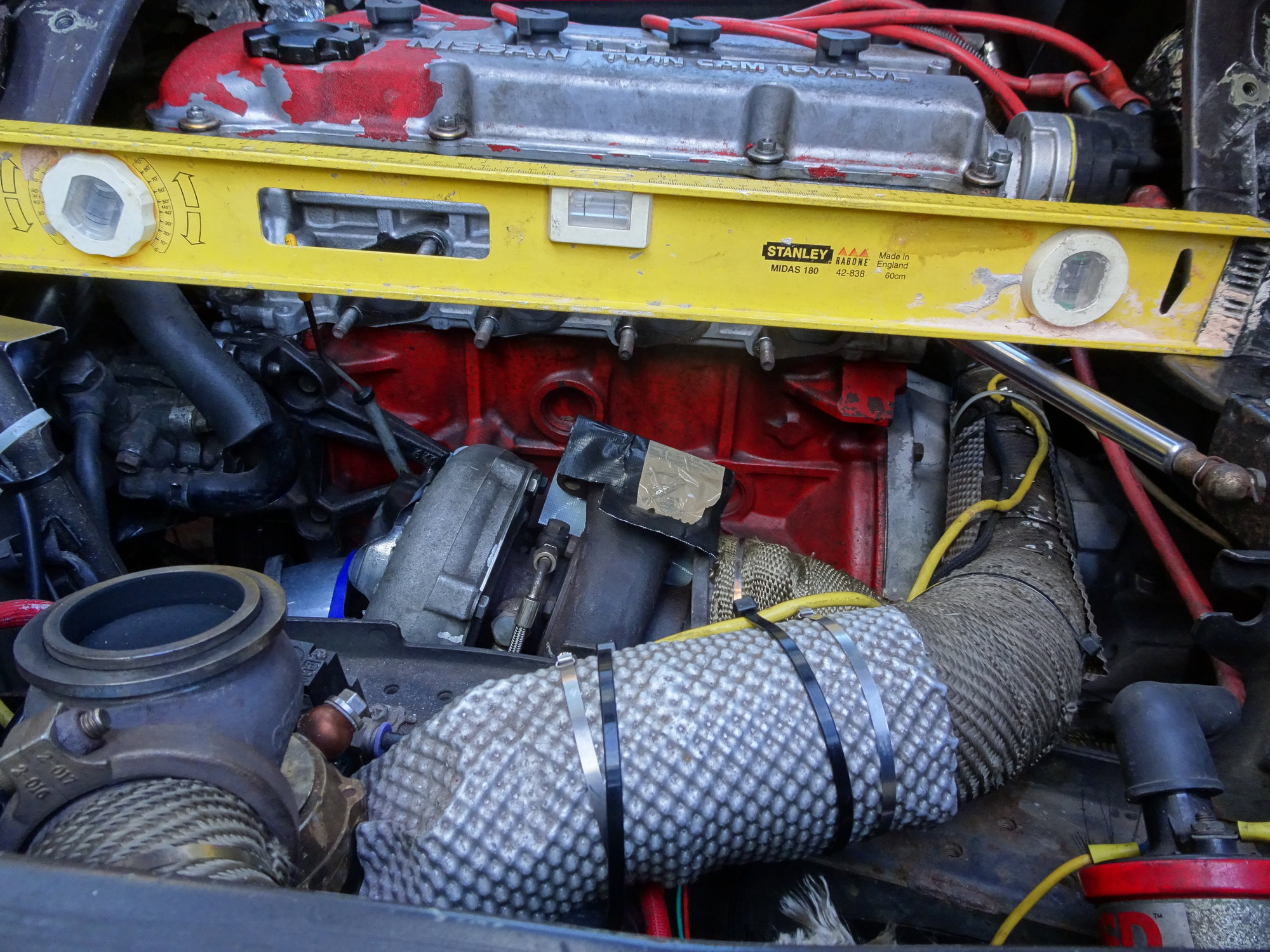

@. no offense at all. Guy who done it needs to sort it at his cost. The engines are not rare but the vehicle it is in certainly is. It is a true one off and I would not expect anyone else in the UK to even want to build a turbo people carrier. The parts to make one assuming it has been made from 2 tees and 3 elbows and a flange can be had for 145 dollars are pipes measured via internal diameter. TBF if it cannot be recovered then not sure I would go log style.but the dyno says it does work and I am at the limit on my current turbo and injectors but if at a later date I seek more power then obviously equal length would be the way to go. @bR39Da is that offer to make a new one or to recover this one? Template can be made from the gasket I tried to get a spare head before he done the job but couldn't source one so instructions were get creative so it is held during welding that didntt happen it was just welded without anything holding it at all :-( I wasnt at home when the guy done it otherwise would have stopped him.

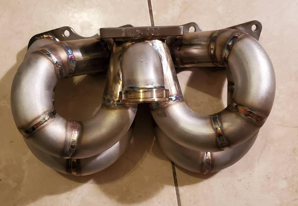

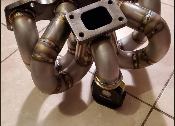

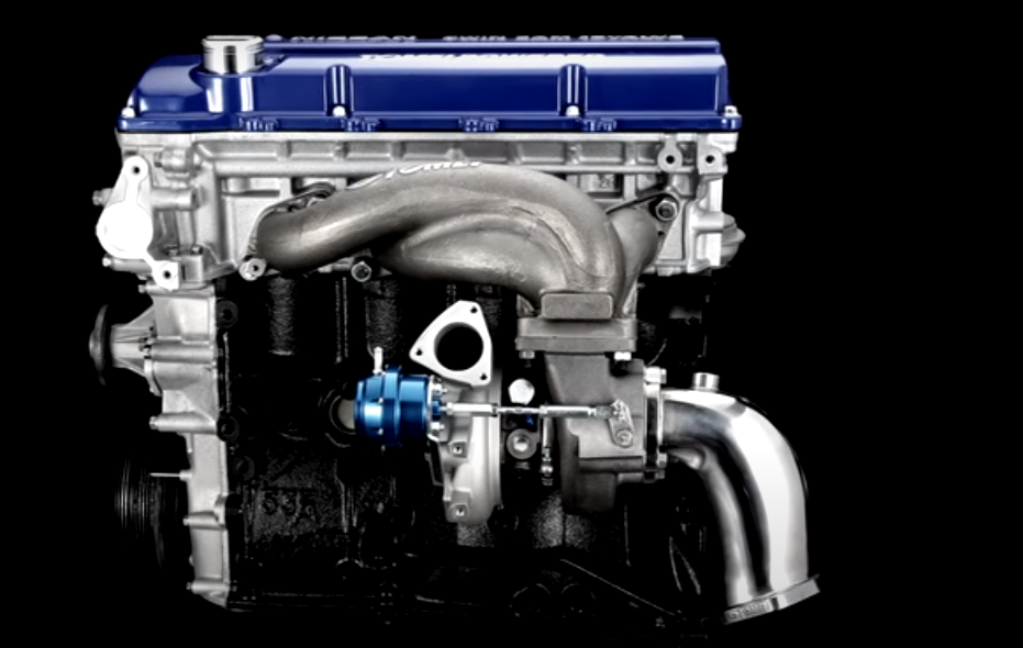

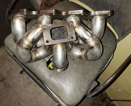

@WorkshopChris stupid move it would now appear :-) @tom2207 engine under the seats (all the commercial ones available are for the s13 or s14 chassis) will have to see what is available bottom mount (most are top mount) and if it will fit as not much runner space, I had already thought along those lines. Here is what looks like a nice top mount that a guy in the states makes for customers $875

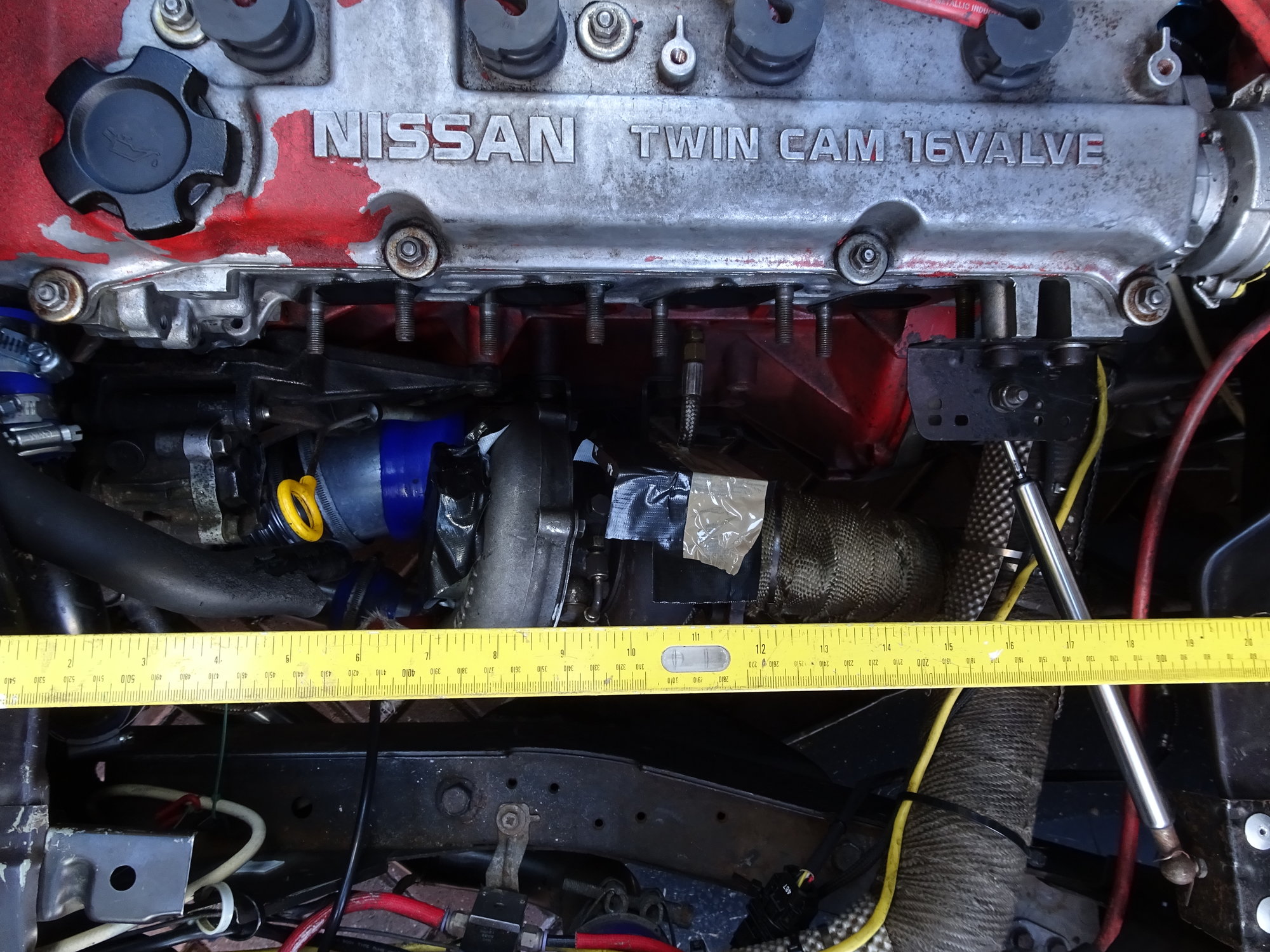

he made that from scratch, if I knew someone in the uk that could make one like that to fit in the space I have then that would be the answer for sure I have plenty of room underneath will get a picture and the downpipe could be modified as plenty of room there as well. Will post a picture or space I have shortly.
im sure some of the one off exhaust guys would be able to turn out one to suit ,, I can see how the price will be adding up though , although so far Im sure its not been cheap , on the other side of things as its not looked at under the hood , id not give up on what you have just yet ,,, granted its going to take a fix , and a bit of internal polishing ,, but its still all do able , even if its only as a stop gap till you do get a nicer job sorting out.
this might fit space wise but has the wrong flange. Plus i am external wastegate and screamer pipe. Think custom required but now car is disabled thats going to be a problem.

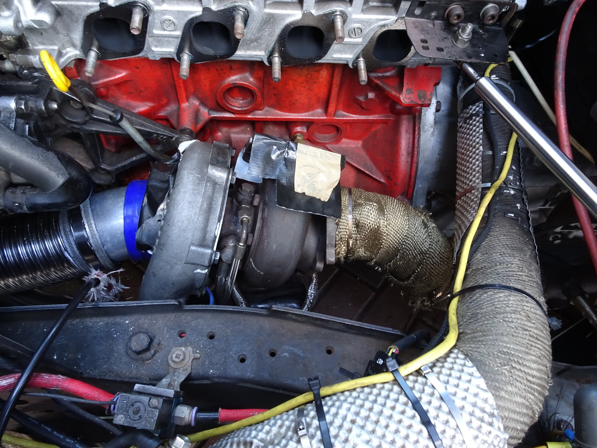

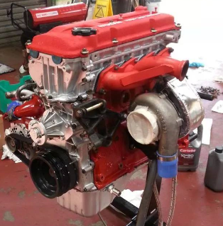

12 week wait for the guy above :-) Manifold has been took by the guy who messed it up including gasket for tempate making. Watch this space its not going to quick and dont think pretty either cant polish a turd and all that. Here is another picture of what we are dealing with in space if tubular manifold is the future. turbo can be moved downwards.
