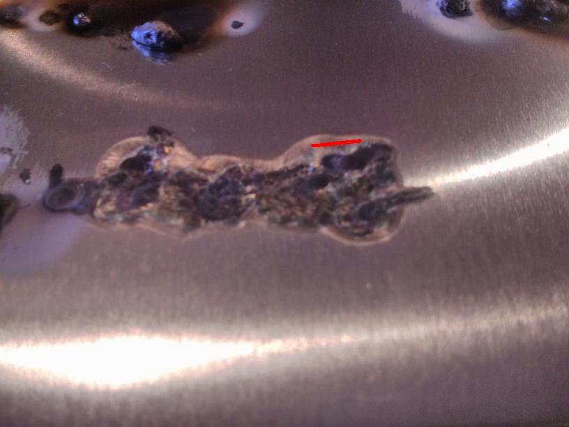

Hmmm I'll leave that to last, sounds something that's very last resort, it's a 200 AMP AC/DC IGBT Machine that doesn't have a lot of room between the gas pipe and electronics, I don't want to break it just yet. Gas next then I'll explore the soapy water option, cheers.
You need to change the gas you are using because straight Argon on stainless is a pig at best, will check tomorrow at work to see what we switched to after much swearing and spatter everywhere.

Yes but not the problems you're currently having, at least the two big ones...Is it possible a broken TIG machine will give me grief?
