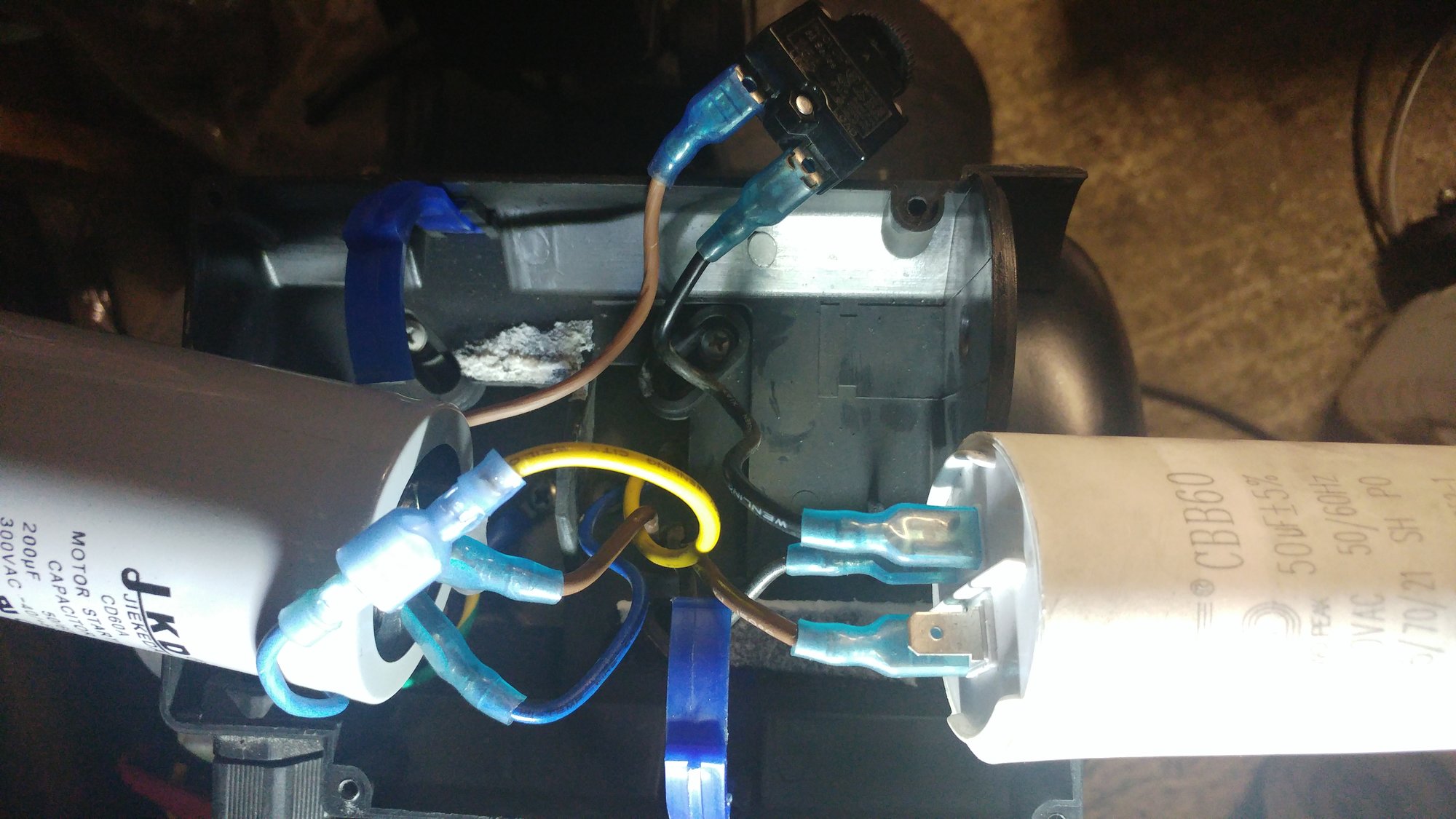

There will probably be two circuits for the motor windings, the run and start circuits, you should have continuity on both of those (fairly low ohms reading)
You should NOT have continuity from those windings to earth.
From your description of the breaker blowing instantly it could be a dead short to earth or live neutral.
