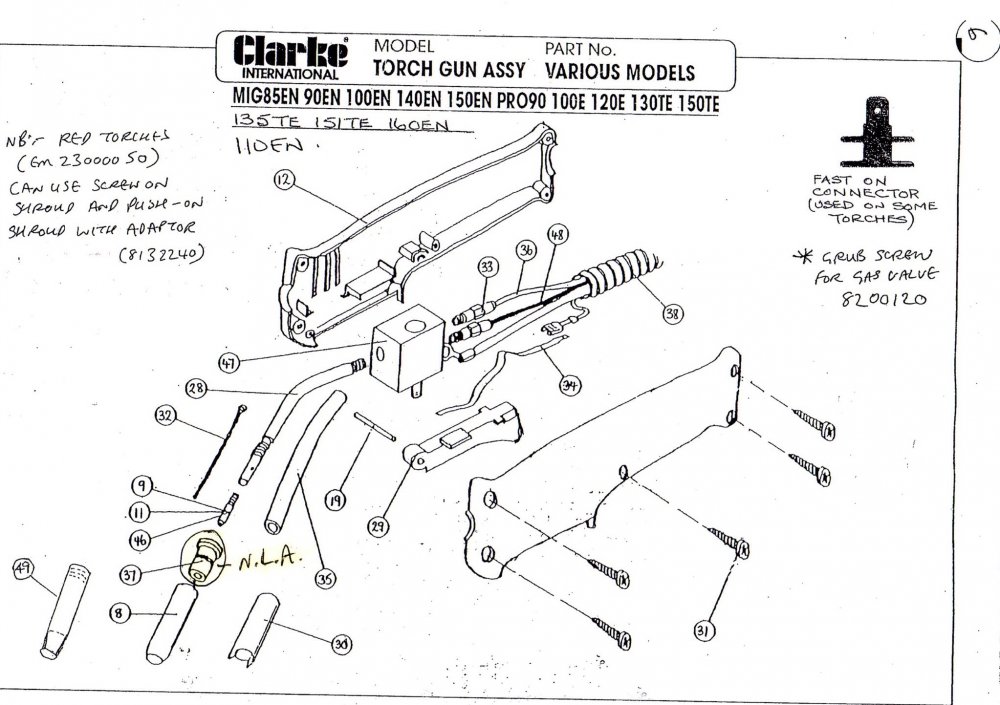

My Clarke 100e mk2 contact metal strip in the torch broke, it's the thin copper strip that goes to the trigger to make the contact, (what is that bit called ? ) it still working but it's letting out wire on its own at times or takes a sec to stop feeding, I'm after getting the part that broke, or an easy fix, I've looked at new torch and there £79
Any help please
