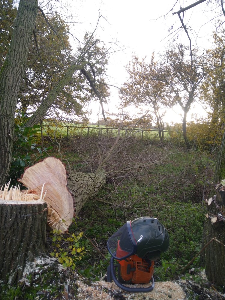

Today's naughty tree,
Willow that had cracked at the point it had grown from, its a fallen tree and the branch has grown up leaving a poorly anchored tree.
It's was a heavy back leaner leaning towards a house, winch was used to pull it, had to be careful as it would have happily pulled off the point that it attached.
Take the strain, face cut, relieve the sides. Final cut winch used to assist, too hard it will either barber chair or collapse of the attachment.
Here's the set up
fit perfectly in the hole, no damage to other trees.

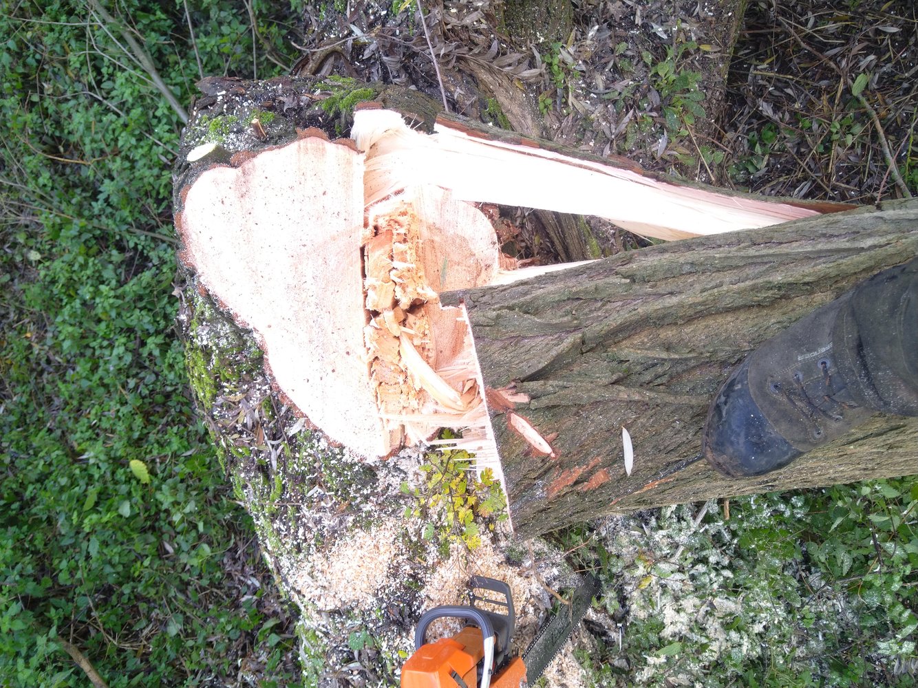

Nice enough hinge

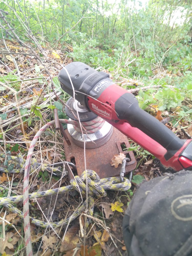

Here is the winch

Nice enough hinge
Here is the winch
